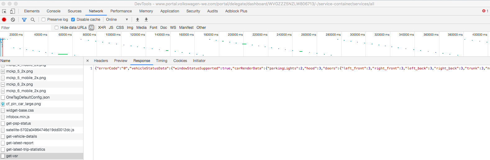

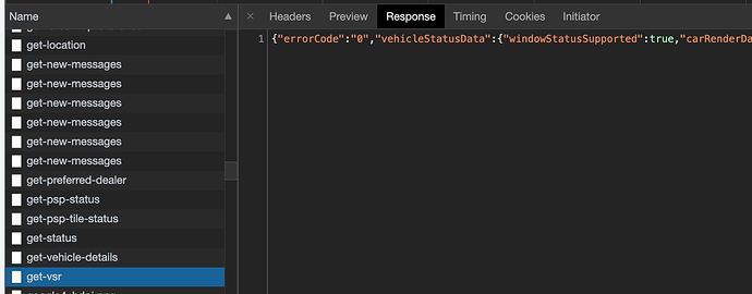

2020-02-04 20:36:25.862 [DEBUG] [econnect.internal.VWWeConnectSession] - {"errorCode":"0","vehicleStatusData":{"windowStatusSupported":true,"carRenderData":{"parkingLights":2,"hood":3,"doors":{"left_front":3,"right_front":3,"left_back":3,"right_back":3,"trunk":3,"number_of_doors":4},"windows":{"left_front":3,"right_front":3,"left_back":3,"right_back":3},"sunroof":0,"roof":0},"lockData":{"left_front":2,"right_front":2,"left_back":2,"right_back":2,"trunk":2},"headerData":null,"requestStatus":null,"lockDisabled":false,"unlockDisabled":false,"rluDisabled":true,"hideCngFuelLevel":false,"adBlueEnabled":true,"adBlueLevel":"> 2400","showAdBlueNotification":false,"rluMibDeactivated":false,"totalRange":400,"primaryEngineRange":400,"fuelRange":400,"cngRange":null,"batteryRange":null,"fuelLevel":56,"cngFuelLevel":null,"batteryLevel":null,"sliceRootPath":"https://images.portal.volkswagen-we.com/slices/tiguan_nf/tiguan_nf"}}
2020-02-04 20:36:25.866 [WARN ] [econnect.internal.VWWeConnectSession] - Exception caught java.lang.NumberFormatException: For input string: "> 2400" while parsing JSON response {"errorCode":"0","vehicleStatusData":{"windowStatusSupported":true,"carRenderData":{"parkingLights":2,"hood":3,"doors":{"left_front":3,"right_front":3,"left_back":3,"right_back":3,"trunk":3,"number_of_doors":4},"windows":{"left_front":3,"right_front":3,"left_back":3,"right_back":3},"sunroof":0,"roof":0},"lockData":{"left_front":2,"right_front":2,"left_back":2,"right_back":2,"trunk":2},"headerData":null,"requestStatus":null,"lockDisabled":false,"unlockDisabled":false,"rluDisabled":true,"hideCngFuelLevel":false,"adBlueEnabled":true,"adBlueLevel":"> 2400","showAdBlueNotification":false,"rluMibDeactivated":false,"totalRange":400,"primaryEngineRange":400,"fuelRange":400,"cngRange":null,"batteryRange":null,"fuelLevel":56,"cngFuelLevel":null,"batteryLevel":null,"sliceRootPath":"https://images.portal.volkswagen-we.com/slices/tiguan_nf/tiguan_nf"}} for request https://www.portal.volkswagen-we.com//portal/delegate/dashboard/WVGXXXXXXXXXXX719/-/vsr/get-vsr

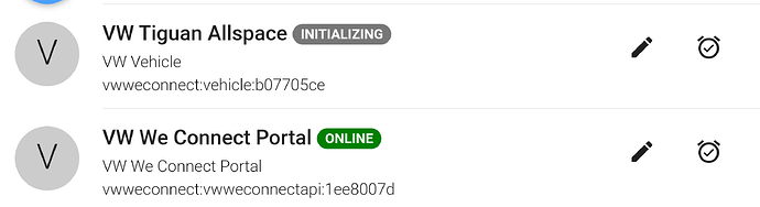

2020-02-04 20:36:26.993 [WARN ] [econnect.internal.VWWeConnectSession] - Failed to update vehicle details for VIN: WVGXXXXXXXXXXX719
2020-02-04 20:36:27.003 [WARN ] [nal.handler.VWWeConnectBridgeHandler] - Refresh success!

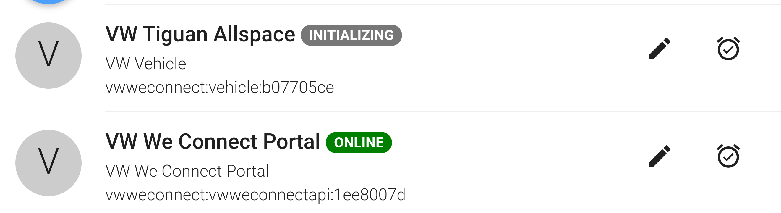

log after restart.
Bridge online
