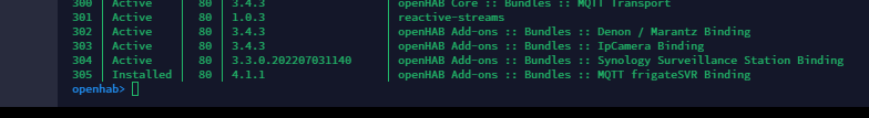

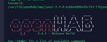

I’m having an issue, with 4.1.1 and the newly released .jar file running in docker. The bridge flaps between online and offline every few minutes:

My apologies if this was already answered, but does this binding require OpenHab 4+?
I installed the binding and am on OpenHab 3.4.3 and it does not go into Active mode.
So I’m wondering if the problem is my version
The binding is build against 4.1.1.
