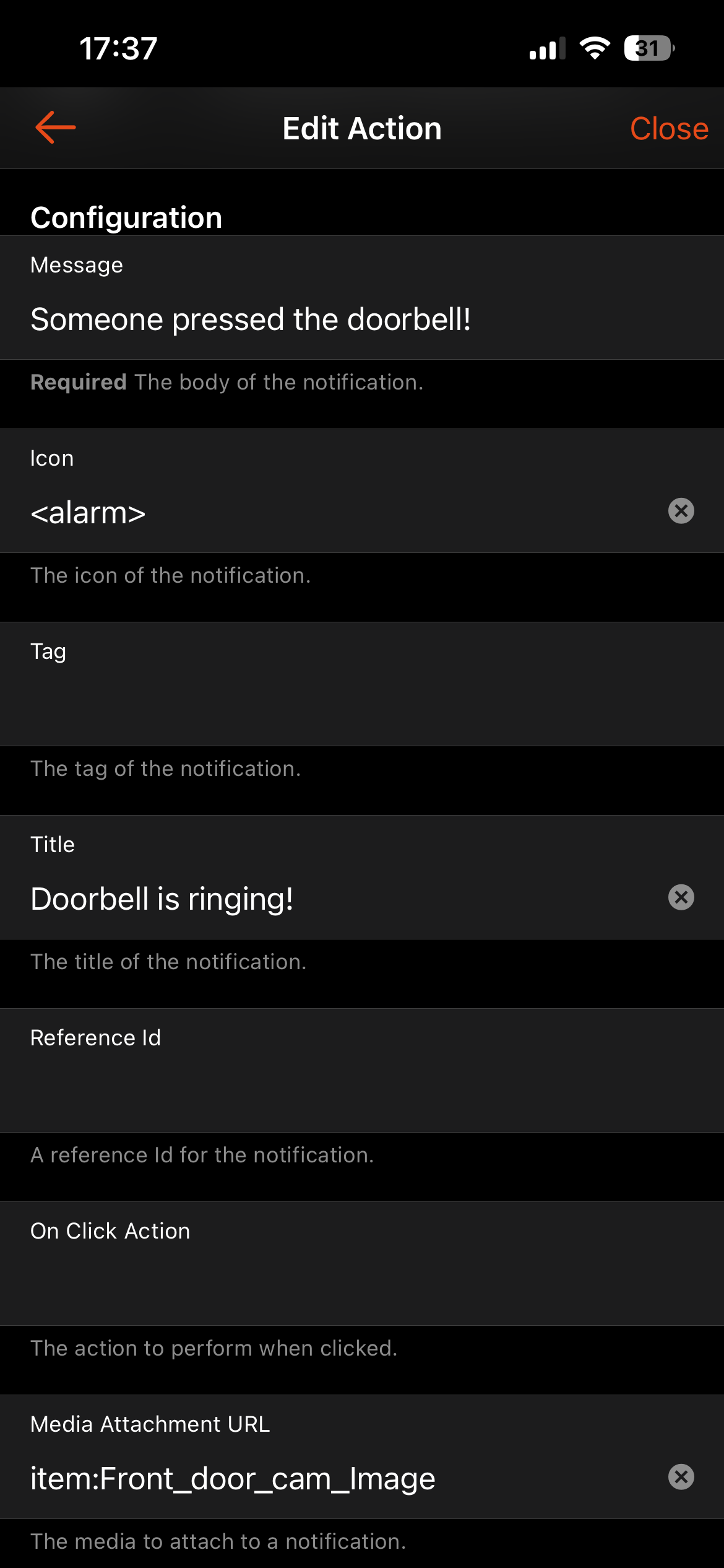

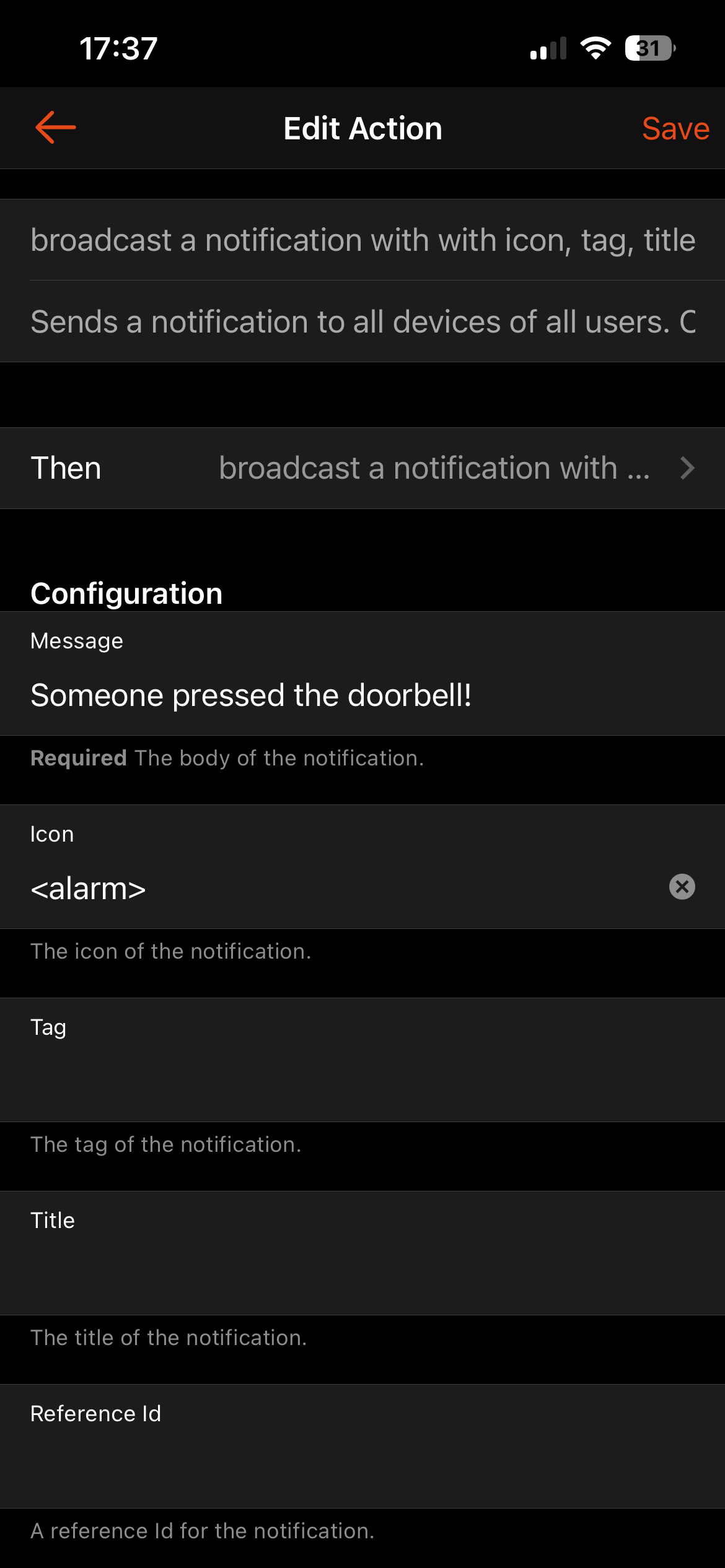

Does anyone have an example for „in case of alarm, send a picture of the incident along with the notification to the app“?
@Cplant you can make this very simple or very complicated, and like I said previously you can build this with the basic OpenHAB rule engine:
When alarm item changes from off to on;
Broadcast notification with the title, text and media url carrying either the item:nameOfItemWithCameraSnapshop or the local url to the snapshot. Only snag is that this isn’t working right now so maybe use the telegram binding for now?
With a TTS service (I use piper) you can even tell Google to warn you. Pretty cool.

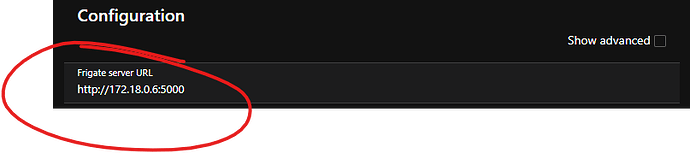

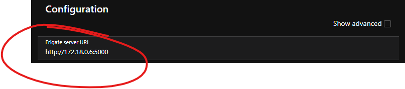

Quick question: I got the binding working this morning, but now (some hours later) I can’t get the Server-Thing online:
This is what the camera-Thing says:
The logs appear as if the connection can’t be established (“refused”?)
2025-09-28 21:33:41.705 [INFO ] [nal.handlers.frigateSVRServerHandler] - - Frigate server is offline
2025-09-28 21:33:41.706 [ERROR] [nternal.helpers.frigateSVRHTTPHelper] - ExecutionException: java.net.ConnectException: Connection refused
2025-09-28 21:33:41.706 [WARN ] [nal.handlers.frigateSVRServerHandler] - unable to get version string
Does anyone have an idea? The MQTT-broker is online (I’m using it for other purposes as well). The only thing I really changed was opening port 1984 in the frigate yaml-docker configuration, and playing around with the detector model a bit, but that can’t be it?
Update: I found the root cause. When restarting the frigate container, its IP address changes (used to be 172.18.0.2 before the container reboot, now its 172.18.0.6).
Does anyone know how to a) fix the IP address or b) define an “alias” of some sort that cann be defined in openHAB that does not change?
In the docker compose, specify a static ip…? That’s a docker question though
Or just point at your host ip:5000 and it should work if it’s in host network.
