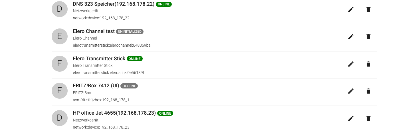

Yes, when suddenly the shutters were not moving anymore (after openhabcloud setup) I thought I delete the binding + the items and install it from the beginning. That was the moment where the chanells 1-15 were not listed anymore in Paper UI.
I just received completely new channel IDs. Nothing logic which corresponds to the number of the shutter on the stick.
In the screenshot you can see that the stick is online, but the test channel I created is not working and stays on unitialized.
??? :slight_smile:
Unless you updated to the last version from yesterday, the only way to get a working channel is through discovery. If you have created the channel yourself with an older version, you could not specify the channel id for the channel and it is never going to work.
Hi Volker,
that was the missing part. :slight_smile:
I didn´t know that manual bindings do not work (or at least channels cannot be defined manually). When I changed Paper UI to simple mode, the channels were shown and the binding worked again.
Many thanks!!!
