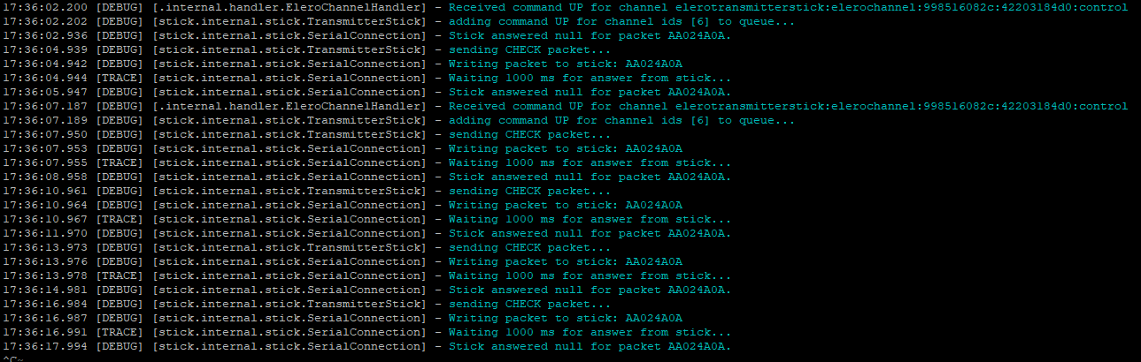

Thanks for your hint. I have taken a close look at the logging. The stick is initialized correctly. However, I get no response from the stick for AA024A0A. Although I have programmed the shutter on the sixth channel. With the buttons on the stick I can control the shutter. The channel I have also manually recorded in openhab.
Is your stick working correctly now? Have you programmed the shutter again on the stick?

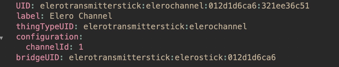

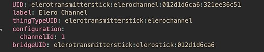

Bridge (i.e. Stick itself) config
Channel config

Thanks again for the help. I have now found the problem. The USB stick was always plugged into a USB 3.0. The stick only works on a normal USB. Now everything works and I can continue with the HABPanel.
