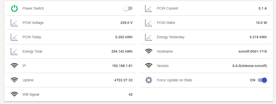

Thats a screenshot from the PaperUI:
The PowerSwitch is always like this - it never gets updated. As a matter of fact the actual state is “Power”:“1”.
i can confirm this because my powered device gets power and additionally i can check this on the console of the tasmota device:
