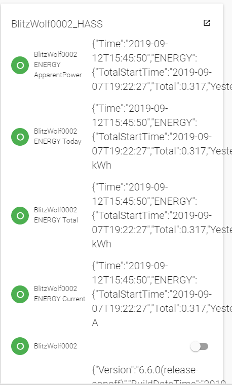

Hey there!

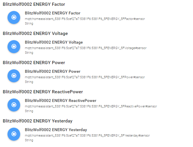

I am currently migrating my items to the new mqtt binding. I wanted to add my tasmota V6.6 (sonoff.bin; SetOption19 1) with the Homeassistant Discovery Support. I am able to add them through paper ui.
But it looks like this:
With the mqtt v1 binding i was using JSONPATH to transform the output accordingly.
Shouldn´t this already be done automagically? How can i achieve this with the actual binding?
Thanks in advance, please keep up the great work!
best wishes
Walter

There truly seems to be something.. Maybe it has sth, to do with JINJA?

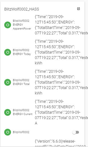

2019-09-12 20:07:33.373 [vent.ItemStateChangedEvent] - mqtt_homeassistant_5381F6_5cef27a7_5381F6_5381F6_5FENERGY_5FFactor_sensor changed from {“Time”:“2019-09-12T19:02:32”,“ENERGY”:{“TotalStartTime”:“2019-09-07T19:22:27”,“Total”:0.317,“Yesterday”:0.066,“Today”:0.066,“Period”:0,“Power”:0,“ApparentPower”:0,“ReactivePower”:0,“Factor”:0.00,“Voltage”:0,“Current”:0.000}} to {“Time”:“2019-09-12T19:07:33”,“ENERGY”:{“TotalStartTime”:“2019-09-07T19:22:27”,“Total”:0.317,“Yesterday”:0.066,“Today”:0.066,“Period”:0,“Power”:0,“ApparentPower”:0,“ReactivePower”:0,“Factor”:0.00,“Voltage”:0,“Current”:0.000}}
2019-09-12 20:07:33.383 [vent.ItemStateChangedEvent] - mqtt_homeassistant_5381F6_5cef27a7_5381F6_5381F6_5FENERGY_5FVoltage_sensor changed from {“Time”:“2019-09-12T19:02:32”,“ENERGY”:{“TotalStartTime”:“2019-09-07T19:22:27”,“Total”:0.317,“Yesterday”:0.066,“Today”:0.066,“Period”:0,“Power”:0,“ApparentPower”:0,“ReactivePower”:0,“Factor”:0.00,“Voltage”:0,“Current”:0.000}} to {“Time”:“2019-09-12T19:07:33”,“ENERGY”:{“TotalStartTime”:“2019-09-07T19:22:27”,“Total”:0.317,“Yesterday”:0.066,“Today”:0.066,“Period”:0,“Power”:0,“ApparentPower”:0,“ReactivePower”:0,“Factor”:0.00,“Voltage”:0,“Current”:0.000}}
2019-09-12 20:07:33.383 [WARN ] [t.generic.ChannelStateTransformation] - Transformation service JINJA for pattern {{value_json[‘ENERGY’].Power}} not found!
2019-09-12 20:07:33.393 [WARN ] [t.generic.ChannelStateTransformation] - Transformation service JINJA for pattern {{value_json[‘ENERGY’].ReactivePower}} not found!
2019-09-12 20:07:33.397 [vent.ItemStateChangedEvent] - mqtt_homeassistant_5381F6_5cef27a7_5381F6_5381F6_5FENERGY_5FPower_sensor changed from {“Time”:“2019-09-12T19:02:32”,“ENERGY”:{“TotalStartTime”:“2019-09-07T19:22:27”,“Total”:0.317,“Yesterday”:0.066,“Today”:0.066,“Period”:0,“Power”:0,“ApparentPower”:0,“ReactivePower”:0,“Factor”:0.00,“Voltage”:0,“Current”:0.000}} to {“Time”:“2019-09-12T19:07:33”,“ENERGY”:{“TotalStartTime”:“2019-09-07T19:22:27”,“Total”:0.317,“Yesterday”:0.066,“Today”:0.066,“Period”:0,“Power”:0,“ApparentPower”:0,“ReactivePower”:0,“Factor”:0.00,“Voltage”:0,“Current”:0.000}}
2019-09-12 20:07:33.405 [WARN ] [t.generic.ChannelStateTransformation] - Transformation service JINJA for pattern {{value_json[‘ENERGY’].Yesterday}} not found!
2019-09-12 20:07:33.415 [vent.ItemStateChangedEvent] - mqtt_homeassistant_5381F6_5cef27a7_5381F6_5381F6_5FENERGY_5FReactivePower_sensor changed from {“Time”:“2019-09-12T19:02:32”,“ENERGY”:{“TotalStartTime”:“2019-09-07T19:22:27”,“Total”:0.317,“Yesterday”:0.066,“Today”:0.066,“Period”:0,“Power”:0,“ApparentPower”:0,“ReactivePower”:0,“Factor”:0.00,“Voltage”:0,“Current”:0.000}} to {“Time”:“2019-09-12T19:07:33”,“ENERGY”:{“TotalStartTime”:“2019-09-07T19:22:27”,“Total”:0.317,“Yesterday”:0.066,“Today”:0.066,“Period”:0,“Power”:0,“ApparentPower”:0,“ReactivePower”:0,“Factor”:0.00,“Voltage”:0,“Current”:0.000}}
2019-09-12 20:07:33.423 [vent.ItemStateChangedEvent] - mqtt_homeassistant_5381F6_5cef27a7_5381F6_5381F6_5FENERGY_5FYesterday_sensor changed from {“Time”:“2019-09-12T19:02:32”,“ENERGY”:{“TotalStartTime”:“2019-09-07T19:22:27”,“Total”:0.317,“Yesterday”:0.066,“Today”:0.066,“Period”:0,“Power”:0,“ApparentPower”:0,“ReactivePower”:0,“Factor”:0.00,“Voltage”:0,“Current”:0.000}} to {“Time”:“2019-09-12T19:07:33”,“ENERGY”:{“TotalStartTime”:“2019-09-07T19:22:27”,“Total”:0.317,“Yesterday”:0.066,“Today”:0.066,“Period”:0,“Power”:0,“ApparentPower”:0,“ReactivePower”:0,“Factor”:0.00,“Voltage”:0,“Current”:0.000}}
2019-09-12 20:07:52.507 [WARN ] [t.generic.ChannelStateTransformation] - Executing the JSONPATH-transformation failed: Invalid path ‘$.Vcc’ in ‘{“Time”:“2019-09-12T19:07:52”,“Uptime”:“0T06:18:03”,“Heap”:15,“SleepMode”:“Dynamic”,“Sleep”:50,“LoadAvg”:19,“POWER”:“OFF”,“Wifi”:{“AP”:2,“SSId”:“xxxx-wlan2”,“BSSId”:“00:25:9C:14:36:EF”,“Channel”:11,“RSSI”:40,“LinkCount”:1,“Downtime”:“0T00:00:10”}}’
2019-09-12 20:07:52.512 [WARN ] [ab.binding.mqtt.generic.ChannelState] - Incoming payload ‘{“Time”:“2019-09-12T19:07:52”,“Uptime”:“0T06:18:03”,“Heap”:15,“SleepMode”:“Dynamic”,“Sleep”:50,“LoadAvg”:19,“POWER”:“OFF”,“Wifi”:{“AP”:2,“SSId”:“xxxx-wlan2”,“BSSId”:“00:25:9C:14:36:EF”,“Channel”:11,“RSSI”:40,“LinkCount”:1,“Downtime”:“0T00:00:10”}}’ not supported by type ‘NumberValue’

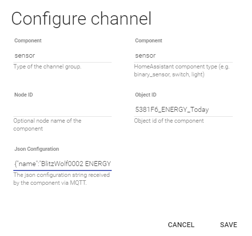

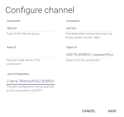

they look like this:
Channel: BlitzWolf0002 ENERGY ApparentPower
Object ID:5381F6_ENERGY_ApparentPower
Json Configuration: {“name”:“BlitzWolf0002 ENERGY ApparentPower”,“stat_t”:“~SENSOR”,“avty_t”:“~LWT”,“pl_avail”:“Online”,“pl_not_avail”:“Offline”,“uniq_id”:“5381F6_ENERGY_ApparentPower”,“device”:{“identifiers”:[“5381F6”]},“~”:“sonoff/tele/”,“unit_of_meas”:" “,“val_tpl”:”{{value_json[‘ENERGY’].ApparentPower}}"}
and a few more:
Channel: BlitzWolf0002 ENERGY Today
Object ID: 5381F6_ENERGY_Today
Json Configuration: {“name”:“BlitzWolf0002 ENERGY Today”,“stat_t”:“~SENSOR”,“avty_t”:“~LWT”,“pl_avail”:“Online”,“pl_not_avail”:“Offline”,“uniq_id”:“5381F6_ENERGY_Today”,“device”:{“identifiers”:[“5381F6”]},“~”:“sonoff/tele/”,“unit_of_meas”:“kWh”,“val_tpl”:“{{value_json[‘ENERGY’].Today}}”}

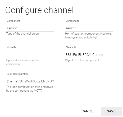

Channel: BlitzWolf0002 ENERGY Current
Object ID: 5381F6_ENERGY_Current
Json Configuration: {“name”:“BlitzWolf0002 ENERGY Current”,“stat_t”:“~SENSOR”,“avty_t”:“~LWT”,“pl_avail”:“Online”,“pl_not_avail”:“Offline”,“uniq_id”:“5381F6_ENERGY_Current”,“device”:{“identifiers”:[“5381F6”]},“~”:“sonoff/tele/”,“unit_of_meas”:“A”,“val_tpl”:“{{value_json[‘ENERGY’].Current}}”}

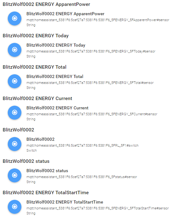

This is the view from the Paper UI
Should i provide more information? Hope thats sufficient for the moment!

as far as it seems to me the binding just took the JSON Config from the HASS Discovery Announcement as it (probably) should. But for some reason (probably not implemented by the new mqtt binding) the JSON is not interpreted as it should be.
