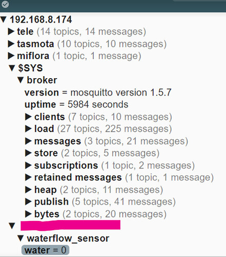

Hi all, I have a mqtt conundrum. I have setup a Wemos D1 with a water sensor. Tied it to wifi and mqtt. And have not been able to get it connected into openhab. This is what I have…
These are the mqtt results from mqtt explorer, sorry, dont know how to embed these…

It shows the topic etc.
/waterflow_sensor/water
In openhab I created a generic mqtt thing, and added this as the topic:
mqtt:topic:mqttbroker:waterflow_sensor
That connects just fine.
I then added a channel and this is where I get sideways. I created the channel with the following code:
UID: mqtt:topic:mqttbroker:waterflow_sensor
label: Water Meter
thingTypeUID: mqtt:topic
configuration: {}
bridgeUID: mqtt:broker:mqttbroker
channels:
- id: waterflow
channelTypeUID: mqtt:number
label: Farm Water Flow
description: ""
configuration:
stateTopic: tele/waterflow_sensor/water
Created an item with the following name:
WaterMeter_FarmWaterFlow
That stays null and does not update in the log. Also, I did not add any json transform.
As I mentioned, I had the value coming in at one point but now cannot duplicate it. But I am sure there is an issue with the channel.
Thanks!
