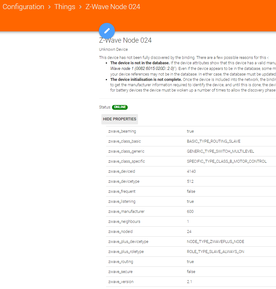

Weird.
That indicates manufacturer 0600 which appears to be unassigned. The Neo Coolcam products are normally id 0258 @chris how could you explain this? Somebody just grabbed the ID?
Z-Wave uses hexadecimal format. PaperUI development is no longer occurring. You likely do these conversions in your sleep, unlike the majority of users trying to solve their problems.
If the OH3 anointed admin interface converts similarly, it might be worthwhile to change the database device & manufacturer listings appropriately.
- ZWave often prints data in hex, yes, but a number is a number, and it’s still exactly the same value if you print it in decimal, hexadecimal, binary, octal etc.
This is stored as a number - most systems print numbers as decimal.
Not at all - I use a calculator.
Please remember that PaperUI has no real knowledge of bindings - it just prints these properties as it sees them. It doesn’t have any way to know how to format data. There is no conversion - it’s just printing the number.
The database just prints numbers - sometimes it’s in hex, sometimes it’s in decimal. Behind the hood is a database that is storing numbers. It’s been like this for 4 years and I don’t really see that it’s a problem.

4- I have searched for new things and the blind switch has appeared, but it remains unidentified.

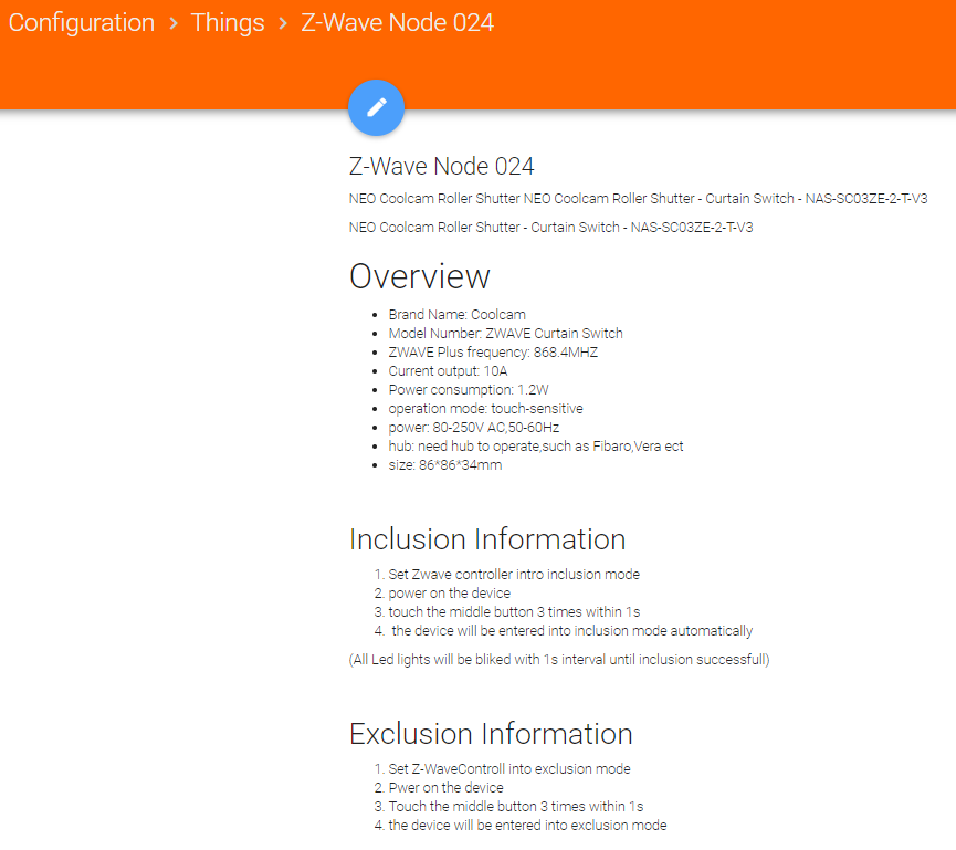

That device in the database was last updated 18 days ago which is much after 2.5M3 was released.
You need to upgrade your zwave binding to the latest snapshot, delete the Thing from OH, and rediscover it.
Yeeesss!!! Working!!!
Indeed, I needed to upgrade from version to snapshot.
Thank you very much for your help. Without it, it would have been impossible.
