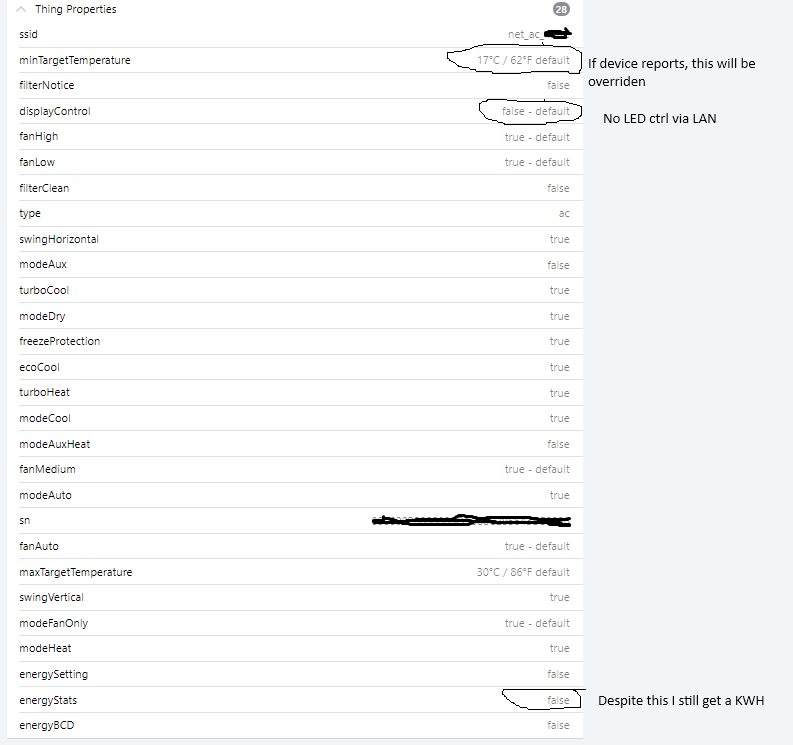

NOTE: Anyone else that has these two flags in the Midea AC thing properties section could test the jar if interested. There is a slight concern from the documentation of these features that they might vary by model.
humidityManualSet  = true
displayControl = true

a few questions (sorry, didn’t read the whole thread):
  1. is it normal, that both commands and reads are set at the polling rate (e.g. 60s)
  2. the lowest the unit can go ist 16°C, the binding only allows for/shows 17°C?
    plus
  3. in the App I can also use a bunch more functionality. Is there a chance to get those added to the binding? They’re not really must-haves, but if those would be available would be awesome.
  4. also: humidity won’t show values (they are also not shown in the App) and the energy-items are slightly off to my energy meter readings, but I guess, they’re also coming from the device itself.
  1. the polling rate default is 60s but can be adjusted. Commands are ad hoc, only when triggered by item/channel change. Maybe I don’t understand?
2, 3 &4 The documents I had, and my device manual shows 17°C. Check the properties under the Thing UI. There is a command to the device about what is supported. If the device advertises support for 16°C, I can see what I can do to override. Also are the app functions shown there too? Conversely, not all binding functionality is supported by the device. For instance, my device doesn’t support humidity or LED turn off.

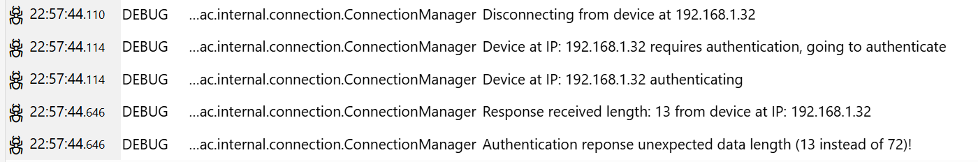

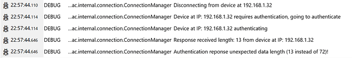

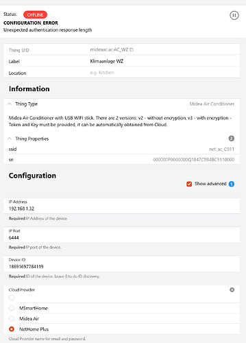

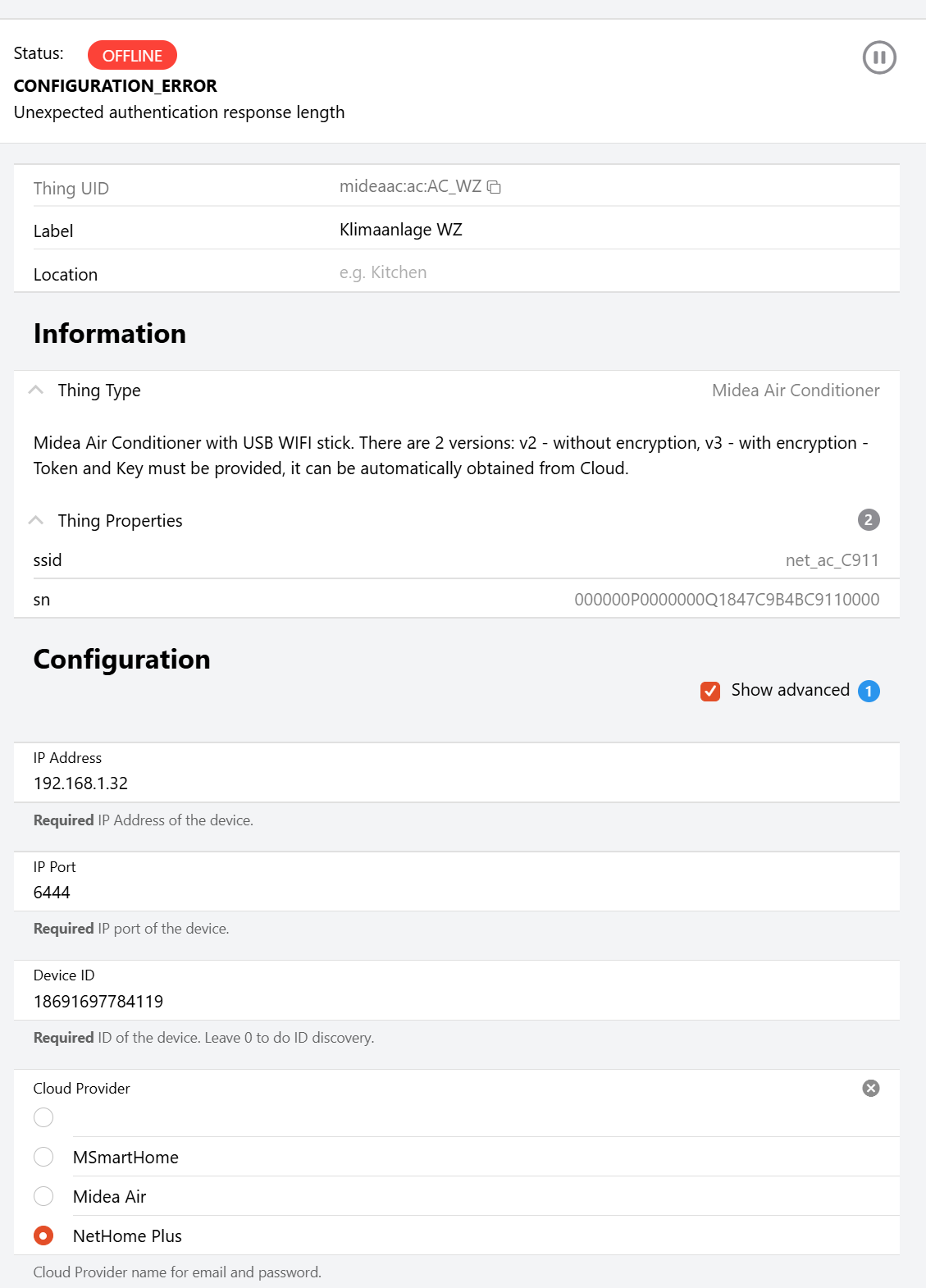

Hi everyone. Hopefully someon can help me, as I am getting really frustrated.
  • Running OH 5.2
  • I have two Clivet ACs with wifi sticks
  • I connected both via MSmartHome App to my wifi and also fixed their IPs in my DHCP manager.
  • Then installed the Midea Binding. Followed docu/readme and token/key were automatically inserted (also device id).
  • Problem is: the thing won’t go online, same error all the time: “CONFIGURATION_ERROR
    Unexpected authentication response length”
What am I missing?
I am running the midea binding on openhab version 5.2 using a debian linux build just fine no issues
Are you running in docker by chance ? if so the cyrpto_security has to be set to unlimited for this binding to work correctly.
Other wise please set binding logging to debug and post your logs.
Or read through the above posts and use the python script to test you can talk to the unit outside of openhab is best advice I can offer at this point.

@elbanana I agree with @justaoldman the cause is likely the security. The message you are seeing is the first method that uses the higher (V3) security in a handshake during initialization. Everything up to that point is just using the built-in V2. For example, in docker
    environment:
      CRYPTO_POLICY: "unlimited"
Also welcome to OH
Thank you for the suggestion!
I checked the Java environment on my setup. My openHAB 5.2.0 is running inside a Proxmox LXC container (using OpenJDK Temurin-21.0.11). I inspected the active Java process parameters, and -Dcrypto.policy=unlimited is already set and loaded by default:
Plaintext
/usr/bin/java ... -Dcrypto.policy=unlimited ... org.apache.karaf.main.Main
Since unlimited crypto policy is already enabled in this Proxmox LXC setup, it seems the initialization/handshake failure might be caused by something else.
Any further ideas on what could be blocking the V3 handshake?

I activated TRACE logging via UI, and found the exact point of failure during authentication:
DEBUG …ConnectionManager Device at IP: 192.168.1.32 requires authentication, going to authenticate
TRACE …ConnectionManager Key: 8ae894f334540bd9…...d814be36
TRACE …ConnectionManager Token: 69593E2C9583207A…434FF5C70AD
TRACE …ConnectionManager Cloud MSmartHome
DEBUG …ConnectionManager Device at IP: 192.168.1.32 authenticating
TRACE …ConnectionManager writing handshake_request: 83700040200001FE…
DEBUG …ConnectionManager Response received length: 13 from device at IP: 192.168.1.32
DEBUG …ConnectionManager Authentication response unexpected data length (13 instead of 72)!
The device returns a response length of 13 instead of 72, which causes the connection manager to abort authentication. Is this response code (13 bytes) indicating an invalid Token/Key pair, or a different protocol version for newer MSmartHome firmware? Or is something wrong with the device itself?
I seem to recall MSmartHome updated their version of the online app. As well as did some stuff related to the api string at one point even.
You might try reconfiguring your AC to be a member of Nethome plus app and see if it works.
Or you could try testing the python script way up in the posts to see if it works using your current token and key that should give you a better understanding if it is binding specific issue. or a bad token key combo.
Changing to different online app is nothing more than putting A/C back into pairing mode and using Nethome plus App to set it up instead of MSmarthome it should then generate a new token key pair that is based on how Nethome Plus App wants it to work.
The python app is here. Also, long shot, what is your thing UID? EDIT: I want to verify if this is an “ac”. There are other Midea AC, with “cc”, “c3” etc. If it says midea_device it is not “ac”
So I deleted the thing I had, installed the Nethome plus app. Put the AC in pairing mode and connected it (with success) to the app. Returning to OH, found the device already in the inbox of things, created thing as seen down here. Did not change a thing. Populated Key and Token directly, but device continues to not work, trace/debug is equal to the one I posted earlier.
Also tried with my own freshly created userdata for the Nethome Plus App, does not work eather.
