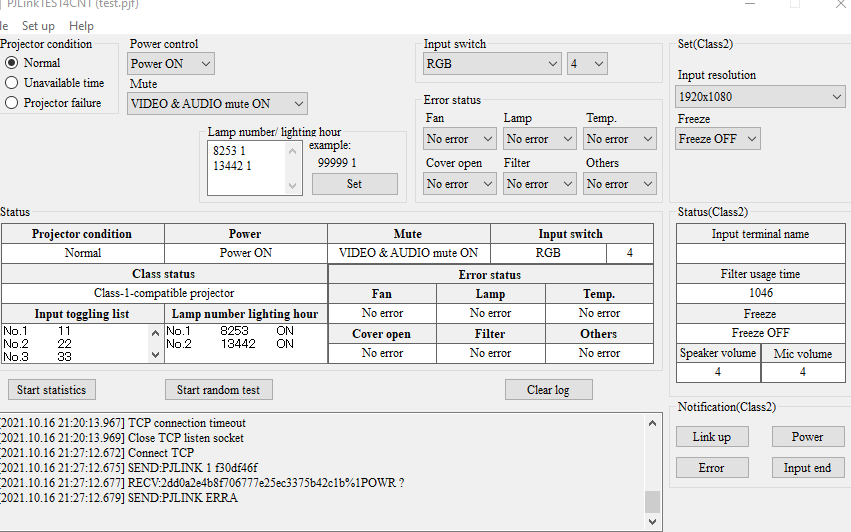

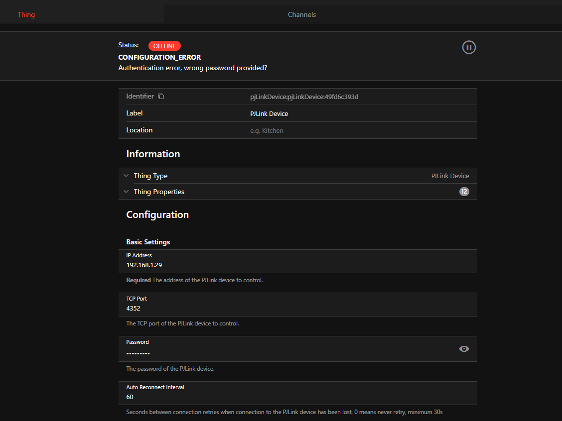

I have changed my system to OH3 , now the PJ-Link binding does not work anymore.
I have tested with the “1-2.PJLink Test Software” and I also get no connection when it requires authentication.
If I turn off the authentication it works.
I think the problem will be in the authentication.
thanks for your help already,
I have tried to disable the authentication on the projector but that does not work on my Epson, there is no setting for it, so I am dependent on the authentication.

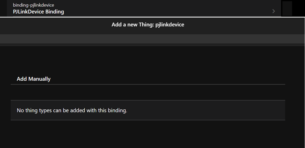

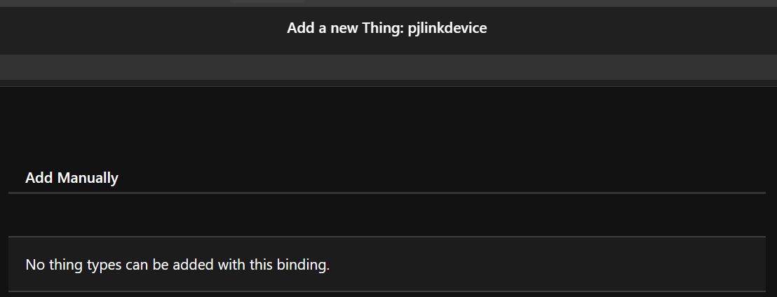

hy everybody, i loved this binding on Openhab3.
now i switched to OH4.0.4
the binding does not work anymore.
i can not create Things/Items.
can you help me?

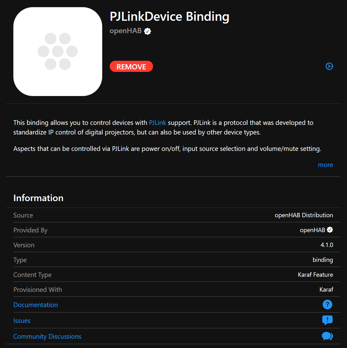

If you still have the issue, it could be caused by an older version of the binding in your “addons” folder.
You can check by going to the “Add-on Store” menu item, click the binding and look at the version.

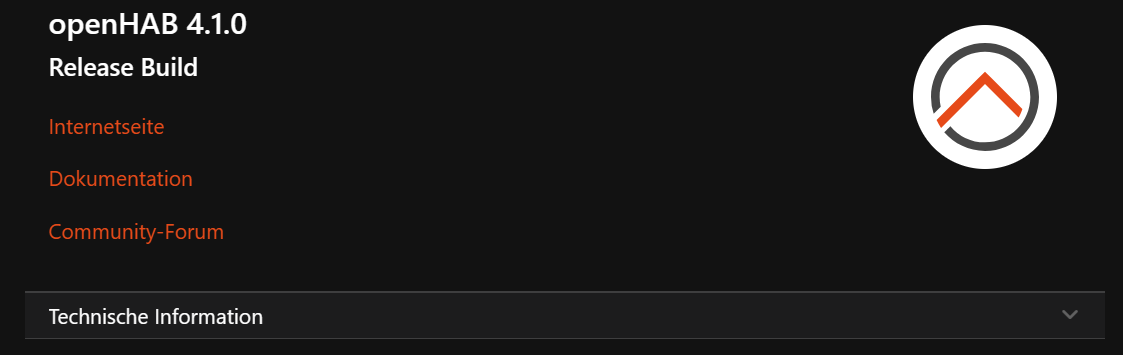

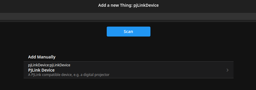

I noticed the same on 4.1.1, actually, and a hint is hidden in our screenshots
As an initial workaround (while I try to find the root cause and confirm that it’s fixed in 4.2.x), you can actually replace the URL when you want to create devices:
/settings/things/add/pjlinkdevice → this is where you are if you follow the UI
/settings/things/add/pjLinkDevice → this actually works
hi, i’m using pjlink binding long time, for different projectors, its working fine.
the projector i have now is EPSON PU1006W. it doesn’t have audio and video mute separated, and has A/V MUTE.
the command from PJlinkTEST4PJ is SEND:%1AVMT 31 for a/v mute and SEND:%1AVMT 30 for unmute. is there any way to use this command?
