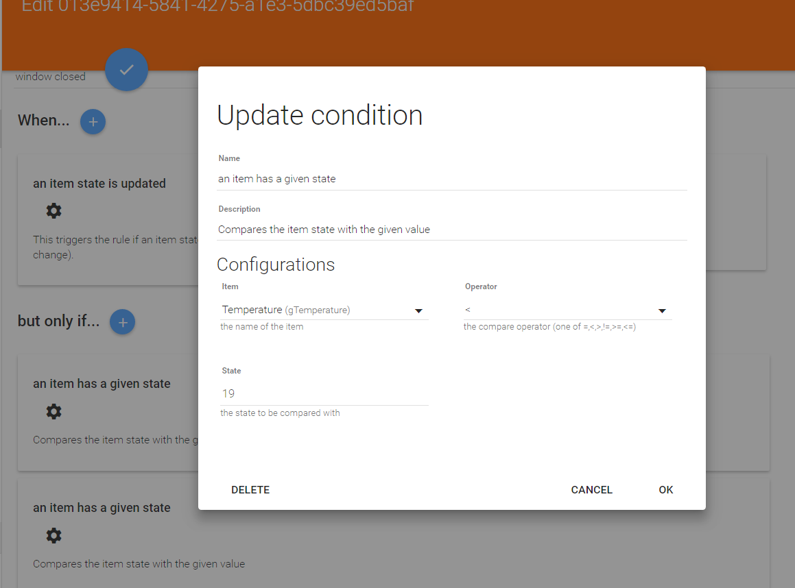

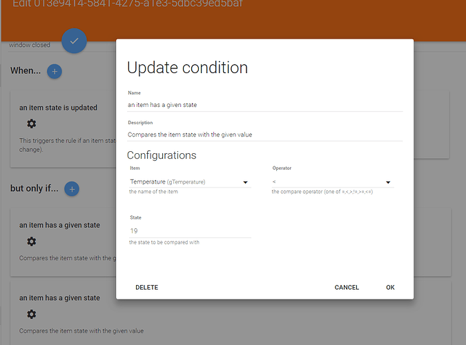

About the degree symbol is like that also in the json, I double checked, but I think that is the problem, a few days ago I added in the item dimension “temperature” just 'cause I wanted to display °C after the value… so it’s probably just a problem with rules with temperature item…
Thank you, in the end I was able to solve the problem, using the temperature group item that doesn’t have the °C symbol in the value.
Thanks again for your tips, now everything is working like a charm and I have a clean json rules file :smiley:
Hold up a sec. I’d like to see if the problem is reproducible. In your JSON, I only saw a degree symbol in the name of the rule. Are you saying you were trying use a Condition to compare the state of a Number:Temperature Item? I haven’t tried that in Paper UI.
OK… I’ve tested this, but not with the same results as you. It looks like Conditions are not working if they contain an Item with a dimension. I’ve tried comparing the state to just a number, and to a number with a unit. More testing needed, but I’ll open an issue if I can confirm. The rule always initialized after saving or disabling/enabling.

In my case, the item gTemperature is a number based on AVG function
If I use directly the item linked to the temperature sensor, I have to select the blank option in the dimension field of the item.

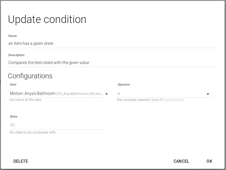

I could be wrong, but I kind of remember seeing ConfigOptions for UoM Items, but now I’m not. This is Firefox and a Number:Temperature Item…
Pushing an update through the console, the rule triggered, but the Action did not fire. The same occurs if a unit is used in the Condition.
