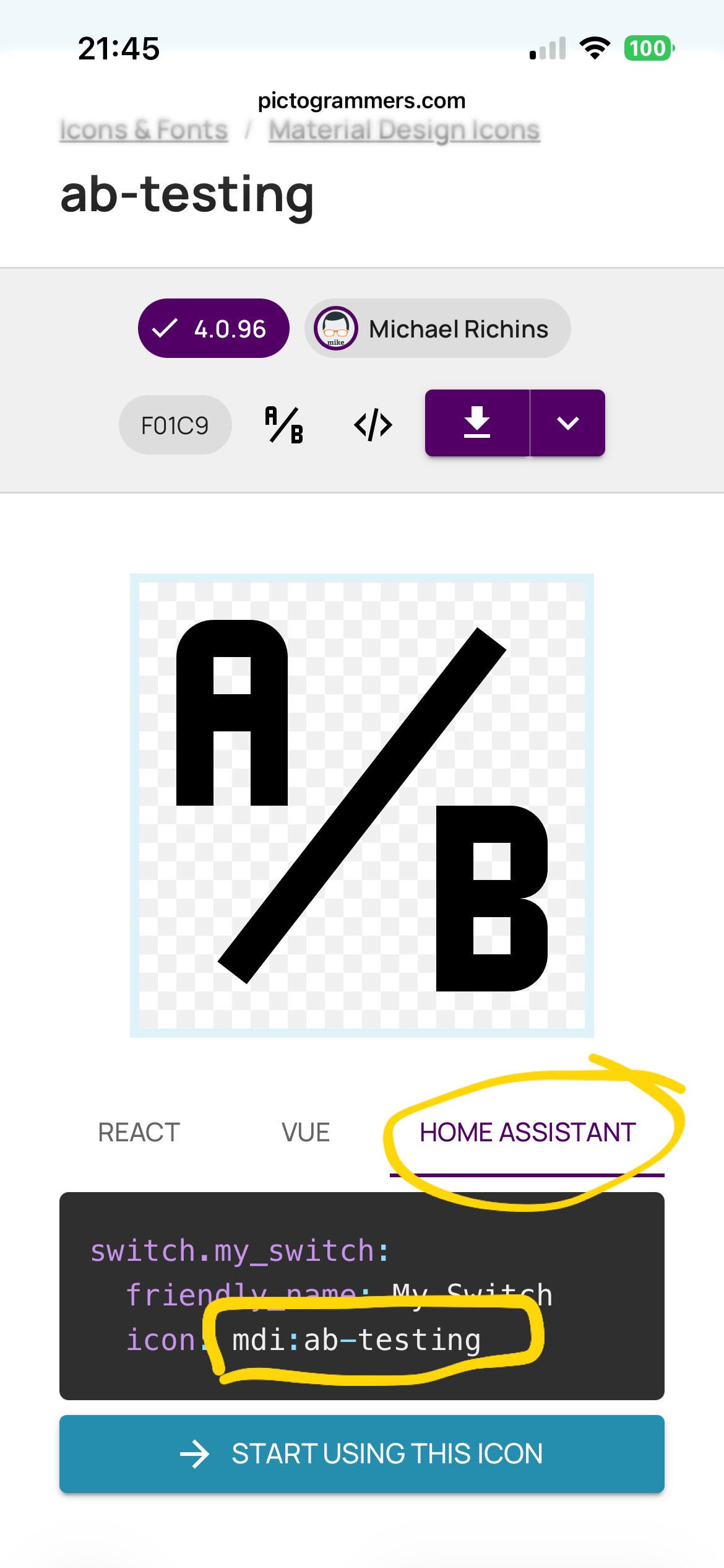

  1. Material Design Icons - Icon Library - Pictogrammers
  2. search for icon
  3. switch to home assistant
  4. copy code, e.g.: mdi:something or other
  5. paste in OpenHAB icon field but add “if:” like so: if:mdi:something or other
