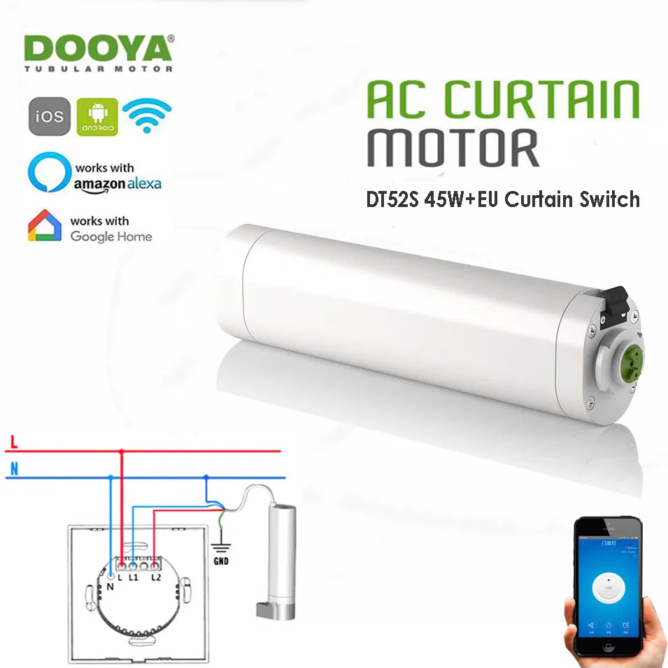

Do you think this wiring will power the motor all the time, so it can sense manual pulling the curtain so it can open/close it by itself?
You’ll have to ask the manufacturer/dealer. NOt enough info on that diagram
Unfortunately the Aliexpress sellers aren’t with the best English, and they cannot describe well :smiley:
I was hoping for someone with experience, who had the opportunity to test them.
I would avoid the DIY/Ali express route when it comes to curtain motors
I would choose an established company
Which brands to look for then?
There’s enough info to be frightened … one mains pole appears to connect to motor body earth.
What a nice drawing. I think it will raise the sells :rofl:
