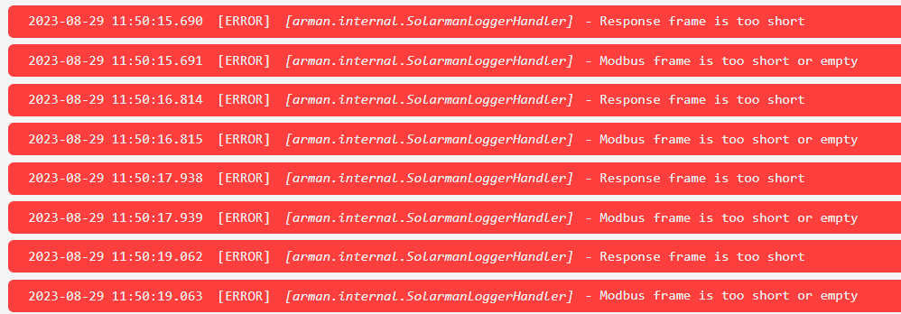

Ok, just do it. Now its installed and offline. i have select the mppt 2 type and try the genegic also.
Is the IP & Serial Number of the logger correct?
Can you post what it says in the logs? There should be some exceptions there.
ip adress is checked and also the Serial number . i can login with the IP and I copy the SN from the logger webside
log:
2023-09-04 13:24:11.211 [ERROR] [arman.internal.SolarmanLoggerHandler] - Response frame has invalid starting byte
2023-09-04 13:24:11.213 [ERROR] [arman.internal.SolarmanLoggerHandler] - Modbus frame is too short or empty
2023-09-04 13:25:04.418 [ERROR] [arman.internal.SolarmanLoggerHandler] - Response frame has invalid starting byte
2023-09-04 13:25:04.421 [ERROR] [arman.internal.SolarmanLoggerHandler] - Modbus frame is too short or empty

@HolBaum5 confirmed in one of the messages above that the binding is working for a Deye 600 micro inverter, so I guess it should work for you as well.
Can you please enable debug logging and paste the request/responses?
Issue a log:set TRACE org.openhab.binding.solarman in the console.

2023-09-04 14:18:12.158 [INFO ] [rnal.modbus.SolarmanLoggerConnection] - Error creating socket
2023-09-04 14:19:12.146 [ERROR] [rnal.modbus.SolarmanLoggerConnection] - Could not open socket on IP /172.16.20.95:502

Are you sure 502 is the right port? Usually it’s 8899 for all the loggers I’ve seen.
i have try the 502. Someone write it. the 8899 was also not working. but now I will go back to 8899 and sent the log again
2023-09-04 14:29:17.163 [ERROR] [arman.internal.SolarmanLoggerHandler] - Response frame has invalid starting byte
2023-09-04 14:29:17.164 [ERROR] [arman.internal.SolarmanLoggerHandler] - Modbus frame is too short or empty
2023-09-04 14:30:17.152 [ERROR] [arman.internal.SolarmanLoggerHandler] - Response frame has invalid starting byte
2023-09-04 14:30:17.154 [ERROR] [arman.internal.SolarmanLoggerHandler] - Modbus frame is too short or empty
2023-09-04 14:31:17.153 [ERROR] [arman.internal.SolarmanLoggerHandler] - Response frame has invalid starting byte
2023-09-04 14:31:17.156 [ERROR] [arman.internal.SolarmanLoggerHandler] - Modbus frame is too short or empty
2023-09-04 14:31:17.158 [INFO ] [arman.internal.SolarmanLoggerHandler] - Assuming logger is OFFLINE after 3 failed requests. Disabling connection error logging until it becomes available again
2023-09-04 14:37:26.684 [ERROR] [arman.internal.SolarmanLoggerHandler] - Response frame has invalid starting byte
2023-09-04 14:37:26.685 [ERROR] [arman.internal.SolarmanLoggerHandler] - Modbus frame is too short or empty
nothing else
Are you sure you enabled trace logging correctly using log:set TRACE org.openhab.binding.solarman ? You should have records in your log which look like this:
2023-08-02 09:43:26.375 [DEBUG] [rnal.modbus.SolarmanLoggerConnection] - Request frame: A5170010450000B4D547F902000000000000000000000000000001030003007E35EADB15
