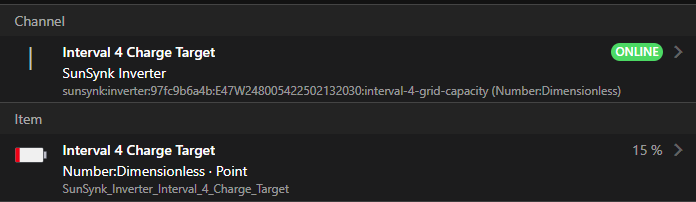

Item:
Thanks.

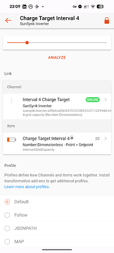

Is your item defined to be a set point.
Number:Dimensionless Interval4GridCapacity “Charge Target Interval 4 [%s]” (SunSynkInverterControls) [Setpoint] { channel=“sunsynk:inverter:a5fb8ca2fd:EXXXXXXXXX:interval-4-grid-capacity”, listWidget=“oh-slider-item” [subtitle=“Set % SOC”, title=“Target SOC”], widget=“oh-slider-card” }

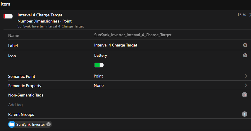

If your not using the .items file:
Use the Semantic Model: Edit the Item and set the “Point” tag to “Setpoint”. This tells openHAB that the value is intended to be changed, and it will often automatically provide a slider or stepper widget.

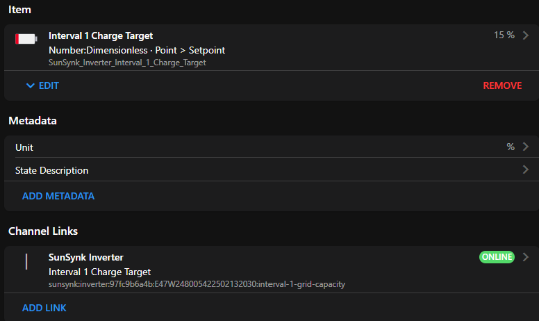

That made no difference but I noticed that mine, for some reason, had the ‘unit’ set tp % where I could not see that on your screen shot:
Removed the unit, and now it works perfectly.
