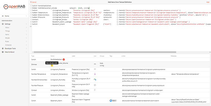

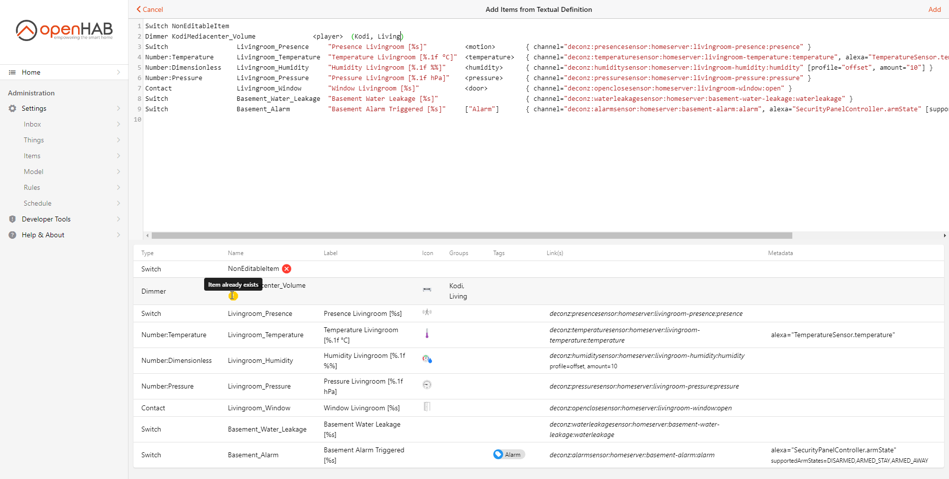

New tool: a purely JS parser for item definitions

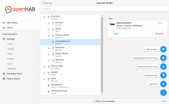

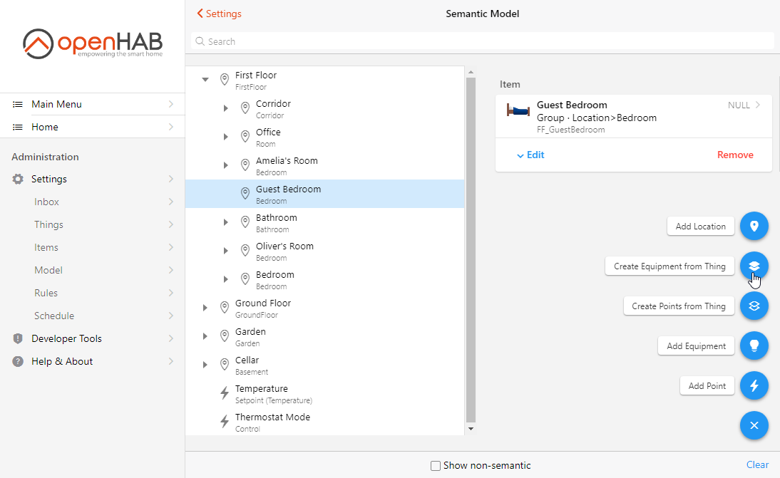

Here’s a pure-UI scenario you can try if your things are already there and you need to create items for them:
  1. create a hierarchy of locations (groups) using the semantic model builder:
2019-10-09_17-29-36

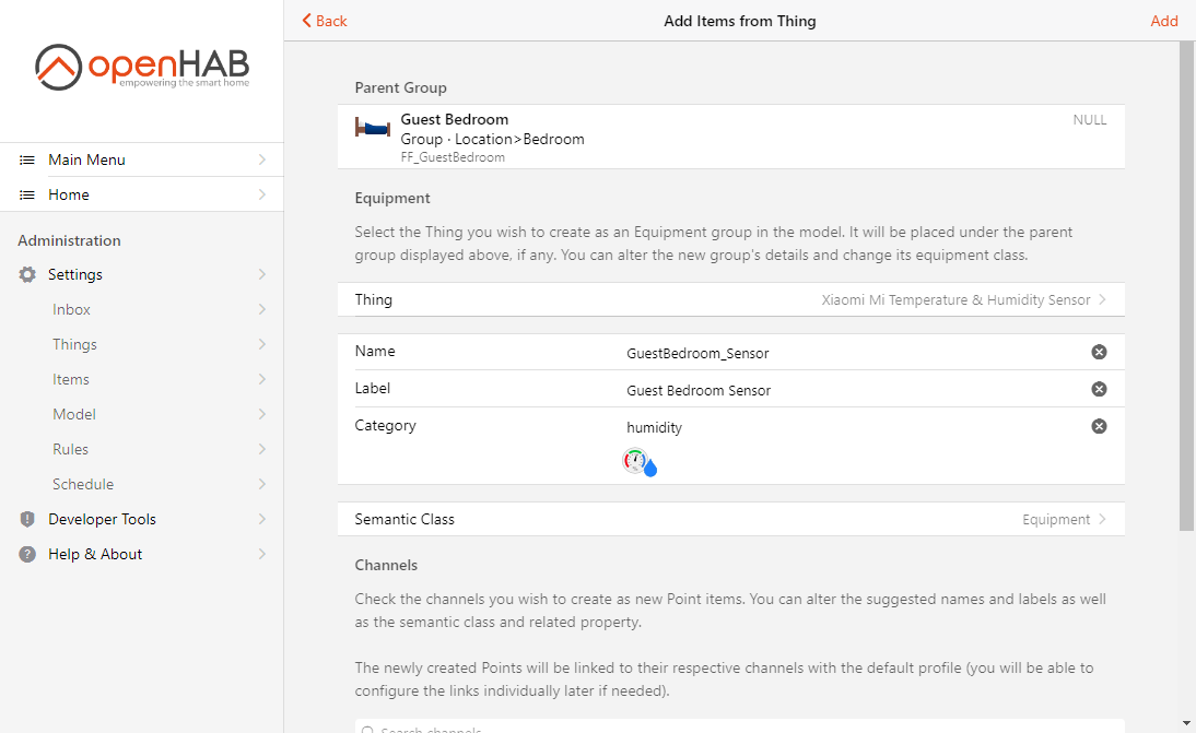

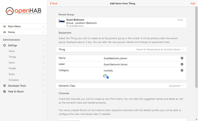

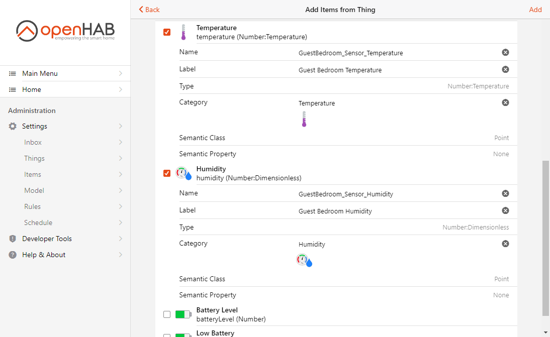

  1. select a location and choose the “Create Equipment from Thing” option with the lower-right-corner button:
  1. this will add a Group item representing a Thing (Equipment), and the channels you choose as Point items. You have to configure the name, labels and so on for each item that you’re going to create. This feature basically replaces the “simple mode” but with more control.
    And yes, there needs to be a way to configure the prefix of items’ names, and a “check all” option for channels…
  1. When you’re finished, click Add and the hierarchy of items will be added to the model under the group (location) you selected as the parent.

Exactly, it lets you choose where in the hierarchy you wish to insert the items, which channels you need, and change the name of the items before they are created (the names of the items created by the simple mode are often ugly, and you can’t change them afterwards…).
The other similar option, “Add Points from Thing”, is basically the same but without creating the group - instead you select an existing group in the tree view first, and the items will be added to that group. For instance, if you originally decided against linking some channels and now want them, or if you add some channels to an extensible Thing like a MQTT thing, you can then use this option on the original equipment item.

I’m moving the tool out of the developer tools section, by the way (it’s on the items list now, as an option besides “add item” and is now called “Add items from textual definition”), and making it a little more user friendly:
Now if the parsing is successful it will show the results in a table, and it’s also able to tell you if an item with the same name already exists, and whether it’s editable or not (because it’s provided by an .items file). If you’re trying to overwrite a non-editable item it won’t let you proceed - it wouldn’t work anyway. Not done yet, but I suppose it could also check the channels, making sure they exist.
