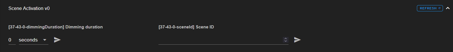

It looks like two issues, one in ZUI, one in the Z-Wave JS binding.
My findings from today:
I activated MQTT in addition to the WS Server.
I was able to get the Scene Activation CC working in ZUI:
As long as I don’t restart ZUI, the CC stays active → ZUI problem
I deleted the Z-Wave JS Thing and rescanned it, but the Scene Activation CC does not appear. → Z-Wave JS problem
I looked into MQTT and found:
{"time":1755440716788,"value":14}
{"time":1755440714130,"value":16}
So it seems to work in MQTT.

I just posted my issue here.
Then I found this newer thread and it seems discussions about scene activation are already ongoing. I guess this is same/similar to what others have experienced?
Scenes are detected in Zwave JS UI. They are also forwarded to my HomeAssistans instance. But in OH I get nothing when triggering the scenes.
Scenes are currently not supported. It was one of the areas that needs work and didnt make it into oh5

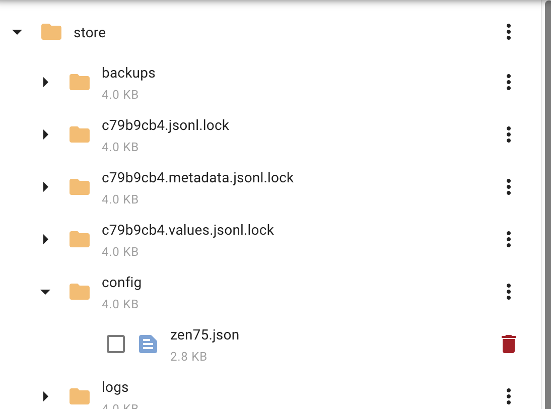

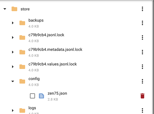

@sihui I’m curious why this didn’t work. I assume you put the file in the config directory… Did ZUI not pick up the file, or was there some other problem. I’m trying to add a device file for a device that’s not in the database, and I can’t seem to get ZUI to recognize the file/device.
I probably had the wrong syntax.
@apella12 provided me a json which works like a charme.
If you need more information, please shout.
Yeah, that’s what I did.
And I’m pretty sure the json is correct because I modeled it off an almost identical device.
I have a snap installation, so I wonder if that’s causing the issue. If it’s looking for a directory named store, it doesn’t exist in a snap installation e.g. /var/snap/zwave-js-ui/current/config/zen75.json
