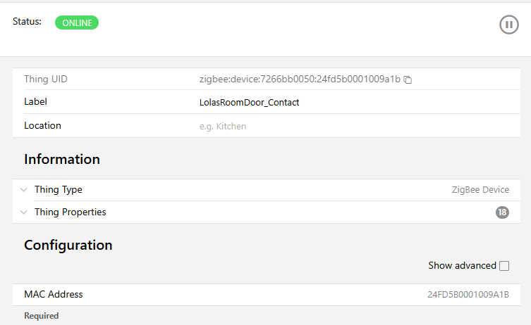

  • Issue of the topic: I’m switching from SmartThings to Zigbee controller. I just setup the Zigbee binding and was able to scan and add two SmartThings contact sensors and a presence sensor. The things status is Online. Since these are contact sensors, I want to create rules for when they are opened or closed. So I open and close the contacts but I don’t see anything in the events.log. I took the battery our of the presence sensor

    2025-02-16 22:06:59.873 [INFO ] [ab.event.ThingStatusInfoChangedEvent] - Thing ‘zigbee:device:7266bb0050:24fd5b0001009a1b’ changed from UNKNOWN to ONLINE
    2025-02-16 22:07:12.610 [INFO ] [ab.event.ThingStatusInfoChangedEvent] - Thing ‘zigbee:device:7266bb0050:24fd5b0001009dbc’ changed from UNKNOWN to ONLINE
    2025-02-16 22:07:27.175 [INFO ] [ab.event.ThingStatusInfoChangedEvent] - Thing ‘zigbee:device:7266bb0050:24fd5b000108cc6b’ changed from UNKNOWN to ONLINE

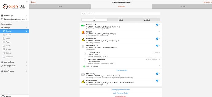

do you see the channels for the thing? have you created the respective items?

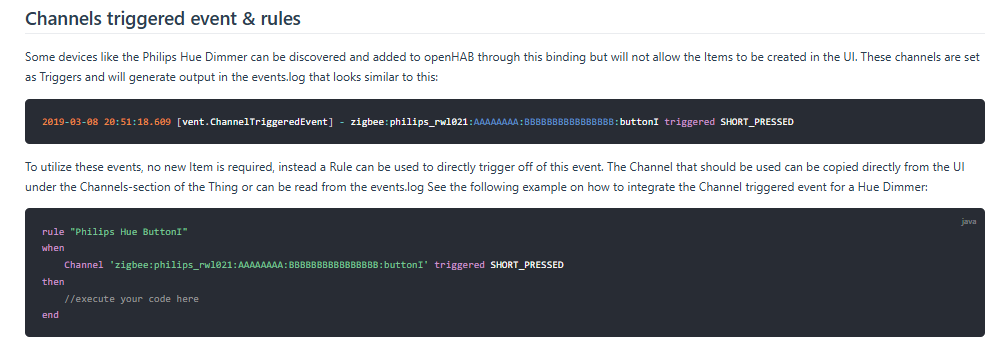

Yes, I saw those channels. But I was following the Zigbee documentation:
I take it that I need to create Items using these channels & then I’ll see log entries in the events.log? Searching for that process now.
select the channel you wish to link to a item
click the green + to add link select either a existing item or create new item give it a unique name and save it then you have a channel linked to a item that will see a event when its state changes.
Also the documentation says some devices with the key word being “some” :wink:
I was in the process of creating an item file for this. Thanks for the quick reply.
2025-02-16 23:10:02.159 [INFO ] [openhab.event.ItemStateChangedEvent ] - Item 'LolasRoomDoor_Contact_Binary_Input' changed from NULL to OFF
That did the trick. Thanks!
