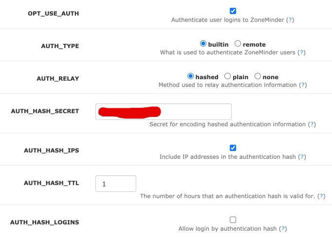

Here’s what my config looks like. I’m running 1.34.21.
