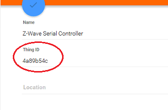

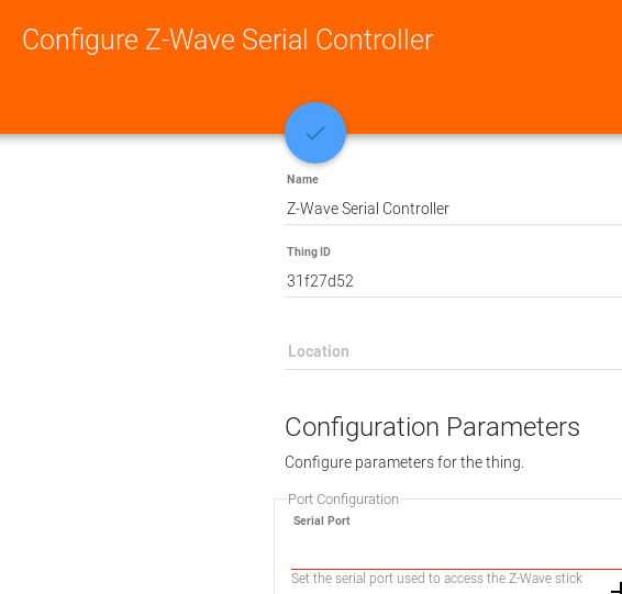

It’s a randomly(?) generated ID for the new controller thing, you can change it to whatever you want during creation, here:
For example, i’ve renamed mine to be “zStick” so all my zwave things show like this: zwave:device:zStick:node2:switch_binary. This can be helpful in the future if you ever have to delete the controller thing
Do you mean the ThingID for the controller? This shouldn’t change, as the instructions state to not delete the Thing for the controller. If you did, and added a new Thing for the controller, just delete it again, add it again with the ThingID that you had before. Check your items files (if you have them) for what it was. Then your items will not need to be changed.

I see no way in habmin or paperui to create a controller with a specific ThingID.
In either when I do a scan it finds the controller, no option to set a ThingID. After that the ID is set to 512.
In PaperUI, go to the Inbox. Click the big blue button, select Zwave, click Add Manually, select serial controller. One of the first fields is ThingID…
Ok, so I now have a controller with the old ThingID.

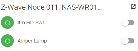

Now in PaperUI > Control I get this:
“Itm File Swt” from the file and “Amber Lamp” from created by habmin/paperui from before.
“Itm File Swt” controls the device, no error in log.
“Amber Lamp” does not control the device, logs the error.
