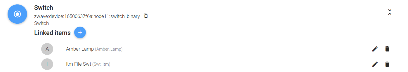

Double check that your items are properly linked to channels for your managed items. I bet if you look at the channels for a Thing in Habmin or PaperUI, that you will not see any links.
If you need to redo all of the links, you may become an items file convert…

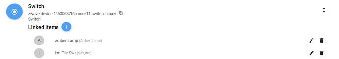

Well, it looks like I would have bet and lost… the item looks like it is still linked. What happens if you delete the link (not the item) and then relink the item?

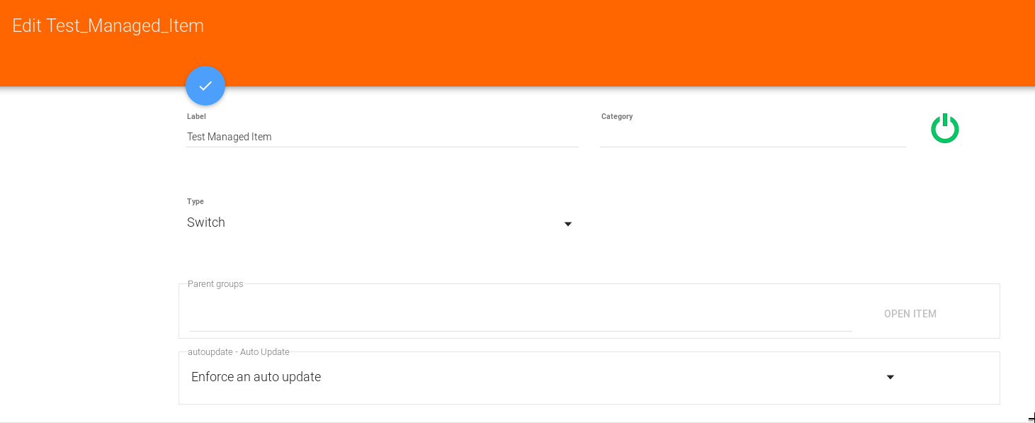

I think I have a workaround… if you edit your item, you’ll probably notice that the Auto Update field is empty. When I created my item, I intentionally left this blank. When I select an option, I no longer get the error.
