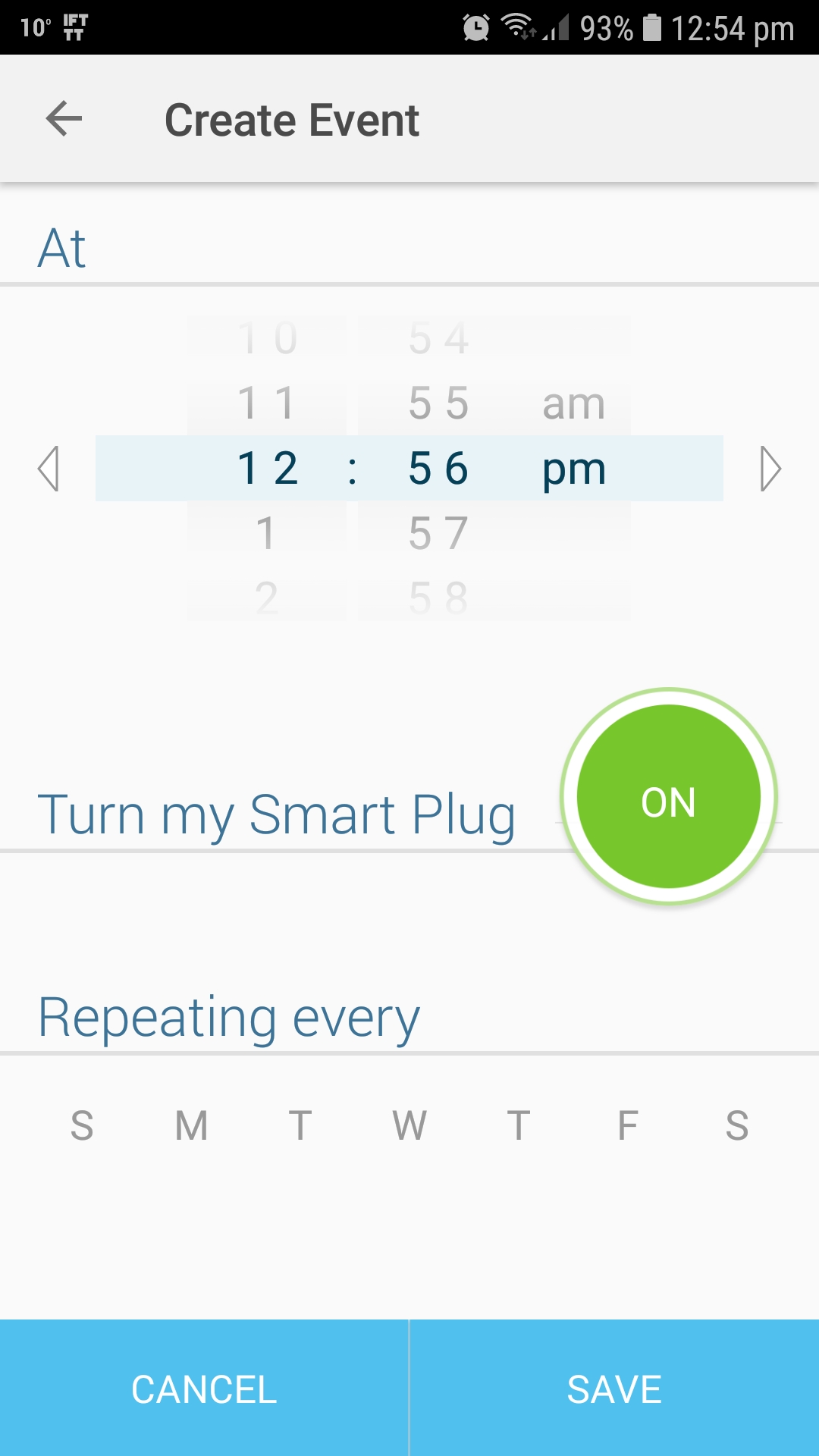

So - plan 1 was to put a HS100 TP Link switch on it and schedule it to turn off at midnight and on a 0700 - when nobody will be using it.
That works just with the Kasa software. The problem however is that the TY detects the power coming back on and fires up as if you were wanting to watch something.
