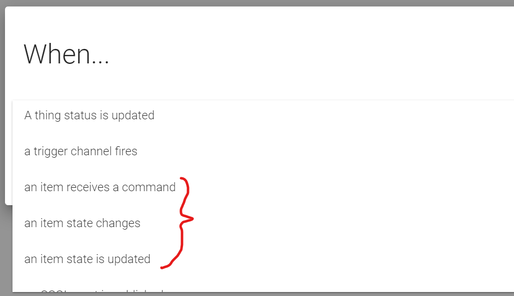

So, as Scott suggested, if you want to create a Rule using PaperUI which gets stored in the JSONDB, you would use one of the Item Rule triggers:
It’s unfortunate that the Item triggers aren’t listed first but PaperUI sucks for creating Rules. It’s definitely possible to do so, but it’s not recommended (though once you have Rules in JSONDB they run really well and OH boot times are super fast).
