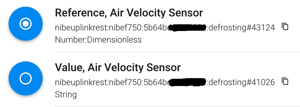

Are you certain that the item is linked correctly to the channel? What is the channel id of the channel? (In my system it’s defrosting#40050)

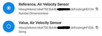

Id is 41026. I unlinked it, but couldn’t link it back as there wasn’t suitable item. And that could be because this channel is created with string type, and not number as reference air velocity?
That explains the problem, but not sure how it happened. Nibe must have sent a strange value for it when the binding requested all available parameters to create the channels. Anyway, deleting the thing and rediscovering it should hopefully recreate it correctly.
Edit: it might actually be a bug in the binding, i had hardcoded the channel as a specific type, but since your parameter id is different from mine it didn’t catch that. It’s easy to fix though, will upload a new version shortly.
Updated, but the channel still has string as a type. Do I have delete the thing?
Yes, delete it and rediscover it, everything should come back the way it was before (except for the channel), including all connected items.
It’s still “string”, although I did deletion & rediscovery?
Hmm, perhaps the result gets cached, then you need to delete the thing, restart the bundle (or openhab) and then rediscover. In the meantime, since nibe had some downtime this weekend i got the opportunity to debug and solve some stability issues, should be much better now. OH2 version and OH3 version are available for download. If you delete your thing before placing the new jar in the addons folder the bundle gets restarted when it updates, and then it should hopefully be discovered correctly.

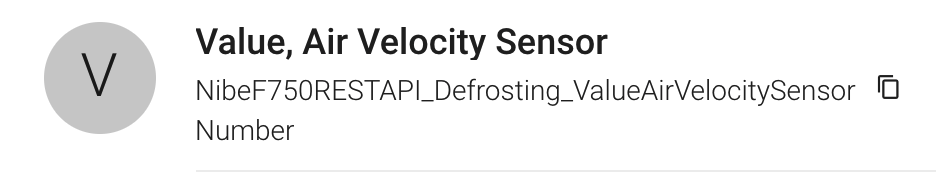

For what’s it worth, in the items air velocity has correct type:
That’s odd. If you connect a String item to the channel, does it get any updates? If that doesn’t work I would need to see some trace logging output for when the items are updated.
There’s no corresponding string item, only that item with number type, and that I cannot link to a channel that has string type…
