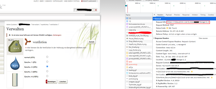

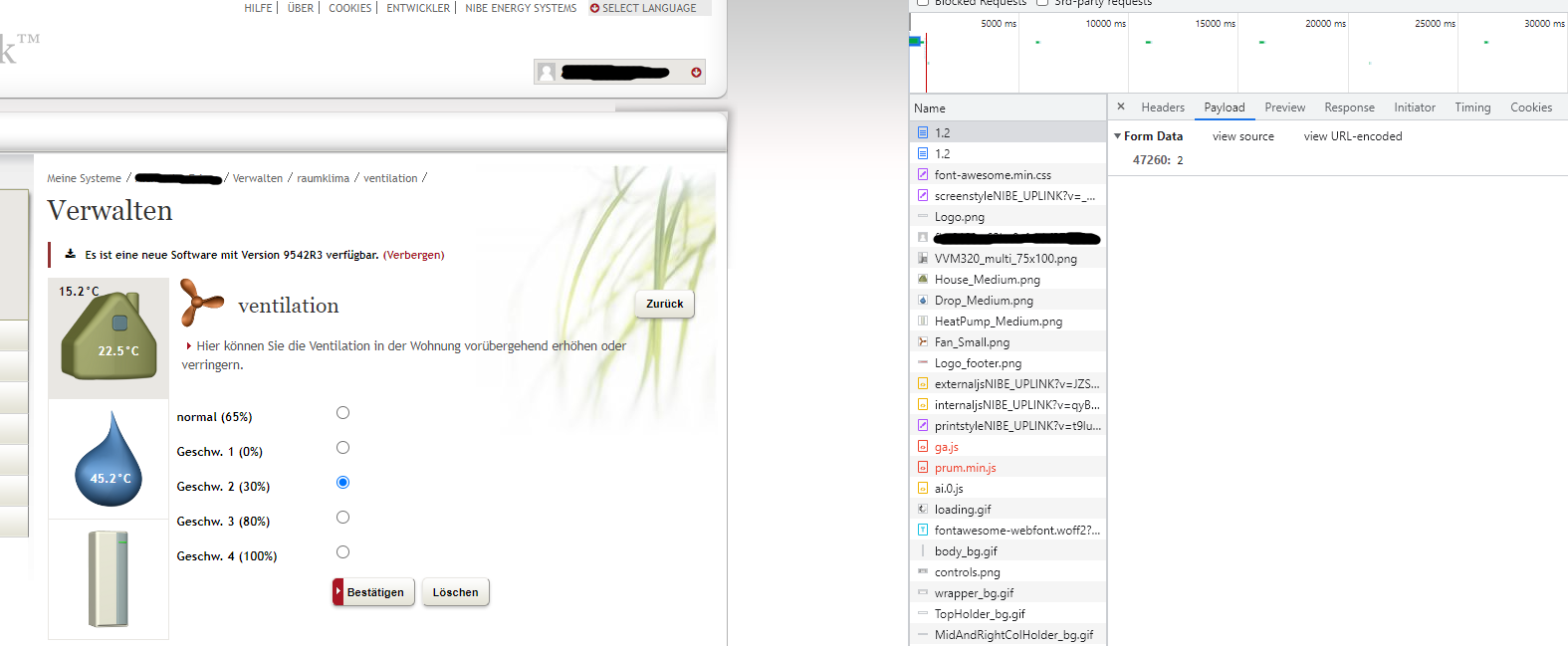

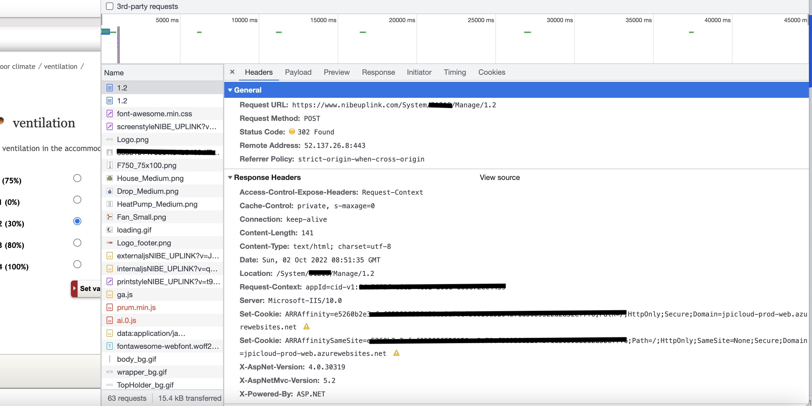

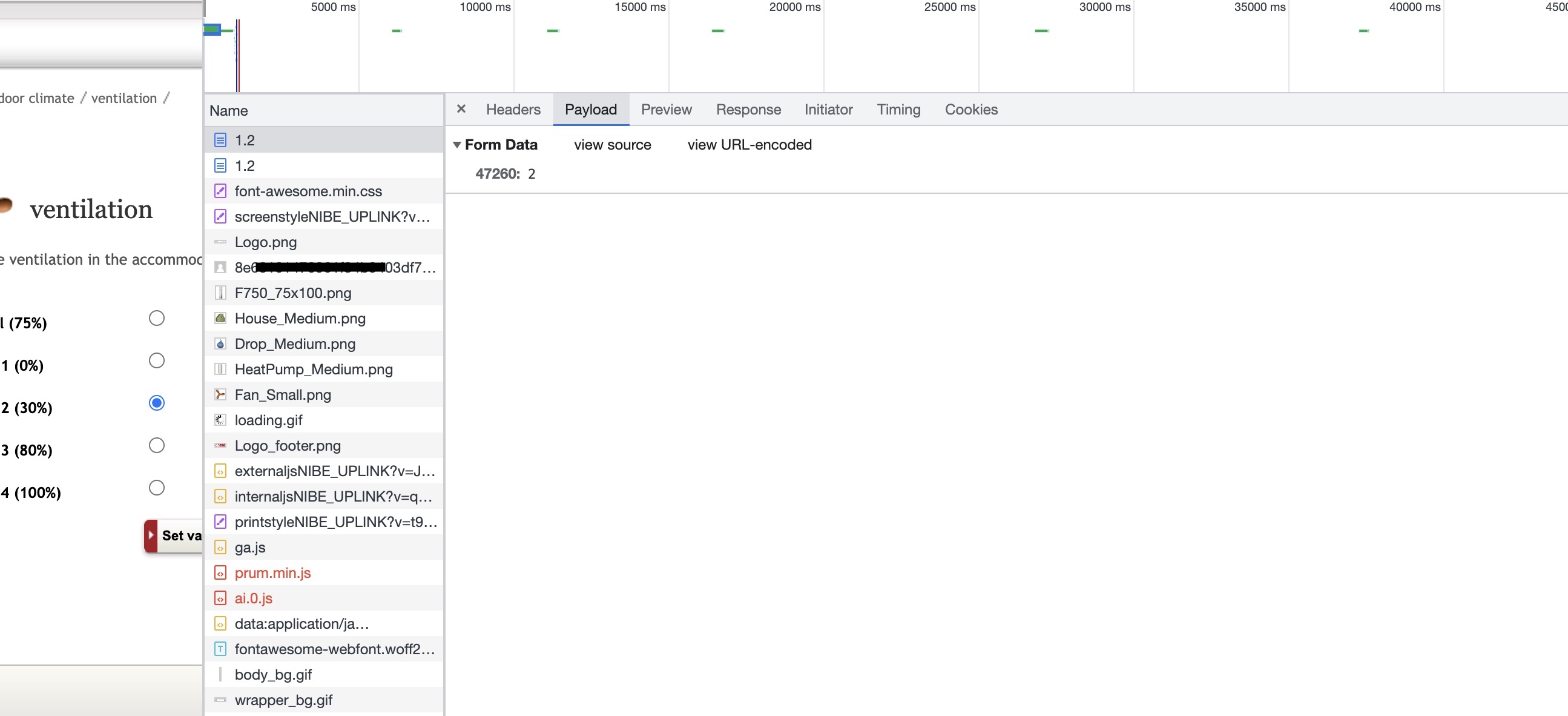

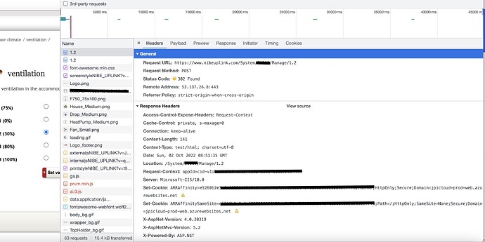

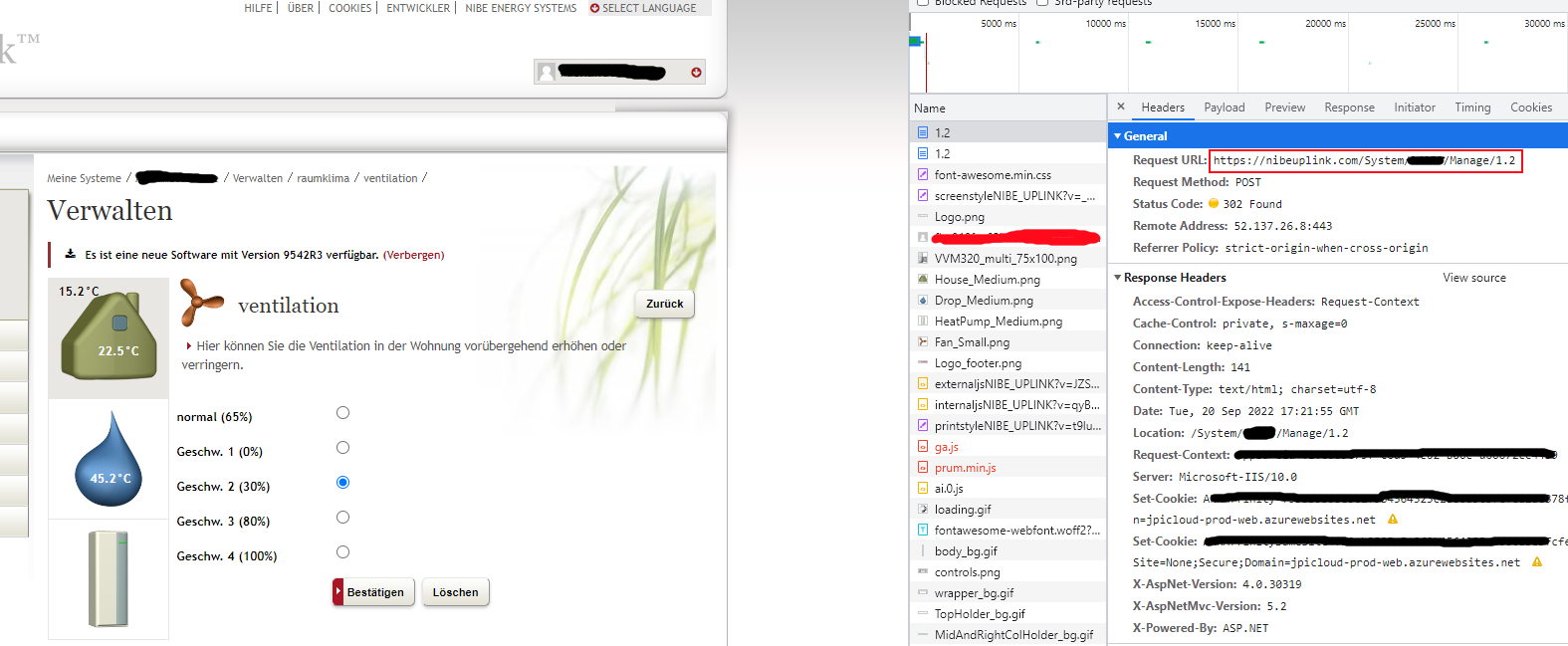

This will be wuite complicated. You will need to find out the URLs that are called from the website. This can be checked via the developer tools that are part of Google Chrome.
E.g. it looks like this for my NIBE VVM320 when I change the ventilation speed to ā€œ2ā€:
Alex,
Sorry for the delay.
This is what my system looks like when I change the fan to option 2 (30%)
I cannot see any difference. The binding uses the same API calls.
