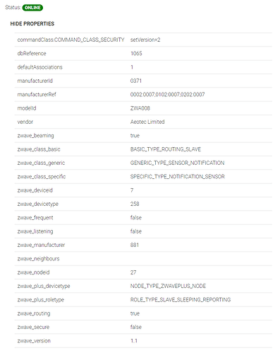

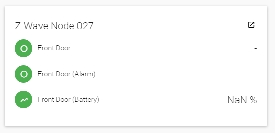

The sensor shows up in HABmin and PaperUI as not secure, which is desired. But after activating the sensor, manually waking it up, and waiting for over 30 minutes, there doesn’t seem to be any events in the events.log file or any state showing up in PaperUI Control tab. All I see is:

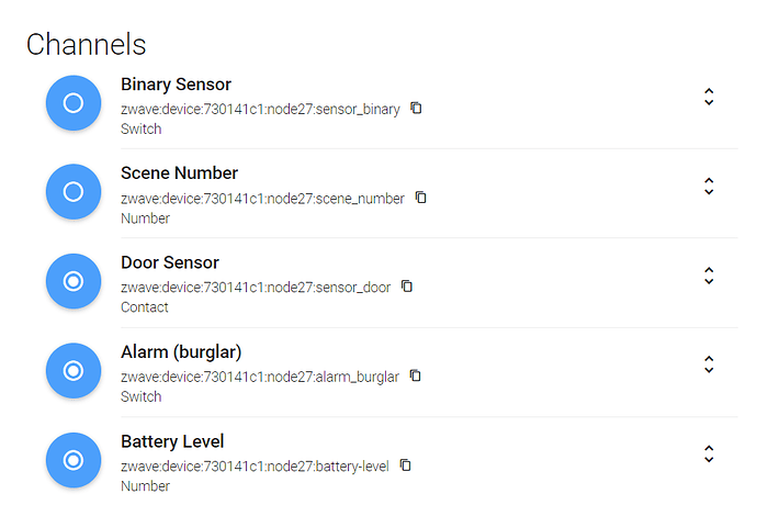

The settings for the sensor itself is shown here, and it shows that I have Items for the contact sensor, alarm, and battery level:
Why am I not getting sensor updates from this sensor?
