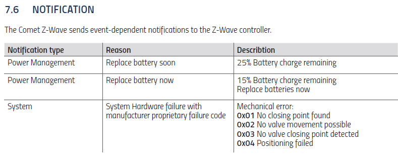

I’m not sure that it is a good idea to change the power alarm to Battery as that’s something different (I believe). In any case, at least in my installation, both Alarm (power) and Alarm (system) are consistently NULL.
The alarms need to match the configurations in the binding. tl;dr; version

According to the manual the device sends alarm_battery, not alarm_power. Also in my experience it will be null until the battery gets low.
As to the system alarms, the codes 1-4 are not in the binding under alarm_system, so that will always be null until that is fixed with a PR. Possible;

But only these are triggered with alarm_system,

It is a little tricky, but basically you are right regarding the alarm_system. The alarm_power just needs to be changed to alarm_battery because that is what the device manual says is being sent.
