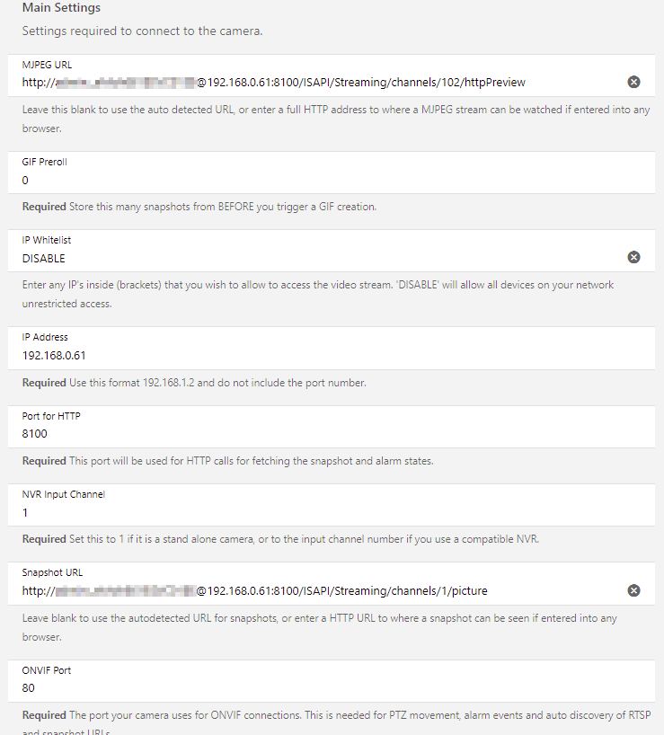

I recently upgraded from V3.1 to V3.2 and though this solved a lot of problems I faced before the integration of my HIK-Vision DS-2CD2010F-I Cameras still does not fully work.
I created a thing based on the ipcamera binding for HIK-Vision cameras. There I entered the proper URLs for the “Snapshot URL” and the “MJPEG URL” (that I’ve verified in the Browser) as shown below:

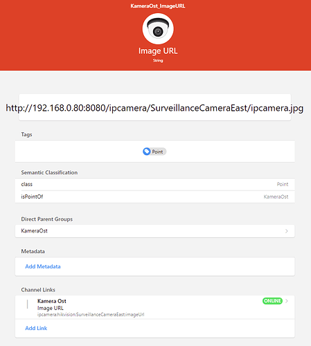

The Image_URL Item created from the ImageURL channel of this thing shows a wrong URL:
