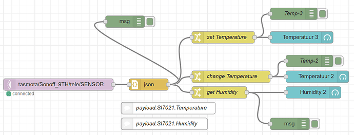

I am trying to start with node-RED as an alternative rule engine. My first attempt is getting my Sonoff TH16 switches working. I have two of those, which have a S17021 temperature sensor and the other an DS18B20 Temp and Humidity sensor. The switch part of these Sonoff’s is working perfectly. That was the easy part :wink:
But i do not know how to extract the temperature and humidity values and display these on the dashboard.

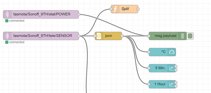

I am trying with this setup.

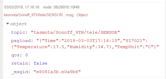

I found that i have to translate the JSON code in order te get the values. The debug output of this is:
But i don’t know how to get the individual values out the payload. Can somebody help on the way how to do this?

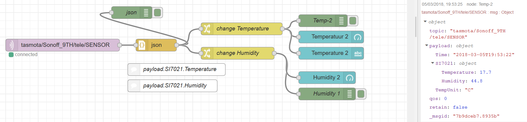

OK, i tried to extract the sensor object from the payload with a change node. Like this:
The cfg of the temperature change nodes is as follows:
and
I do get debug info from the json node, (see the commend nodes) bu i do not get any debug info after the change nodes…
Hope someone can shed a light on this… Bare with me, I am very new to node-Red…

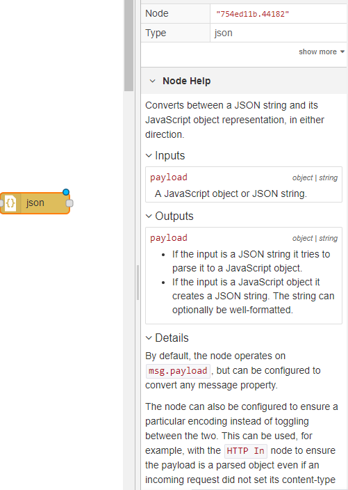

I mean just try using the node red build in json note, It reads:

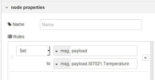

Change node:
only one change needed
Set msg.payload
To msg.payload.SI1721.Temperature
@vzorglub

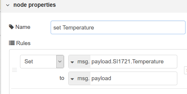

I am not sure whitch fields i should change. In msg #89 i placed two node properties. Which of the two are you refering to? Could you please put an screen print from what you exaclty mean. I appreciate your help very much!
The change Temperature node needs only one change
Set msg.payload
Hi @vzorglub
I configured the … node but i receive the same message as debug output…
And these are the change Temperature change node properties:
As you can see in de debug part, the debug from the change step is the same as fron the json step…
Perhaps must there some selection in the Gauge node?

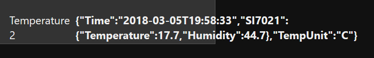

I put also a text node and this displays the followingh:
Hi all, Found a solution using a function node:
The SI code you provide before was wrong:
It didn’t work because node-red could get the object property and didn’t set a new msg.payload.
Your work around is correct.
