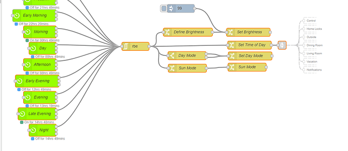

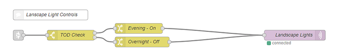

That said, how I use ToD is two fold: 1) trigger events at a change in ToD; and 2) use a global variable to store the current ToD to check the point of executing another trigger. To be specific:
Below is a snapshot of some of my ToD triggers. You can see where I use it to Set my ToD variable and then pass them on to a link node and you can see where the links go in my system.
I have a BigTimer trigger to define “Evening” (which is defined at Sunset) and “Night” (defined as midnight. This then gets sent through the Link node to my landscape lights (and others like indoor table lamps I keep on from sunset to sunrise) where I check to see if it is either one of those two time events and turn the lights on/off accordingly:

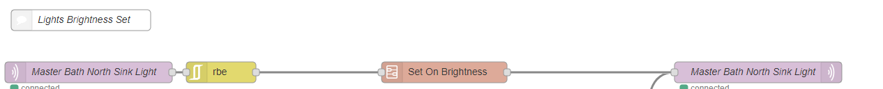

From above you can also see where I set a brightness variable based on the ToD. I use this to set many of the dimmers in my house when they are turned on to that brightness interval (started in our master bathroom so I didn’t get blinded when I turned on the lights when I first get up before sunrise during the winter months. I actually created a subflow since I use this quite a bit throughout the house now and have to make sure the light is turning on, not just having a dimmer level adjustment.

I saw you solved it with a function node, you can also just use a change node to set msg.payload.level to 80 and achieve the same thing.
@rgerrans, I think I understand after I’ve seen your pictures. WIll see within 1 hour if i got it when evening start :grinning:

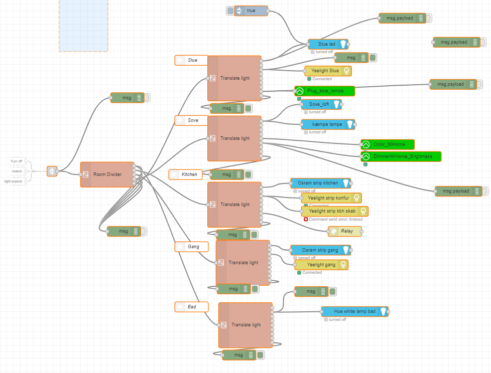

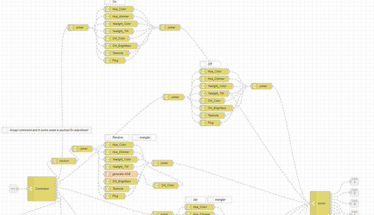

For thoes of you who are working with different types of light, e.g. yeelight, hue, tasmota ect. I have this small tool for handling the possible issues with different command for the types of light. It’s not finished but maybe you can use it as inspiration for your know flows. Some of it is in danish and some in english :smiley:
the conceptis that you send a msg.command and a msg.room to the node and then it get filtered out to the different lights. If you get more smarts lights you just add them to the tree.
The most interesting is the “translate light” which looks like this:
the code is here:
[{"id":"5bf24306.cd4b2c","type":"change","z":"28521005.9d89e","name":"Hue_Color","rules":[{"t":"set","p":"payload","pt":"msg","to":"true","tot":"bool"},{"t":"set","p":"LightType","pt":"msg","to":"Hue_Color","tot":"str"}],"action":"","property":"","from":"","to":"","reg":false,"x":610,"y":54,"wires":[["56917fa3.53353"]]},{"id":"6f814d24.659a64","type":"switch","z":"28521005.9d89e","name":"Command","property":"Command","propertyType":"msg","rules":[{"t":"eq","v":"ON","vt":"str"},{"t":"eq","v":"OFF","vt":"str"},{"t":"eq","v":"Random","vt":"str"},{"t":"eq","v":"Set","vt":"str"},{"t":"eq","v":"Color","vt":"str"},{"t":"eq","v":"Bri","vt":"str"},{"t":"eq","v":"CT","vt":"str"},{"t":"else"}],"checkall":"true","repair":false,"outputs":8,"x":232,"y":936,"wires":[["9c53f3c9.0727a"],["b9f377de.0192b8"],["95bf090e.839608"],["5521817b.95783"],["95bac735.b1f998"],["174cfce2.2c13c3"],["e90d6a09.386898"],["e22a2477.ef2ee8"]]},{"id":"9ef1d920.e7bf68","type":"change","z":"28521005.9d89e","name":"Yeelight_Color","rules":[{"t":"set","p":"payload","pt":"msg","to":"{\"on\":true}","tot":"json"},{"t":"set","p":"LightType","pt":"msg","to":"Yeelight_Color","tot":"str"}],"action":"","property":"","from":"","to":"","reg":false,"x":620,"y":126,"wires":[["56917fa3.53353"]]},{"id":"4bcdd744.2c2808","type":"change","z":"28521005.9d89e","name":"Hue_Color","rules":[{"t":"set","p":"payload","pt":"msg","to":"false","tot":"bool"},{"t":"set","p":"LightType","pt":"msg","to":"Hue_Color","tot":"str"}],"action":"","property":"","from":"","to":"","reg":false,"x":1078,"y":360,"wires":[["67d29b4c.2867d4"]]},{"id":"5a5eb155.268f2","type":"change","z":"28521005.9d89e","name":"Yeelight_Color","rules":[{"t":"set","p":"payload","pt":"msg","to":"{\"on\":false}","tot":"json"},{"t":"set","p":"LightType","pt":"msg","to":"Yeelight_Color","tot":"str"}],"action":"","property":"","from":"","to":"","reg":false,"x":1088,"y":432,"wires":[["67d29b4c.2867d4"]]},{"id":"b7487310.95525","type":"change","z":"28521005.9d89e","name":"Hue_Color","rules":[{"t":"set","p":"payload","pt":"msg","to":"","tot":"str"},{"t":"set","p":"LightType","pt":"msg","to":"Hue_Color","tot":"str"}],"action":"","property":"","from":"","to":"","reg":false,"x":1006,"y":1026,"wires":[["e7eb3c5f.5c6d4"]]},{"id":"4028424c.ade73c","type":"change","z":"28521005.9d89e","name":"Yeelight_Color","rules":[{"t":"set","p":"LightType","pt":"msg","to":"Yeelight_Color","tot":"str"}],"action":"","property":"","from":"","to":"","reg":false,"x":1016,"y":1098,"wires":[["e7eb3c5f.5c6d4"]]},{"id":"e4f98d49.b2707","type":"change","z":"28521005.9d89e","name":"Tasmota","rules":[{"t":"set","p":"payload","pt":"msg","to":"http://192.168.1.116/cm?cmnd=POWER ON","tot":"str"},{"t":"set","p":"LightType","pt":"msg","to":"Tasmota","tot":"str"}],"action":"","property":"","from":"","to":"","reg":false,"x":996,"y":1242,"wires":[["e7eb3c5f.5c6d4"]]},{"id":"5f1cc279.822a9c","type":"change","z":"28521005.9d89e","name":"Plug","rules":[{"t":"set","p":"payload","pt":"msg","to":"ON","tot":"str"},{"t":"set","p":"LightType","pt":"msg","to":"Plug","tot":"str"}],"action":"","property":"","from":"","to":"","reg":false,"x":590,"y":306,"wires":[["56917fa3.53353"]]},{"id":"66ab9427.0500fc","type":"change","z":"28521005.9d89e","name":"Plug","rules":[{"t":"set","p":"payload","pt":"msg","to":"OFF","tot":"str"},{"t":"set","p":"LightType","pt":"msg","to":"Plug","tot":"str"}],"action":"","property":"","from":"","to":"","reg":false,"x":1058,"y":612,"wires":[["67d29b4c.2867d4"]]},{"id":"cbccaa8c.2b3818","type":"change","z":"28521005.9d89e","name":"Plug","rules":[{"t":"set","p":"payload","pt":"msg","to":"","tot":"str"},{"t":"set","p":"LightType","pt":"msg","to":"Plug","tot":"str"}],"action":"","property":"","from":"","to":"","reg":false,"x":986,"y":1278,"wires":[["e7eb3c5f.5c6d4"]]},{"id":"21f4d382.de161c","type":"change","z":"28521005.9d89e","name":"Plug","rules":[{"t":"set","p":"payload","pt":"msg","to":"","tot":"str"},{"t":"set","p":"LightType","pt":"msg","to":"Plug","tot":"str"}],"action":"","property":"","from":"","to":"","reg":false,"x":572,"y":1656,"wires":[["a1d0917b.60f5a"]]},{"id":"9e50b7ee.840068","type":"change","z":"28521005.9d89e","name":"Plug","rules":[{"t":"set","p":"payload","pt":"msg","to":"OFF","tot":"str"},{"t":"set","p":"LightType","pt":"msg","to":"Plug","tot":"str"}],"action":"","property":"","from":"","to":"","reg":false,"x":1166,"y":1980,"wires":[["7f49d978.9db2c8"]]},{"id":"f362c72f.69eeb8","type":"change","z":"28521005.9d89e","name":"Plug","rules":[{"t":"set","p":"payload","pt":"msg","to":"ON","tot":"str"},{"t":"set","p":"LightType","pt":"msg","to":"Plug","tot":"str"}],"action":"","property":"","from":"","to":"","reg":false,"x":572,"y":2160,"wires":[["1142c587.c1640a"]]},{"id":"a205d9a6.ea16e8","type":"change","z":"28521005.9d89e","name":"Plug","rules":[{"t":"set","p":"payload","pt":"msg","to":"OFF","tot":"str"},{"t":"set","p":"LightType","pt":"msg","to":"Plug","tot":"str"}],"action":"","property":"","from":"","to":"","reg":false,"x":590,"y":972,"wires":[["8462c8eb.454938"]]},{"id":"8efe7bc2.ce9f58","type":"change","z":"28521005.9d89e","name":"Tasmota","rules":[{"t":"set","p":"url","pt":"msg","to":"http://192.168.1.116/cm?cmnd=POWER ON","tot":"str"},{"t":"set","p":"LightType","pt":"msg","to":"Tasmota","tot":"str"}],"action":"","property":"","from":"","to":"","reg":false,"x":600,"y":270,"wires":[["56917fa3.53353"]]},{"id":"9dc3fc4.80124","type":"change","z":"28521005.9d89e","name":"Tasmota","rules":[{"t":"set","p":"url","pt":"msg","to":"http://192.168.1.116/cm?cmnd=POWER OFF","tot":"str"},{"t":"set","p":"LightType","pt":"msg","to":"Tasmota","tot":"str"}],"action":"","property":"","from":"","to":"","reg":false,"x":1068,"y":576,"wires":[["67d29b4c.2867d4"]]},{"id":"9b21c5bf.78e398","type":"comment","z":"28521005.9d89e","name":"Random","info":"","x":600,"y":684,"wires":[]},{"id":"93442ff7.0ce29","type":"comment","z":"28521005.9d89e","name":"Off","info":"","x":1058,"y":324,"wires":[]},{"id":"e513d1e4.c1bdf","type":"comment","z":"28521005.9d89e","name":"On","info":"","x":590,"y":18,"wires":[]},{"id":"76b6c94e.7753c8","type":"comment","z":"28521005.9d89e","name":"Set","info":"","x":986,"y":990,"wires":[]},{"id":"bbe9303.a77ecd","type":"comment","z":"28521005.9d89e","name":"Color","info":"","x":572,"y":1368,"wires":[]},{"id":"6b45e890.13af68","type":"comment","z":"28521005.9d89e","name":"Brightness","info":"","x":1176,"y":1692,"wires":[]},{"id":"7e5c5a43.5e87e4","type":"comment","z":"28521005.9d89e","name":"Color Temp","info":"","x":592,"y":1944,"wires":[]},{"id":"3db2a9a2.60f8c6","type":"change","z":"28521005.9d89e","name":"Tasmota","rules":[{"t":"set","p":"url","pt":"msg","to":"http://192.168.1.116/cm?cmnd=POWER OFF","tot":"str"},{"t":"set","p":"LightType","pt":"msg","to":"LightType","tot":"str"}],"action":"","property":"","from":"","to":"","reg":false,"x":600,"y":936,"wires":[["8462c8eb.454938"]]},{"id":"99aaab46.1216c8","type":"change","z":"28521005.9d89e","name":"Tasmota","rules":[{"t":"set","p":"url","pt":"msg","to":"http://192.168.1.116/cm?cmnd=POWER OFF","tot":"str"},{"t":"set","p":"LightType","pt":"msg","to":"Tasmota","tot":"str"}],"action":"","property":"","from":"","to":"","reg":false,"x":1176,"y":1944,"wires":[["7f49d978.9db2c8"]]},{"id":"546c37ef.91f318","type":"change","z":"28521005.9d89e","name":"Tasmota","rules":[{"t":"set","p":"url","pt":"msg","to":"http://192.168.1.116/cm?cmnd=POWER ON","tot":"str"},{"t":"set","p":"LightType","pt":"msg","to":"Tasmota","tot":"str"}],"action":"","property":"","from":"","to":"","reg":false,"x":582,"y":1620,"wires":[["a1d0917b.60f5a"]]},{"id":"aa4d695c.cfd618","type":"change","z":"28521005.9d89e","name":"Tasmota","rules":[{"t":"set","p":"url","pt":"msg","to":"http://192.168.1.116/cm?cmnd=POWER ON","tot":"str"},{"t":"set","p":"LightType","pt":"msg","to":"Tasmota","tot":"str"}],"action":"","property":"","from":"","to":"","reg":false,"x":582,"y":2124,"wires":[["1142c587.c1640a"]]},{"id":"87e3ed51.450a2","type":"comment","z":"28521005.9d89e","name":"mangler","info":"","x":734,"y":684,"wires":[]},{"id":"d6e12de5.448c4","type":"comment","z":"28521005.9d89e","name":"mangler","info":"","x":1104,"y":990,"wires":[]},{"id":"93ceff83.0bfd5","type":"comment","z":"28521005.9d89e","name":"mangler","info":"","x":708,"y":1368,"wires":[]},{"id":"e22a2477.ef2ee8","type":"change","z":"28521005.9d89e","name":"","rules":[{"t":"set","p":"payload","pt":"msg","to":"Command not found","tot":"str"}],"action":"","property":"","from":"","to":"","reg":false,"x":224,"y":1080,"wires":[[]]},{"id":"bab92f31.43de7","type":"change","z":"28521005.9d89e","name":"Yeelight_Color","rules":[{"t":"set","p":"payload","pt":"msg","to":"0","tot":"str"},{"t":"set","p":"LightType","pt":"msg","to":"Yeelight_Color","tot":"str"}],"action":"","property":"","from":"","to":"","reg":false,"x":620,"y":792,"wires":[["8462c8eb.454938"]]},{"id":"753500e5.e7573","type":"function","z":"28521005.9d89e","name":"Hue_Color","func":"var SetTemp = \"\" + msg.payload;\n\nmsg.payload = \"{\\\"ct\\\":[\" + SetTemp + \"]}\";\nmsg.LightType = \"Hue_Color\"\nreturn msg;","outputs":1,"noerr":0,"x":592,"y":1980,"wires":[["e63f24f.f64bbd8"]]},{"id":"eb9a0b64.52ef08","type":"function","z":"28521005.9d89e","name":"Yeelight_Color","func":"var SetTemp = \"\" + msg.payload;\n\nmsg.payload = \"{\\\"ct\\\":\" + SetTemp + \"}\";\nmsg.LightType = \"Yeelight_Color\"\nreturn msg;","outputs":1,"noerr":0,"x":602,"y":2052,"wires":[["e63f24f.f64bbd8"]]},{"id":"f37744f4.2ce4e8","type":"function","z":"28521005.9d89e","name":"Hue_Color","func":"var SetTemp = \"\" + msg.payload;\n\nmsg.payload = \"{\\\"bri\\\":[\" + SetTemp + \"]}\";\nmsg.LightType = \"Hue_Color\"\nreturn msg;","outputs":1,"noerr":0,"x":1186,"y":1728,"wires":[["b8350a1.4b280f8"]]},{"id":"f6b287f5.8a5418","type":"function","z":"28521005.9d89e","name":"Yeelight_Color","func":"var SetTemp = \"\" + msg.payload;\n\nmsg.payload = \"{\\\"bri\\\":\" + SetTemp + \"}\";\nmsg.LightType = \"Yeelight_Color\"\nreturn msg;","outputs":1,"noerr":0,"x":1196,"y":1800,"wires":[["b8350a1.4b280f8"]]},{"id":"96beb6a8.a4d4b8","type":"function","z":"28521005.9d89e","name":"Hue_Color","func":"var SetTemp = \"\" + msg.payload;\n\nmsg.payload = \"{\\\"bri\\\":[\" + SetTemp + \"]}\";\nmsg.LightType = \"Hue_Color\"\nreturn msg;","outputs":1,"noerr":0,"x":592,"y":1404,"wires":[["23ba7040.c481"]]},{"id":"587af158.8b85c","type":"function","z":"28521005.9d89e","name":"Yeelight_Color","func":"var SetTemp = \"\" + msg.payload;\n\nmsg.payload = \"{\\\"bri\\\":\" + SetTemp + \"}\";\nmsg.LightType = \"Yeelight_Color\"\nreturn msg;","outputs":1,"noerr":0,"x":602,"y":1476,"wires":[["23ba7040.c481"]]},{"id":"acdef937.e020f8","type":"change","z":"28521005.9d89e","name":"Hue_dimmer","rules":[{"t":"set","p":"payload","pt":"msg","to":"true","tot":"bool"},{"t":"set","p":"LightType","pt":"msg","to":"Hue_Dimmer","tot":"str"}],"action":"","property":"","from":"","to":"","reg":false,"x":610,"y":90,"wires":[["56917fa3.53353"]]},{"id":"a840a473.774648","type":"change","z":"28521005.9d89e","name":"Yeelight_TW","rules":[{"t":"set","p":"payload","pt":"msg","to":"{\"on\":true}","tot":"json"},{"t":"set","p":"LightType","pt":"msg","to":"Yeelight_TW","tot":"str"}],"action":"","property":"","from":"","to":"","reg":false,"x":610,"y":162,"wires":[["56917fa3.53353"]]},{"id":"9c53f3c9.0727a","type":"change","z":"28521005.9d89e","name":"Joiner","rules":[{"t":"set","p":"payload","pt":"msg","to":"payload","tot":"msg"}],"action":"","property":"","from":"","to":"","reg":false,"x":410,"y":144,"wires":[["5bf24306.cd4b2c","acdef937.e020f8","9ef1d920.e7bf68","a840a473.774648","8efe7bc2.ce9f58","5f1cc279.822a9c","e233b14.1a8175","5a9584c4.076d3c"]]},{"id":"b9f377de.0192b8","type":"change","z":"28521005.9d89e","name":"Joiner","rules":[{"t":"set","p":"payload","pt":"msg","to":"payload","tot":"msg"}],"action":"","property":"","from":"","to":"","reg":false,"x":878,"y":486,"wires":[["4bcdd744.2c2808","5a5eb155.268f2","9dc3fc4.80124","66ab9427.0500fc","c30d27f3.847068","26a2788f.918678","d4a938ec.6c72e8","33527086.8e1ed"]]},{"id":"545f4e7c.5c57a","type":"change","z":"28521005.9d89e","name":"Joiner","rules":[{"t":"set","p":"payload","pt":"msg","to":"payload","tot":"msg"}],"action":"","property":"","from":"","to":"","reg":false,"x":430,"y":740,"wires":[["3db2a9a2.60f8c6","bab92f31.43de7","a205d9a6.ea16e8","67b75788.7f9f28","91b4cd17.393d3","5e9de635.db3988"]]},{"id":"5521817b.95783","type":"change","z":"28521005.9d89e","name":"Joiner","rules":[{"t":"set","p":"payload","pt":"msg","to":"payload","tot":"msg"}],"action":"","property":"","from":"","to":"","reg":false,"x":824,"y":1062,"wires":[["e4f98d49.b2707","b7487310.95525","f3db9c1.191a86","4028424c.ade73c","cbccaa8c.2b3818","2099e892.9d7548"]]},{"id":"95bac735.b1f998","type":"change","z":"28521005.9d89e","name":"Joiner","rules":[{"t":"set","p":"payload","pt":"msg","to":"payload","tot":"msg"}],"action":"","property":"","from":"","to":"","reg":false,"x":374,"y":1494,"wires":[["587af158.8b85c","96beb6a8.a4d4b8","55056d44.6b04a4","546c37ef.91f318","21f4d382.de161c","51877686.1b8e48","f8d56703.ed7b68","47e99e43.8ca3"]]},{"id":"174cfce2.2c13c3","type":"change","z":"28521005.9d89e","name":"Joiner","rules":[{"t":"set","p":"payload","pt":"msg","to":"payload","tot":"msg"}],"action":"","property":"","from":"","to":"","reg":false,"x":932,"y":1764,"wires":[["f6b287f5.8a5418","f37744f4.2ce4e8","8c59da4a.875358","707ffa75.feb324","cf8266e.fa55498"]]},{"id":"e90d6a09.386898","type":"change","z":"28521005.9d89e","name":"Joiner","rules":[{"t":"set","p":"payload","pt":"msg","to":"payload","tot":"msg"}],"action":"","property":"","from":"","to":"","reg":false,"x":410,"y":1998,"wires":[["753500e5.e7573","853c0ebe.ae867","eb9a0b64.52ef08","84bf8922.cb4428","aa4d695c.cfd618","f362c72f.69eeb8"]]},{"id":"c30d27f3.847068","type":"change","z":"28521005.9d89e","name":"Hue_Dimmer","rules":[{"t":"set","p":"payload","pt":"msg","to":"false","tot":"bool"},{"t":"set","p":"LightType","pt":"msg","to":"Hue_Dimmer","tot":"str"}],"action":"","property":"","from":"","to":"","reg":false,"x":1078,"y":396,"wires":[["67d29b4c.2867d4"]]},{"id":"26a2788f.918678","type":"change","z":"28521005.9d89e","name":"Yeelight_TW","rules":[{"t":"set","p":"payload","pt":"msg","to":"{\"on\":false}","tot":"json"},{"t":"set","p":"LightType","pt":"msg","to":"Yeelight_TW","tot":"str"}],"action":"","property":"","from":"","to":"","reg":false,"x":1078,"y":468,"wires":[["67d29b4c.2867d4"]]},{"id":"67b75788.7f9f28","type":"change","z":"28521005.9d89e","name":"Hue_Dimmer","rules":[{"t":"set","p":"payload","pt":"msg","to":"OFF","tot":"str"},{"t":"set","p":"LightType","pt":"msg","to":"Hue_Dimmer","tot":"str"}],"action":"","property":"","from":"","to":"","reg":false,"x":610,"y":756,"wires":[["8462c8eb.454938"]]},{"id":"91b4cd17.393d3","type":"change","z":"28521005.9d89e","name":"Yeelight_TW","rules":[{"t":"set","p":"payload","pt":"msg","to":"OFF","tot":"str"},{"t":"set","p":"LightType","pt":"msg","to":"Yeelight_TW","tot":"str"}],"action":"","property":"","from":"","to":"","reg":false,"x":610,"y":828,"wires":[["8462c8eb.454938"]]},{"id":"f3db9c1.191a86","type":"change","z":"28521005.9d89e","name":"Hue_Dimmer","rules":[{"t":"set","p":"LightType","pt":"msg","to":"Hue_Dimmer","tot":"str"}],"action":"","property":"","from":"","to":"","reg":false,"x":1006,"y":1062,"wires":[["e7eb3c5f.5c6d4"]]},{"id":"2099e892.9d7548","type":"change","z":"28521005.9d89e","name":"Yeelight_TW","rules":[{"t":"set","p":"payload","pt":"msg","to":"","tot":"str"},{"t":"set","p":"LightType","pt":"msg","to":"Yeelight_TW","tot":"str"}],"action":"","property":"","from":"","to":"","reg":false,"x":1006,"y":1134,"wires":[["e7eb3c5f.5c6d4"]]},{"id":"51877686.1b8e48","type":"function","z":"28521005.9d89e","name":"Hue_Dimmer","func":"var SetTemp = \"\" + msg.payload;\n\nmsg.payload = \"{\\\"bri\\\":[\" + SetTemp + \"]}\";\nmsg.LightType = \"Hue_Dimmer\"\nreturn msg;","outputs":1,"noerr":0,"x":592,"y":1440,"wires":[["23ba7040.c481"]]},{"id":"55056d44.6b04a4","type":"function","z":"28521005.9d89e","name":"Yeelight_TW","func":"var SetTemp = \"\" + msg.payload;\n\nmsg.payload = \"{\\\"bri\\\":\" + SetTemp + \"}\";\nmsg.LightType = \"Yeelight_TW\"\nreturn msg;","outputs":1,"noerr":0,"x":592,"y":1512,"wires":[["23ba7040.c481"]]},{"id":"8c59da4a.875358","type":"function","z":"28521005.9d89e","name":"Hue_Dimmer","func":"var SetTemp = \"\" + msg.payload;\n\nmsg.payload = \"{\\\"bri\\\":\" + SetTemp + \"}\";\nmsg.LightType = \"Hue_Dimmer\"\nreturn msg;","outputs":1,"noerr":0,"x":1186,"y":1764,"wires":[["b8350a1.4b280f8"]]},{"id":"707ffa75.feb324","type":"function","z":"28521005.9d89e","name":"Yeelight_TW","func":"var SetTemp = \"\" + msg.payload;\n\nmsg.payload = \"{\\\"bri\\\":\" + SetTemp + \"}\";\nmsg.LightType = \"Yeelight_TW\"\nreturn msg;","outputs":1,"noerr":0,"x":1186,"y":1836,"wires":[["b8350a1.4b280f8"]]},{"id":"853c0ebe.ae867","type":"function","z":"28521005.9d89e","name":"Hue_Dimmer","func":"var SetTemp = \"\" + msg.payload;\n\nmsg.payload = \"{\\\"ct\\\":[\" + SetTemp + \"]}\";\nmsg.LightType = \"Hue_Dimmer\"\nreturn msg;","outputs":1,"noerr":0,"x":592,"y":2016,"wires":[["e63f24f.f64bbd8"]]},{"id":"84bf8922.cb4428","type":"function","z":"28521005.9d89e","name":"Yeelight_TW","func":"var SetTemp = \"\" + msg.payload;\n\nmsg.payload = \"{\\\"ct\\\":\" + SetTemp + \"}\";\nmsg.LightType = \"Yeelight_TW\"\nreturn msg;","outputs":1,"noerr":0,"x":592,"y":2088,"wires":[["e63f24f.f64bbd8"]]},{"id":"8c3b48dc.ad6b28","type":"switch","z":"28521005.9d89e","name":"","property":"LightType","propertyType":"msg","rules":[{"t":"eq","v":"Hue_Color","vt":"str"},{"t":"eq","v":"Hue_Dimmer","vt":"str"},{"t":"eq","v":"Yeelight_Color","vt":"str"},{"t":"eq","v":"Yeelight_TW","vt":"str"},{"t":"eq","v":"OH_Color","vt":"str"},{"t":"eq","v":"OH_Brightless","vt":"str"},{"t":"eq","v":"Tasmota","vt":"str"},{"t":"eq","v":"Plug","vt":"str"}],"checkall":"true","repair":false,"outputs":8,"x":1598,"y":1008,"wires":[[],[],[],[],[],[],[],[]]},{"id":"56917fa3.53353","type":"change","z":"28521005.9d89e","name":"Joiner","rules":[{"t":"set","p":"payload","pt":"msg","to":"payload","tot":"msg"}],"action":"","property":"","from":"","to":"","reg":false,"x":860,"y":144,"wires":[["8c3b48dc.ad6b28"]]},{"id":"67d29b4c.2867d4","type":"change","z":"28521005.9d89e","name":"Joiner","rules":[{"t":"set","p":"payload","pt":"msg","to":"payload","tot":"msg"}],"action":"","property":"","from":"","to":"","reg":false,"x":1310,"y":432,"wires":[["8c3b48dc.ad6b28"]]},{"id":"8462c8eb.454938","type":"change","z":"28521005.9d89e","name":"Joiner","rules":[{"t":"set","p":"payload","pt":"msg","to":"payload","tot":"msg"}],"action":"","property":"","from":"","to":"","reg":false,"x":824,"y":810,"wires":[["8c3b48dc.ad6b28"]]},{"id":"e7eb3c5f.5c6d4","type":"change","z":"28521005.9d89e","name":"Joiner","rules":[{"t":"set","p":"payload","pt":"msg","to":"payload","tot":"msg"}],"action":"","property":"","from":"","to":"","reg":false,"x":1239.0234375,"y":1127.0546875,"wires":[["8c3b48dc.ad6b28"]]},{"id":"a1d0917b.60f5a","type":"change","z":"28521005.9d89e","name":"Joiner","rules":[{"t":"set","p":"payload","pt":"msg","to":"payload","tot":"msg"}],"action":"","property":"","from":"","to":"","reg":false,"x":842,"y":1476,"wires":[["8c3b48dc.ad6b28"]]},{"id":"7f49d978.9db2c8","type":"change","z":"28521005.9d89e","name":"Joiner","rules":[{"t":"set","p":"payload","pt":"msg","to":"payload","tot":"msg"}],"action":"","property":"","from":"","to":"","reg":false,"x":1490,"y":1782,"wires":[["8c3b48dc.ad6b28"]]},{"id":"1142c587.c1640a","type":"change","z":"28521005.9d89e","name":"Joiner","rules":[{"t":"set","p":"payload","pt":"msg","to":"payload","tot":"msg"}],"action":"","property":"","from":"","to":"","reg":false,"x":842,"y":2052,"wires":[["8c3b48dc.ad6b28"]]},{"id":"e233b14.1a8175","type":"change","z":"28521005.9d89e","name":"OH_Color","rules":[{"t":"set","p":"payload","pt":"msg","to":"ON","tot":"str"},{"t":"set","p":"LightType","pt":"msg","to":"OH_Color","tot":"str"}],"action":"","property":"","from":"","to":"","reg":false,"x":600,"y":198,"wires":[["56917fa3.53353"]]},{"id":"5a9584c4.076d3c","type":"change","z":"28521005.9d89e","name":"OH_Brightless","rules":[{"t":"set","p":"payload","pt":"msg","to":"ON","tot":"str"},{"t":"set","p":"LightType","pt":"msg","to":"OH_Brightless","tot":"str"}],"action":"","property":"","from":"","to":"","reg":false,"x":620,"y":234,"wires":[["56917fa3.53353"]]},{"id":"d4a938ec.6c72e8","type":"change","z":"28521005.9d89e","name":"OH_Color","rules":[{"t":"set","p":"payload","pt":"msg","to":"OFF","tot":"str"},{"t":"set","p":"LightType","pt":"msg","to":"OH_Color","tot":"str"}],"action":"","property":"","from":"","to":"","reg":false,"x":1068,"y":504,"wires":[["67d29b4c.2867d4"]]},{"id":"33527086.8e1ed","type":"change","z":"28521005.9d89e","name":"OH_Brightless","rules":[{"t":"set","p":"payload","pt":"msg","to":"OFF","tot":"str"},{"t":"set","p":"LightType","pt":"msg","to":"OH_Brightless","tot":"str"}],"action":"","property":"","from":"","to":"","reg":false,"x":1088,"y":540,"wires":[["67d29b4c.2867d4"]]},{"id":"f7a083b6.ea3a5","type":"change","z":"28521005.9d89e","name":"OH_Color","rules":[{"t":"set","p":"payload","pt":"msg","to":"ON","tot":"str"},{"t":"set","p":"LightType","pt":"msg","to":"OH_Color","tot":"str"}],"action":"","property":"","from":"","to":"","reg":false,"x":840,"y":920,"wires":[["8462c8eb.454938"]]},{"id":"758014a1.72d8dc","type":"change","z":"28521005.9d89e","name":"OH_Brightless","rules":[{"t":"set","p":"payload","pt":"msg","to":"OFF","tot":"str"},{"t":"set","p":"LightType","pt":"msg","to":"OH_Brightless","tot":"str"}],"action":"","property":"","from":"","to":"","reg":false,"x":620,"y":900,"wires":[[]]},{"id":"1816073f.d67739","type":"change","z":"28521005.9d89e","name":"OH_Color","rules":[{"t":"set","p":"payload","pt":"msg","to":"ON","tot":"str"},{"t":"set","p":"LightType","pt":"msg","to":"OH_Color","tot":"str"}],"action":"","property":"","from":"","to":"","reg":false,"x":996,"y":1170,"wires":[["e7eb3c5f.5c6d4"]]},{"id":"8f775656.a6bb68","type":"change","z":"28521005.9d89e","name":"OH_Brightless","rules":[{"t":"set","p":"payload","pt":"msg","to":"ON","tot":"str"},{"t":"set","p":"LightType","pt":"msg","to":"OH_Brightless","tot":"str"}],"action":"","property":"","from":"","to":"","reg":false,"x":1016,"y":1206,"wires":[["e7eb3c5f.5c6d4"]]},{"id":"f8d56703.ed7b68","type":"change","z":"28521005.9d89e","name":"OH_Color","rules":[{"t":"set","p":"payload","pt":"msg","to":"ON","tot":"str"},{"t":"set","p":"LightType","pt":"msg","to":"OH_Color","tot":"str"}],"action":"","property":"","from":"","to":"","reg":false,"x":582,"y":1548,"wires":[["a1d0917b.60f5a"]]},{"id":"47e99e43.8ca3","type":"change","z":"28521005.9d89e","name":"OH_Brightless","rules":[{"t":"set","p":"payload","pt":"msg","to":"ON","tot":"str"},{"t":"set","p":"LightType","pt":"msg","to":"OH_Brightless","tot":"str"}],"action":"","property":"","from":"","to":"","reg":false,"x":520,"y":1560,"wires":[["a1d0917b.60f5a"]]},{"id":"b71eead5.70ac68","type":"comment","z":"28521005.9d89e","name":"Accept command and in some cases a payload for adjustment","info":"","x":256,"y":648,"wires":[]},{"id":"b8350a1.4b280f8","type":"json","z":"28521005.9d89e","name":"","property":"payload","action":"","pretty":false,"x":1346,"y":1764,"wires":[["7f49d978.9db2c8"]]},{"id":"e63f24f.f64bbd8","type":"json","z":"28521005.9d89e","name":"","property":"payload","action":"","pretty":false,"x":770,"y":1980,"wires":[["1142c587.c1640a"]]},{"id":"23ba7040.c481","type":"json","z":"28521005.9d89e","name":"","property":"payload","action":"","pretty":false,"x":870,"y":1400,"wires":[["a1d0917b.60f5a"]]},{"id":"29eec645.5e779a","type":"change","z":"28521005.9d89e","name":"Plug","rules":[{"t":"set","p":"payload","pt":"msg","to":"ON","tot":"str"},{"t":"set","p":"LightType","pt":"msg","to":"Plug","tot":"str"}],"action":"","property":"","from":"","to":"","reg":false,"x":1166,"y":1908,"wires":[["7f49d978.9db2c8"]]},{"id":"c4630e7f.dbc8a","type":"change","z":"28521005.9d89e","name":"Tasmota","rules":[{"t":"set","p":"url","pt":"msg","to":"http://192.168.1.116/cm?cmnd=POWER ON","tot":"str"},{"t":"set","p":"LightType","pt":"msg","to":"Tasmota","tot":"str"}],"action":"","property":"","from":"","to":"","reg":false,"x":1176,"y":1872,"wires":[["7f49d978.9db2c8"]]},{"id":"cf8266e.fa55498","type":"switch","z":"28521005.9d89e","name":"","property":"payload","propertyType":"msg","rules":[{"t":"neq","v":"0","vt":"str"},{"t":"eq","v":"0","vt":"str"}],"checkall":"true","repair":false,"outputs":2,"x":1004,"y":1908,"wires":[["c4630e7f.dbc8a","29eec645.5e779a"],["99aaab46.1216c8","9e50b7ee.840068"]]},{"id":"5e9de635.db3988","type":"change","z":"28521005.9d89e","name":"Hue_Color","rules":[{"t":"set","p":"payload","pt":"msg","to":"{\"effect\":[\"none\"]}","tot":"str"},{"t":"set","p":"LightType","pt":"msg","to":"Hue_Color","tot":"str"}],"action":"","property":"","from":"","to":"","reg":false,"x":610,"y":720,"wires":[["8462c8eb.454938"]]},{"id":"4b59365a.0a0858","type":"function","z":"28521005.9d89e","name":"generate HSB","func":"var Hue = msg.payload;\n\n\nvar HSB = Hue + \",\" + \"100\" + \",\" + \"40\";\n\n\nmsg.payload = HSB;\n\nnode.status({fill:\"green\",shape:\"ring\",text: msg.payload});\nreturn msg;","outputs":1,"noerr":0,"x":620,"y":864,"wires":[["f7a083b6.ea3a5"]]},{"id":"24414da5.e62342","type":"comment","z":"28521005.9d89e","name":"Mangler omskrivning så det passer til begge ","info":"","x":674,"y":1890,"wires":[]},{"id":"95bf090e.839608","type":"random","z":"28521005.9d89e","name":"","low":"0","high":"255","inte":"true","property":"payload","x":340,"y":800,"wires":[["545f4e7c.5c57a"]]}]

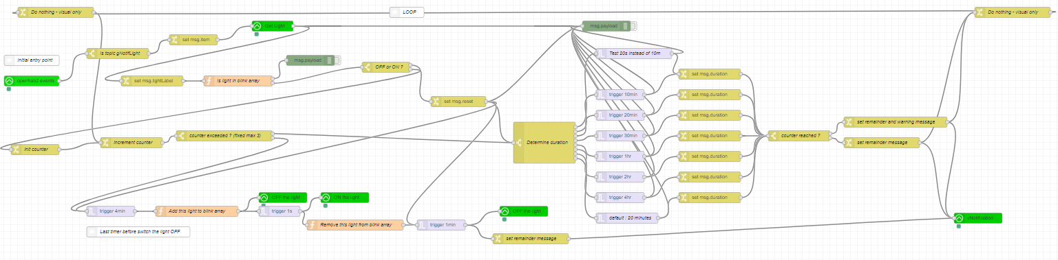

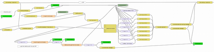

Here is a workflow for timed lights with notification.
Read the first post about notification.

Here is the workflow :
And the code :
[{"id":"fea6c6ef.fe6498","type":"tab","label":"Timer light switched ON test","disabled":false,"info":""},{"id":"58689464.f2402c","type":"switch","z":"fea6c6ef.fe6498","name":"OFF or ON ?","property":"payload.state","propertyType":"msg","rules":[{"t":"eq","v":"OFF","vt":"str"},{"t":"eq","v":"ON","vt":"str"}],"checkall":"false","repair":false,"outputs":2,"x":1130,"y":200,"wires":[["406465f.f45499c"],["54eea94d.704b48"]]},{"id":"878f2576.5d1638","type":"openhab2-out","z":"fea6c6ef.fe6498","name":"","controller":"996bcc70.92a13","itemname":"vNotification","topic":"ItemUpdate","payload":"","x":2850,"y":640,"wires":[]},{"id":"bb8672e7.03592","type":"change","z":"fea6c6ef.fe6498","name":"set remainder message","rules":[{"t":"set","p":"payload","pt":"msg","to":"(\t   \"la lampe \\\"\" & msg.lightLabel & \"\\\" est allumée depuis \" & (msg.duration * msg.counter) & \" minutes\"\t)","tot":"jsonata"}],"action":"","property":"","from":"","to":"","reg":false,"x":2570,"y":420,"wires":[["878f2576.5d1638","cf6d8246.7a408"]]},{"id":"406465f.f45499c","type":"change","z":"fea6c6ef.fe6498","name":"","rules":[{"t":"set","p":"reset","pt":"msg","to":"true","tot":"str"}],"action":"","property":"","from":"","to":"","reg":false,"x":1340,"y":300,"wires":[["dc370934.3f0288","213c7080.86575","66ae31ef.35003","ff49fa1c.bc4dd8"]]},{"id":"fb5a1558.81c508","type":"openhab2-events","z":"fea6c6ef.fe6498","name":"","controller":"996bcc70.92a13","itemname":"","x":100,"y":240,"wires":[["40313d5c.7a0c74"]]},{"id":"40313d5c.7a0c74","type":"switch","z":"fea6c6ef.fe6498","name":"Is topic gNotifLight","property":"topic","propertyType":"msg","rules":[{"t":"cont","v":"gNotifLight","vt":"str"}],"checkall":"true","repair":false,"outputs":1,"x":350,"y":160,"wires":[["f9234191.eaecd"]]},{"id":"f9234191.eaecd","type":"change","z":"fea6c6ef.fe6498","name":"","rules":[{"t":"set","p":"item","pt":"msg","to":"(\t   $arr := $split(msg.topic, '/', limit);\t   $arr[-2]\t\t)\t","tot":"jsonata"}],"action":"","property":"","from":"","to":"","reg":false,"x":570,"y":120,"wires":[["7af6707b.e21a4"]]},{"id":"7af6707b.e21a4","type":"openhab2-get","z":"fea6c6ef.fe6498","name":"Get Light","controller":"996bcc70.92a13","itemname":"","x":800,"y":80,"wires":[["dc370934.3f0288","32475087.693c5"]]},{"id":"dc370934.3f0288","type":"debug","z":"fea6c6ef.fe6498","name":"","active":false,"tosidebar":true,"console":false,"tostatus":false,"complete":"false","x":1770,"y":80,"wires":[]},{"id":"213c7080.86575","type":"switch","z":"fea6c6ef.fe6498","name":"Determine duration","property":"topic","propertyType":"msg","rules":[{"t":"cont","v":"gNotifLight10s","vt":"str"},{"t":"cont","v":"gNotifLight10m","vt":"str"},{"t":"cont","v":"gNotifLight20m","vt":"str"},{"t":"cont","v":"gNotifLight30m","vt":"str"},{"t":"cont","v":"gNotifLight1h","vt":"str"},{"t":"cont","v":"gNotifLight2h","vt":"str"},{"t":"cont","v":"gNotifLight4h","vt":"str"},{"t":"else"}],"checkall":"false","repair":false,"outputs":8,"x":1590,"y":420,"wires":[["c6b25632.c19ca8"],["27c2ffba.3a3a8"],["ca4f6d4f.85e1d"],["b8c8fa98.763968"],["4f3f1d4c.ba18f4"],["cf02b188.5989a"],["831427f8.341cb8"],["3642ccf3.4d8844"]]},{"id":"27c2ffba.3a3a8","type":"trigger","z":"fea6c6ef.fe6498","op1":"","op2":"","op1type":"nul","op2type":"payl","duration":"10","extend":false,"units":"min","reset":"","bytopic":"topic","name":"","x":1810,"y":280,"wires":[["dc370934.3f0288","9de818ab.dd4868"]]},{"id":"ca4f6d4f.85e1d","type":"trigger","z":"fea6c6ef.fe6498","op1":"","op2":"","op1type":"nul","op2type":"payl","duration":"20","extend":false,"units":"min","reset":"","bytopic":"topic","name":"","x":1810,"y":340,"wires":[["dc370934.3f0288","b3c3fb05.c0a8e8"]]},{"id":"b8c8fa98.763968","type":"trigger","z":"fea6c6ef.fe6498","op1":"","op2":"","op1type":"nul","op2type":"payl","duration":"30","extend":false,"units":"min","reset":"","bytopic":"topic","name":"","x":1810,"y":400,"wires":[["dc370934.3f0288","97adcf2f.93f04"]]},{"id":"4f3f1d4c.ba18f4","type":"trigger","z":"fea6c6ef.fe6498","op1":"","op2":"","op1type":"nul","op2type":"payl","duration":"1","extend":false,"units":"hr","reset":"","bytopic":"topic","name":"","x":1810,"y":460,"wires":[["dc370934.3f0288","29160e89.4aaeb2"]]},{"id":"cf02b188.5989a","type":"trigger","z":"fea6c6ef.fe6498","op1":"","op2":"","op1type":"nul","op2type":"payl","duration":"2","extend":false,"units":"hr","reset":"","bytopic":"topic","name":"","x":1810,"y":520,"wires":[["dc370934.3f0288","454d3363.493d7c"]]},{"id":"831427f8.341cb8","type":"trigger","z":"fea6c6ef.fe6498","op1":"","op2":"","op1type":"nul","op2type":"payl","duration":"4","extend":false,"units":"hr","reset":"","bytopic":"topic","name":"","x":1810,"y":580,"wires":[["dc370934.3f0288","5f5adc4f.9f1a74"]]},{"id":"3642ccf3.4d8844","type":"trigger","z":"fea6c6ef.fe6498","op1":"","op2":"","op1type":"nul","op2type":"payl","duration":"20","extend":false,"units":"min","reset":"","bytopic":"topic","name":"default : 20 minutes","x":1830,"y":640,"wires":[["dc370934.3f0288","36f67639.06eaaa"]]},{"id":"6b036470.1f042c","type":"change","z":"fea6c6ef.fe6498","name":"Do nothing - visual only","rules":[{"t":"set","p":"nothing","pt":"msg","to":"","tot":"str"}],"action":"","property":"","from":"","to":"","reg":false,"x":170,"y":40,"wires":[["a8817359.5cbf1"]]},{"id":"9de818ab.dd4868","type":"change","z":"fea6c6ef.fe6498","name":"","rules":[{"t":"set","p":"duration","pt":"msg","to":"10","tot":"num"}],"action":"","property":"","from":"","to":"","reg":false,"x":2070,"y":220,"wires":[["5d29e82f.f08a68"]]},{"id":"b3c3fb05.c0a8e8","type":"change","z":"fea6c6ef.fe6498","name":"","rules":[{"t":"set","p":"duration","pt":"msg","to":"20","tot":"num"}],"action":"","property":"","from":"","to":"","reg":false,"x":2070,"y":280,"wires":[["5d29e82f.f08a68"]]},{"id":"97adcf2f.93f04","type":"change","z":"fea6c6ef.fe6498","name":"","rules":[{"t":"set","p":"duration","pt":"msg","to":"30","tot":"num"}],"action":"","property":"","from":"","to":"","reg":false,"x":2070,"y":340,"wires":[["5d29e82f.f08a68"]]},{"id":"29160e89.4aaeb2","type":"change","z":"fea6c6ef.fe6498","name":"","rules":[{"t":"set","p":"duration","pt":"msg","to":"60","tot":"num"}],"action":"","property":"","from":"","to":"","reg":false,"x":2070,"y":400,"wires":[["5d29e82f.f08a68"]]},{"id":"454d3363.493d7c","type":"change","z":"fea6c6ef.fe6498","name":"","rules":[{"t":"set","p":"duration","pt":"msg","to":"120","tot":"num"}],"action":"","property":"","from":"","to":"","reg":false,"x":2070,"y":460,"wires":[["5d29e82f.f08a68"]]},{"id":"5f5adc4f.9f1a74","type":"change","z":"fea6c6ef.fe6498","name":"","rules":[{"t":"set","p":"duration","pt":"msg","to":"240","tot":"num"}],"action":"","property":"","from":"","to":"","reg":false,"x":2070,"y":520,"wires":[["5d29e82f.f08a68"]]},{"id":"36f67639.06eaaa","type":"change","z":"fea6c6ef.fe6498","name":"","rules":[{"t":"set","p":"duration","pt":"msg","to":"20","tot":"num"}],"action":"","property":"","from":"","to":"","reg":false,"x":2070,"y":580,"wires":[["5d29e82f.f08a68"]]},{"id":"a8817359.5cbf1","type":"change","z":"fea6c6ef.fe6498","name":"increment counter","rules":[{"t":"set","p":"counter","pt":"msg","to":"msg.counter + 1","tot":"jsonata"}],"action":"","property":"","from":"","to":"","reg":false,"x":390,"y":420,"wires":[["52f9687a.42bb58"]]},{"id":"54eea94d.704b48","type":"change","z":"fea6c6ef.fe6498","name":"init counter","rules":[{"t":"set","p":"counter","pt":"msg","to":"0","tot":"num"}],"action":"","property":"","from":"","to":"","reg":false,"x":110,"y":440,"wires":[["a8817359.5cbf1"]]},{"id":"cf6d8246.7a408","type":"change","z":"fea6c6ef.fe6498","name":"Do nothing - visual only","rules":[{"t":"set","p":"nothing","pt":"msg","to":"","tot":"str"}],"action":"","property":"","from":"","to":"","reg":false,"x":2950,"y":40,"wires":[["6b036470.1f042c"]]},{"id":"c6b25632.c19ca8","type":"trigger","z":"fea6c6ef.fe6498","op1":"","op2":"","op1type":"nul","op2type":"payl","duration":"20","extend":false,"units":"s","reset":"","bytopic":"topic","name":"Test 20s instead of 10m","x":1850,"y":160,"wires":[["9de818ab.dd4868","dc370934.3f0288"]]},{"id":"d6b886a6.1bdc78","type":"function","z":"fea6c6ef.fe6498","name":"Add this light to blink array","func":"var blink = flow.get(\"blink\")||[];\nblink.push(msg.lightLabel);\nflow.set(\"blink\", blink);\nreturn msg;","outputs":1,"noerr":0,"x":580,"y":620,"wires":[["9d22d84e.c3fc48","278ee60f.a096ca"]]},{"id":"52f9687a.42bb58","type":"switch","z":"fea6c6ef.fe6498","name":"counter exceeded ? (fixed max 3)","property":"counter","propertyType":"msg","rules":[{"t":"else"},{"t":"gte","v":"3","vt":"num"}],"checkall":"true","repair":false,"outputs":2,"x":660,"y":400,"wires":[["213c7080.86575"],["66ae31ef.35003"]]},{"id":"66ae31ef.35003","type":"trigger","z":"fea6c6ef.fe6498","op1":"","op2":"","op1type":"nul","op2type":"payl","duration":"4","extend":false,"units":"min","reset":"","bytopic":"topic","name":"","x":330,"y":620,"wires":[["d6b886a6.1bdc78"]]},{"id":"5d29e82f.f08a68","type":"switch","z":"fea6c6ef.fe6498","name":"counter reached ?","property":"counter","propertyType":"msg","rules":[{"t":"eq","v":"2","vt":"num"},{"t":"else"}],"checkall":"true","repair":false,"outputs":2,"x":2330,"y":400,"wires":[["a66e7547.8f2cc8"],["bb8672e7.03592"]]},{"id":"a66e7547.8f2cc8","type":"change","z":"fea6c6ef.fe6498","name":"set remainder and warning message","rules":[{"t":"set","p":"payload","pt":"msg","to":"(\t   \"la lampe \\\"\" & msg.lightLabel & \"\\\" est allumée depuis \" & (msg.duration * msg.counter) & \" minutes et sera éteinte dans 5 minutes\"\t)","tot":"jsonata"}],"action":"","property":"","from":"","to":"","reg":false,"x":2610,"y":360,"wires":[["cf6d8246.7a408","878f2576.5d1638"]]},{"id":"9d22d84e.c3fc48","type":"openhab2-out","z":"fea6c6ef.fe6498","name":"OFF the light","controller":"996bcc70.92a13","itemname":"","topic":"ItemCommand","payload":"OFF","x":830,"y":580,"wires":[]},{"id":"278ee60f.a096ca","type":"trigger","z":"fea6c6ef.fe6498","op1":"","op2":"","op1type":"nul","op2type":"payl","duration":"1","extend":false,"units":"s","reset":"","bytopic":"topic","name":"","x":820,"y":620,"wires":[["d08cbb4b.429b88","28b238b6.232878"]]},{"id":"ff49fa1c.bc4dd8","type":"trigger","z":"fea6c6ef.fe6498","op1":"","op2":"","op1type":"nul","op2type":"payl","duration":"1","extend":false,"units":"min","reset":"","bytopic":"topic","name":"","x":1290,"y":660,"wires":[["f76d93c8.d8a0e","da91dd84.f4541"]]},{"id":"d08cbb4b.429b88","type":"openhab2-out","z":"fea6c6ef.fe6498","name":"ON the light","controller":"996bcc70.92a13","itemname":"","topic":"ItemCommand","payload":"ON","x":1010,"y":580,"wires":[]},{"id":"f76d93c8.d8a0e","type":"openhab2-out","z":"fea6c6ef.fe6498","name":"OFF the light","controller":"996bcc70.92a13","itemname":"","topic":"ItemCommand","payload":"OFF","x":1530,"y":620,"wires":[]},{"id":"28b238b6.232878","type":"function","z":"fea6c6ef.fe6498","name":"Remove this light from blink array","func":"var blink = flow.get(\"blink\")||[];\nblink = blink.filter(function (value, index, array){\n   return value != msg.lightLabel; \n}) \nflow.set(\"blink\", blink);\nreturn msg;","outputs":1,"noerr":0,"x":1040,"y":660,"wires":[["ff49fa1c.bc4dd8"]]},{"id":"da91dd84.f4541","type":"change","z":"fea6c6ef.fe6498","name":"set remainder message","rules":[{"t":"set","p":"payload","pt":"msg","to":"(\t   \"la lampe \\\"\" & msg.lightLabel & \"\\\" a été automatiquement éteinte après une durée de \" & (msg.duration * msg.counter) & \" minutes\"\t)","tot":"jsonata"}],"action":"","property":"","from":"","to":"","reg":false,"x":1550,"y":700,"wires":[["878f2576.5d1638"]]},{"id":"82044f04.81a8c","type":"function","z":"fea6c6ef.fe6498","name":"Is light in blink array","func":"var blink = flow.get(\"blink\")||[];\nvar isInArray = false;\nif (blink.length > 0){\n    isInArray = blink.filter(function (value, index, array){\n       return value == msg.lightLabel; \n    })\n}\nif (isInArray) {\n    return [msg, null];\n}\nelse {\n    return [null, msg];\n}","outputs":2,"noerr":0,"x":700,"y":240,"wires":[["e4befec2.56f5e"],["58689464.f2402c"]]},{"id":"32475087.693c5","type":"change","z":"fea6c6ef.fe6498","name":"","rules":[{"t":"set","p":"lightLabel","pt":"msg","to":"payload.label","tot":"msg"}],"action":"","property":"","from":"","to":"","reg":false,"x":450,"y":240,"wires":[["82044f04.81a8c"]]},{"id":"e4befec2.56f5e","type":"debug","z":"fea6c6ef.fe6498","name":"","active":false,"tosidebar":true,"console":false,"tostatus":false,"complete":"false","x":910,"y":180,"wires":[]},{"id":"fb5c61ae.47d1b","type":"comment","z":"fea6c6ef.fe6498","name":"Initial entry point","info":"","x":100,"y":180,"wires":[]},{"id":"ca7cdc4.5d2902","type":"comment","z":"fea6c6ef.fe6498","name":"Last timer before switch the light OFF","info":"","x":410,"y":680,"wires":[]},{"id":"771db72b.f2f368","type":"comment","z":"fea6c6ef.fe6498","name":"LOOP","info":"","x":1190,"y":40,"wires":[]},{"id":"996bcc70.92a13","type":"openhab2-controller","z":"","name":"OH2","protocol":"http","host":"your_host","port":"8080","path":"","username":"","password":""}]
