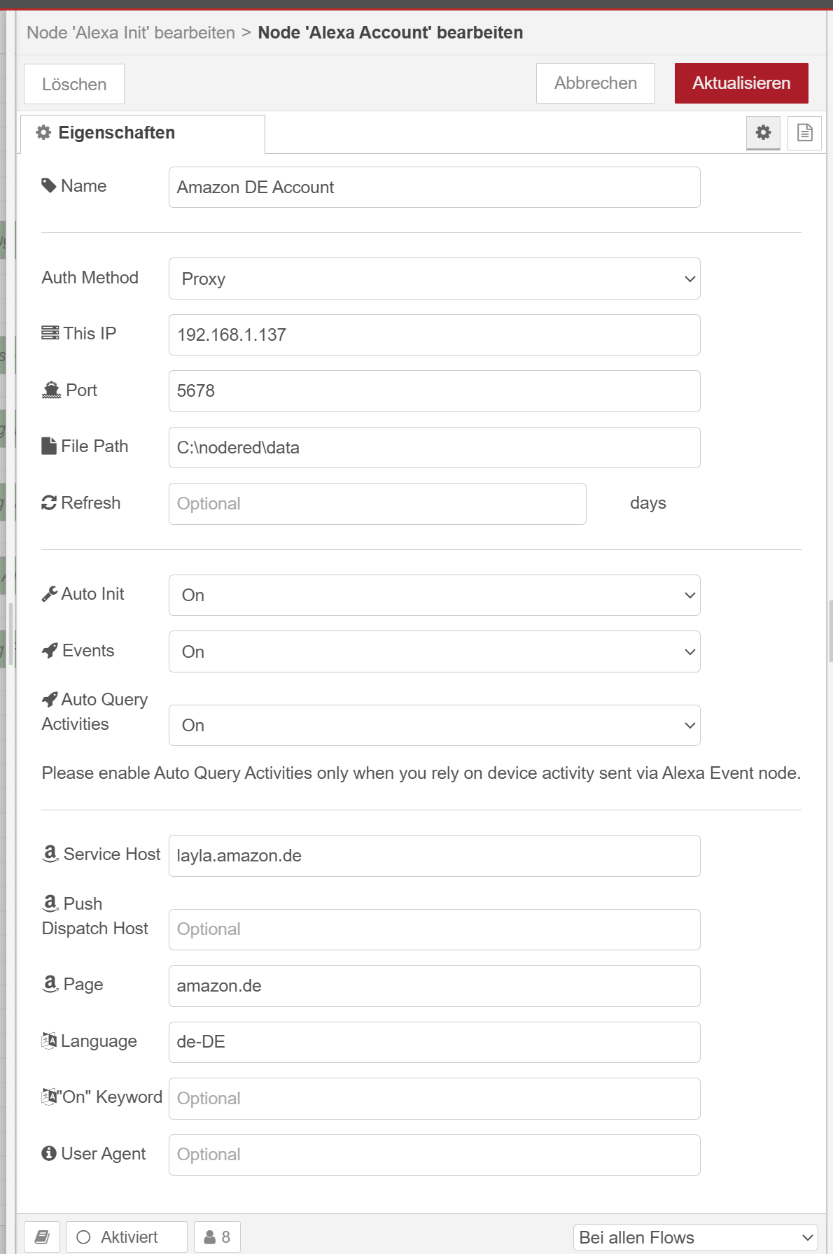

I seem to have 2 problems: storage location for the cookie and authentication using http://localhost:5678 ? Also many settings within the account cards which i might not use right?
If you’re running docker, you must expose the Port you type in in the configuration accordingly in the container. Either use “host” as network mode or simply add “5678:5678” in the ports part of your docker-compose.xml.
If you’re using the german alexa-enpdoint, then you don’t have to change anything on the card - except “This IP” and an correct/empty “File Path”.
If you’re using any other country/language settings, please check in the docs of the Node-Red node: bbindreiter/node-red-contrib-alexa-remote2-applestrudel: Node-Red Nodes for interacting with Alexa
I apologize but i can’t follow. I need some step by step description. Have looked into the docs without success.

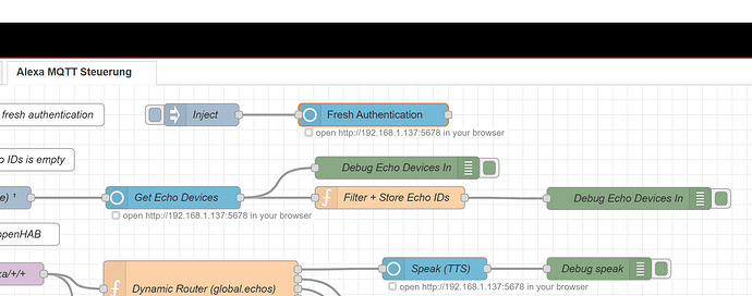

I double-click on “Fresh authentication”:
The this window opens:
What are the right settings here? If i use the port 1880 which is defined for nodered in my docker-compose.yml, i get “this port is already used”. Sorry, but i have a lack of basic understanding of this auth method :frowning: .
Nope, there is nothing to click :innocent:
If you want a fresh authentication, you need to click on the square button left to “Inject”.
But before doing that, just watch the url below the “Fresh Authentication”: it says, open http://…
Open that in your browser and you will be prompted to add your username, password and 2FA for Amazon.
THAT is the authentication.
Thanks for this hint. But i cannot open the URL which is shown. “ERR connection refused”.
It needs to be the url for your node-red container (same as in the amazon account setup), but I have no knowledge about Docker or openHAB on Windows to solve this, sorry.
Edit: The ip adress you have to use is not your openHAB instance, but your node-red instance. Connection to openHAB is made through the MQTT broker.

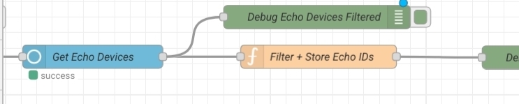

Put a debug node before the filter and check the deviceFamily in the log.
Currently I filter only ECHO (Echo Dot, Plus…) and KNIGHT (Echo Show). AI says Sonos is named SPEAKER, can you confirm?
