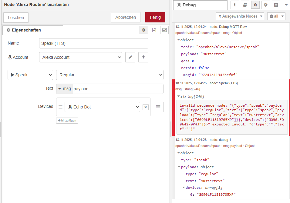

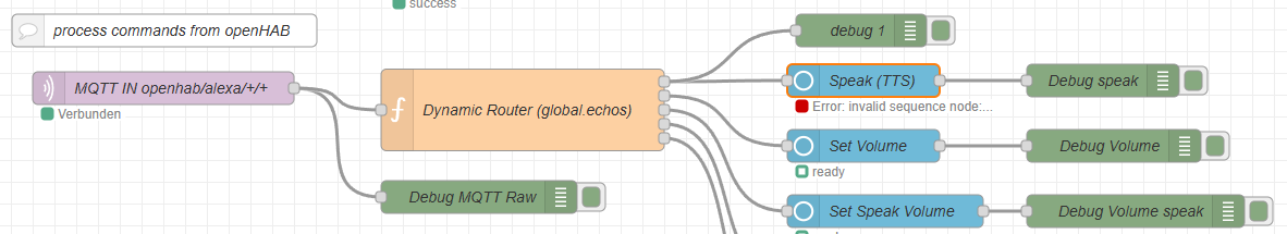

Thanks for sharing this. In general it works for me, but when I use the mqtt part I’m facing an issue with the interface between the “dynamic router” and the “Speak (tts)”-Routine. Not sure how to setup this node. Always receiving an error message (see below…)
To get more information I’ve placed an additional debug node behind the router… Maybe you can give me a hint?

you have to delete the node and drag a new “Alexa Routine” one in its place. Leave it as is and only pick your amazon-account (Alexa Account) above and fill in a name (Speak TTS as ist was?), then try again.
Hi Binderth,
thanks for your quick replay, but that doesn’t “say” nothing at my device. If I got you right, I need a blank Alexa Routine with blank information fields. So I did, but after execution the “regular” and the topmost of my devices goes to the Devices-Field, but no sound indeed! The debug has no error message. If I fill the Text-Field with a different string, this will be spoken….
If I have oll fields empty on this node, the error will tell me: “no device”.
BR
H.

As already mentioned the Alexa Routine is working in general when injecting a string (e.g. msg.topic “sample text”) and populating the Node-Fields of Alexa Routine manually (regular, msg.topic, device)
But its not working with the mqtt-part even wenn the “Debug MQTT Raw”-Node and my “debug 1”-Node are showing korrekt information
that’s strange and yes, the developer of that node did it so, that if you paste the node via the palette it gets prefilled. I have no idea how to delete that (which larsen obviously managed to!
). But if you chose “custom” it should work.
your debug console shows the msg.payload for the “Speak TTS”-node has not the correct structure. I suggest you delete your flow and re-import the one from larsen in the very first post again. Then type in your IP and FilePath and start over again. In your editing stuff (mostly the Dynamic Router (global.echos) node) there was some mismatch happening.
thanks, the custom works perfectly. Will try to investigate why the Speak TTS doesn’t. I’ve reimported the flow this morning, already, but maybe I’ve not doing it in a correct way (I recall some messages I didn’t understand
