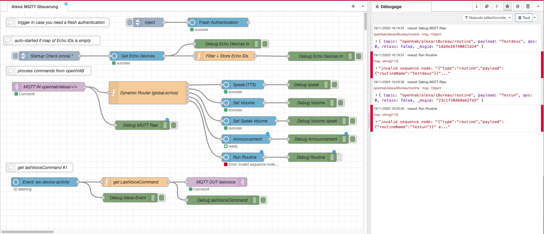

The speak and volume functions work fine, but I’m having a bit of trouble with how to execute a routine or send a text command (to start a radio, for example).
Is there something I’ve missed?
This is the message I get in the debugger after sending the name of an existing routine.

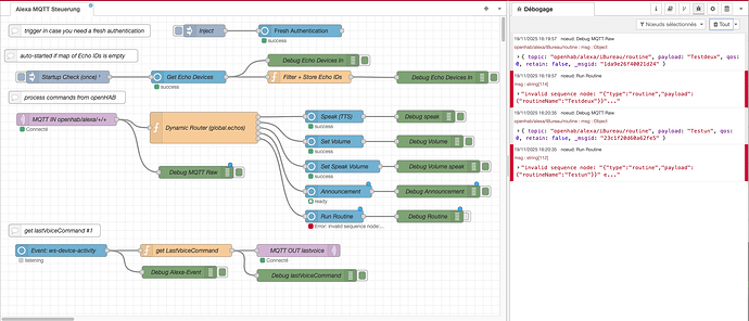

-Announcement > no longer works and returns an error
-Run Routine > no longer works and returns an error

Regarding “routine” it’s not working. There is no error shown, but my Echo Show 2 just is doing nothing.
For reference and analysis, this is the debug output:
→ all IDs lgtm but nothing happens on the Echo.

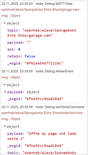

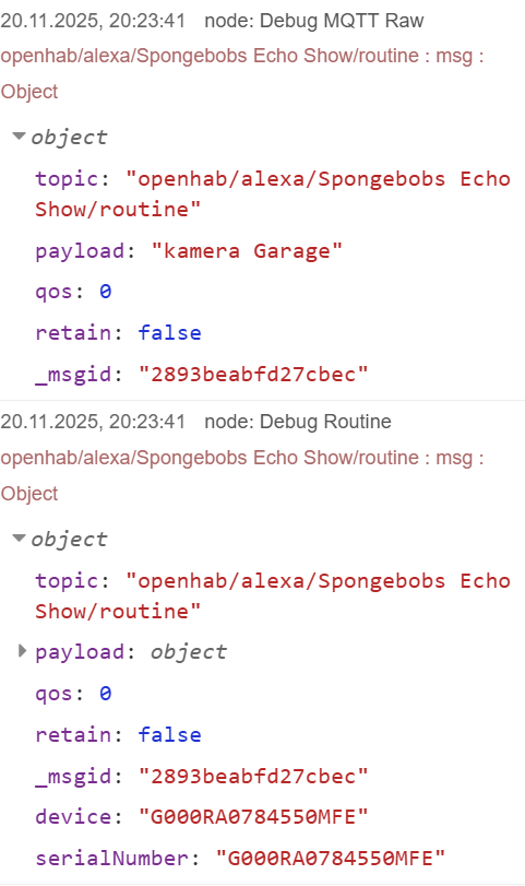

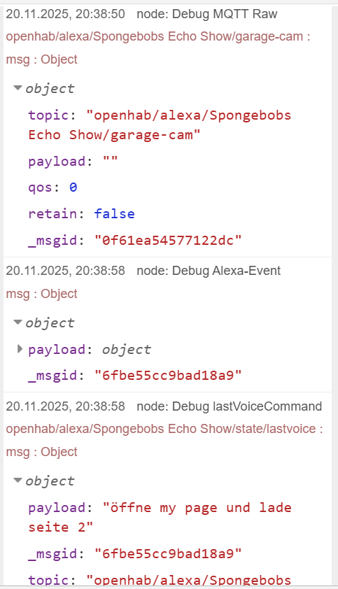

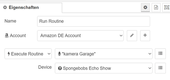

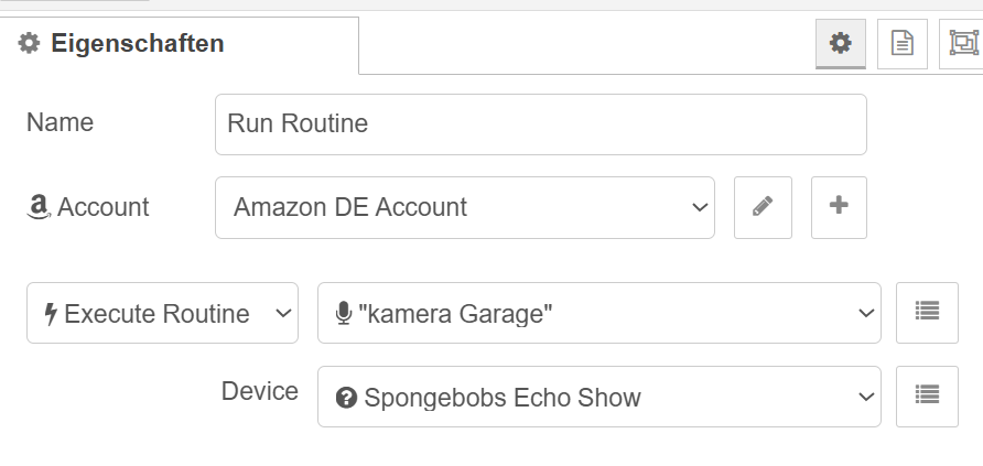

But now, after your input and impulses I extended your Dynamic Router with 2 more cases to execute my Alexa Routines. My config looks like this:
And the output after execution is as follows (just one command, the debug after 8 sec is coming from Alexa itself (in the debug you can see what my alexa routine is actually '“Öffne my page…”
so for me, everything is working. Thanks a lot. If i can help anyone in any way regarding more details, let me know

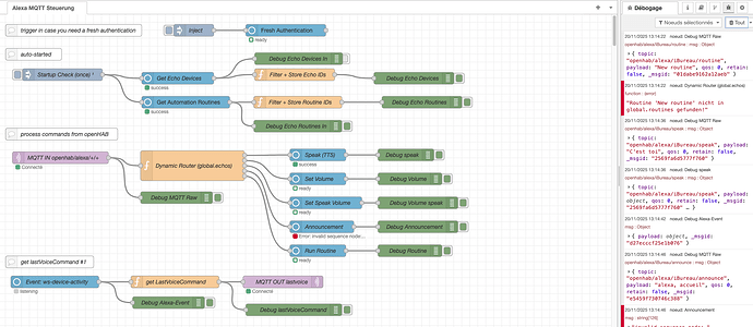

For me the “routines” work. It might be a problem with the spaces in the names of echo devices. The spaces in mqtt topics at least look strange to me. Node-RED is known to have problems with that (but I didn’t test it). Try an echo without spaces. It doesn’t matter which one you choose anyway.
I updated “announce” so that it works now too.

When I send a command with “announcement”, my Echo device does the same thing as when I send a command via “Speak” but doesn’t execute anything. What is the correct usage method?
Sorry, but I don’t understand exactly what you’re missing. The whole process is very well explained in Larsen’s first post.
Well, that’s just what an Alexa-announcement is: The same as speak but with a nice ding-dong at the beginning.
