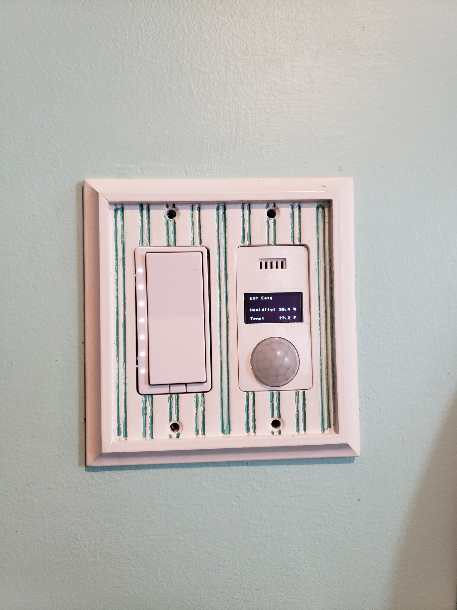

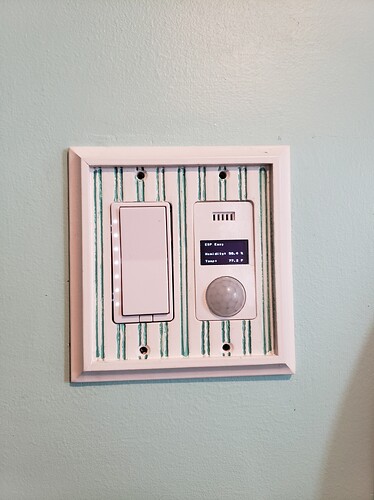

Finished my project finally. Next round I plan to incorporate a buck down into a very small breakout board. My electrical box behind this packed.
Very cool! Look at the IRM-03-5 from Meanwell, it’s what the HASP project uses for AC/DC conversion. It’s not too big, but you could always switch the NodeMCU to a Wemos to save some space, too…
Yeah that’s my plan. So far it’s been running for 12hrs. Temp went up 10f from what I tested in my man cave. I believe it’s the homeseer causing the issue. Until I get v2 I cant do anything to insulate behind the sensors. For time being I detuned the sensor by 10f.
it’s definitely affected by the box temp - but the good news is you can linearly calibrate it (i.e. subtract 10f as you did)…I put my sensors in the same room as the HVAC controller for a few days, to figure out how much I need to offset them by (since ultimately, I’m trying to read temperature in reference to the thermostat). You could do that with your sensor first, then put it back in the wall, and use another sensor located in free air as a “control” to see exactly how much to offset to account for the internal box temperature.
