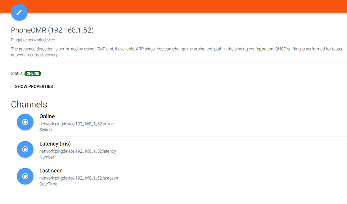

Haven’t read the tutorial, but this is how it looks at my system:

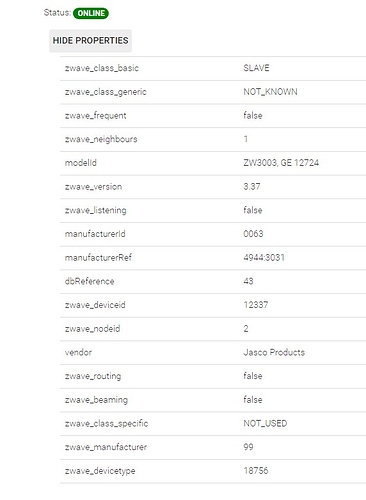

Have a look at the thing properties - it should show things like zwave_devicetype - can you provide either all of them, or at least the device type, device id and firmware version. From this we can check if the device is in the database.
Alternatively, take a look in the userdata/zwave folder, and you should find an XML file with this nodes name on it - can you post that here?
Here’s a shot of the Properties:
It looks like it’s detected fine -:
https://www.cd-jackson.com/index.php/zwave/zwave-device-database/zwave-device-list/devicesummary/43
There is just a single channel on the device.
