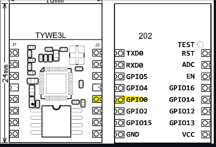

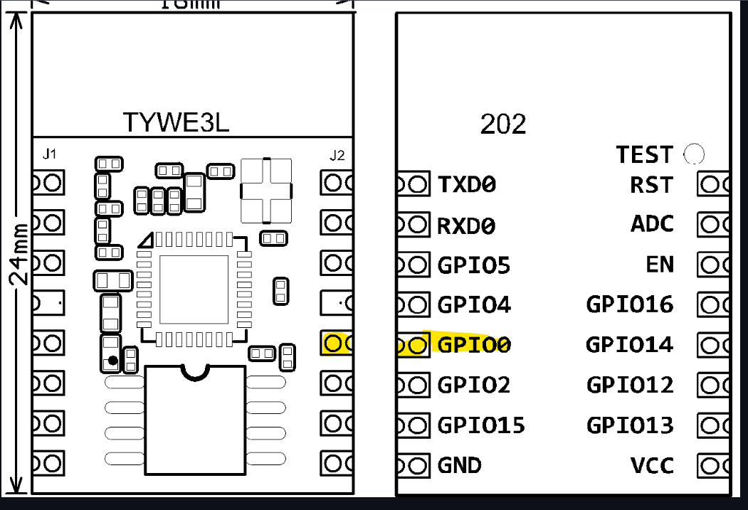

Can you please point out the GPIO00 pin on the board? Also i’d like to know how to flash it using an ESP32. Will directly flashing the ESP32 also flash the smitch board ( connected through jumper wires) ?
and if you are using esp32 as serial flasher then connect the “en” or the reset pin to the ground pin to disable the onboard esp chip and make it able to flash other hardware. Then connect the Tx to Tx and Rx to Rx from esp32 to bulb. Now you can just flash using your pc connected to esp32.
connect this gpio to gnd and flash the board.
then remove the connection and reboot.
I am using ESP32 and bulb.
I am connecting EN (of ESP32) pin to GND ( of ESP 32).
Also connecting GPIO00 (of bulb) to GND (of bulb).
And RX(of ESP32) to RX (of bulb)
TX(of ESP32) to TX (of bulb).
Am i doing this correct?
What do i have to do with the VCC pin of the bulb?
vcc to 3.3v of your esp32. be sure its 3.3 pin not 5v pin and dont connect ac main to bulb.
I have successfully programmed the bulb using your method. Thanks.
