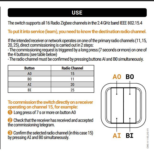

But I’m not able to add the following device, that is green power switch with no battery from Nodon too:
When scanning for adding new devices, nothing happens and the device is never found.
Nothing appears in the log
What can I do ?
Is Zigbee Green Power supported ?
Is it a different protocal than standard Zigbee 3.0 ?
Thanks for your help,
Sylvain
Did you follow the instructions in the manual. This device doesn’t even have a battery so it only has the power to transmit and receive when you press a button.
The instruction manual has a combination of long and short presses you need to do while the coordinator is in scanning mode to make it join a network.
The Zigbee Coordinator Thing will tell you what Channel you need to use.

Yes I follow the user guide carefully, but it’s not very easy and could lead to some issues.

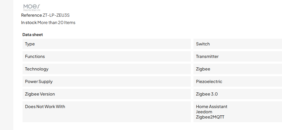

https://www.domadoo.fr/en/smart-lighting/6756-moes-3-button-wireless-zigbee-smart-switch-without-batteries.html
This device is much more easy to bind because buttons are explicits. But I failed also to do the pairing of this second device.
Any suggestion would be very appreciated.
I have not seen many tuya that are true zigbee standard most are tuya nonstandard ZigBee and have issues with the standard OpenHAB Zigbee binding.
From your link it states this
“Control your smart devices such as lighting, roller shutters and more using Tuya Zigbee scenarios with the MOES wireless, battery-free switch.”
Hi Justan,
It’s specified on the device Zigbee 3.0
Anyway, because I can’t pairing none of these devices with piezo effect, I was wondering if there was something specific in the Zigbee protocol, related to green power, that could prevent to support them ?
Are you aware about something ?
I’ve already requested Nodon support that answered me that they didn’t try on OpenHab.
Do you know where I could ask my question ? Maybe something is wrong with the Dongle or with the coordinator ?
Sylvain
just reading what you posted says a lot.
Does not work with
Home Assistant strike 1
Jeedom strike 2
Zigbee2MQTT strike 3
and you are out!.
Nonstandard!
Normally when I have a Tuya branded Zigbee device that the standard OpenHAB binding did not work with I was quickly able to pair it up and use it in Zigbee2MQTT but your device is clearly even more nonstandard since it does not support Zigbee2MQTT or even HA so it must be Tuya proprietary. Or so new that no one in any of the “big 3” communities have looked at creating the device profile. I do not think it is a dongle or a OpenHAB configuration issue. I think your device just has such a nonstandard implementation of the Zigbee protocol and very little market penetration at this point no one has reverse engineered its nuances to make it work on any of the main platforms. You may have some luck reaching out to the Zigbee2MQTT community to see if someone there has looked at it or is attempting to create a device profile Heck, they may even be able to guide you to running through some debug efforts to get it working in Zigbee2MQTT. They are very receptive and love adding new devices to their supported list.
