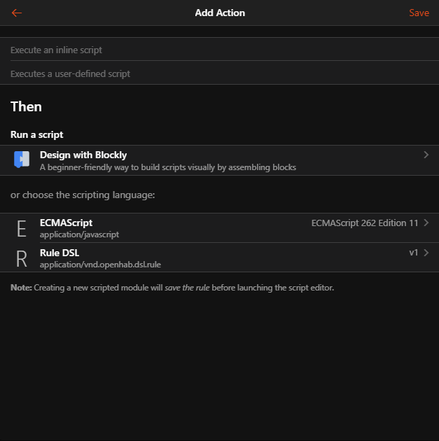

Just updated to M2 and am unable to create a Blockly script. Moving back to M1 clears the issue. Clicking on Inline Script in the “Then” section, the normal pop up shows:
When I click on Design with Blockly, it just switches to:
