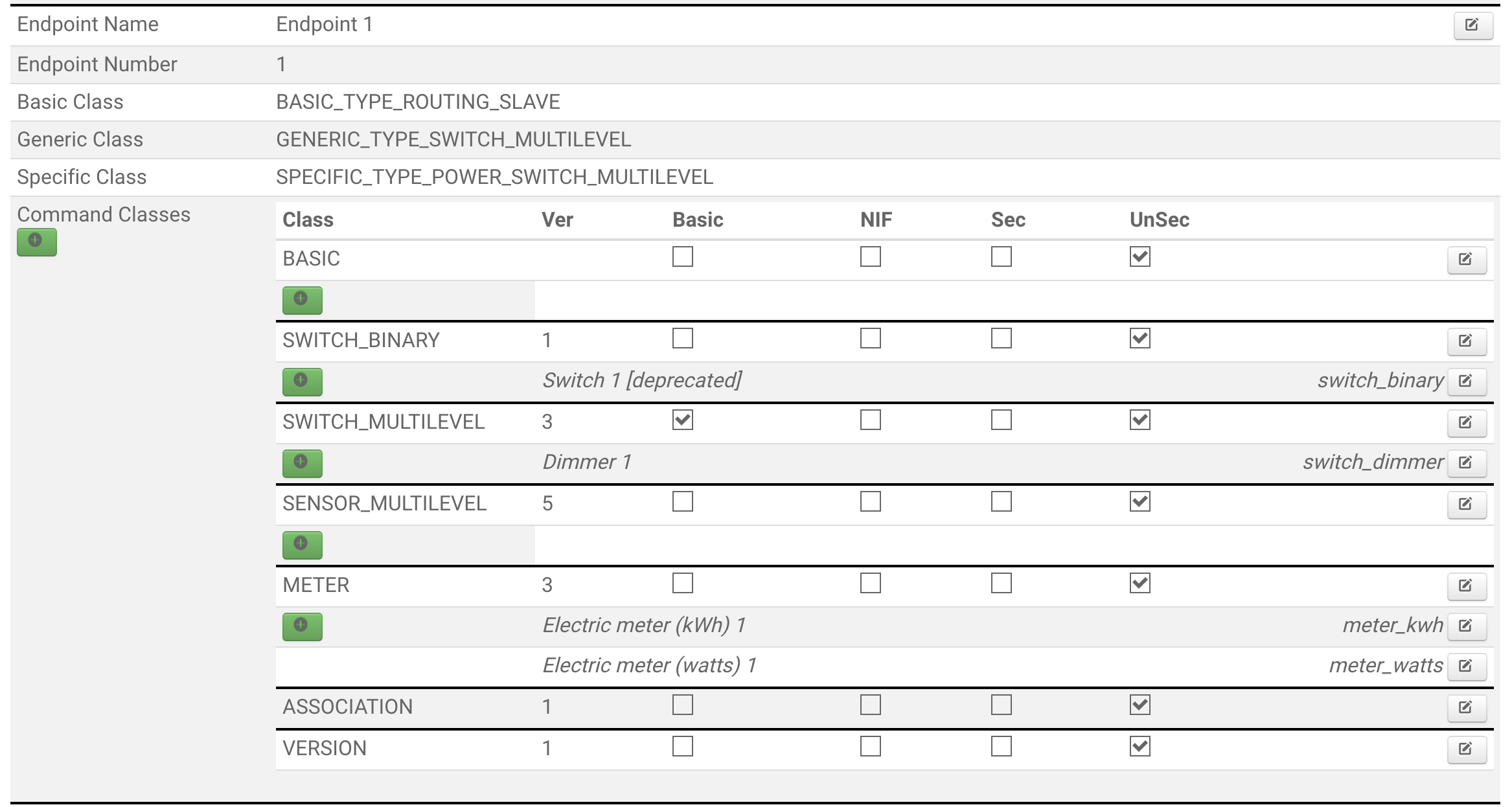

During your last database change you’ve added/edited the sensor_mulitlevel channel for endpoint 0.
Is that really what you want?

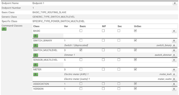

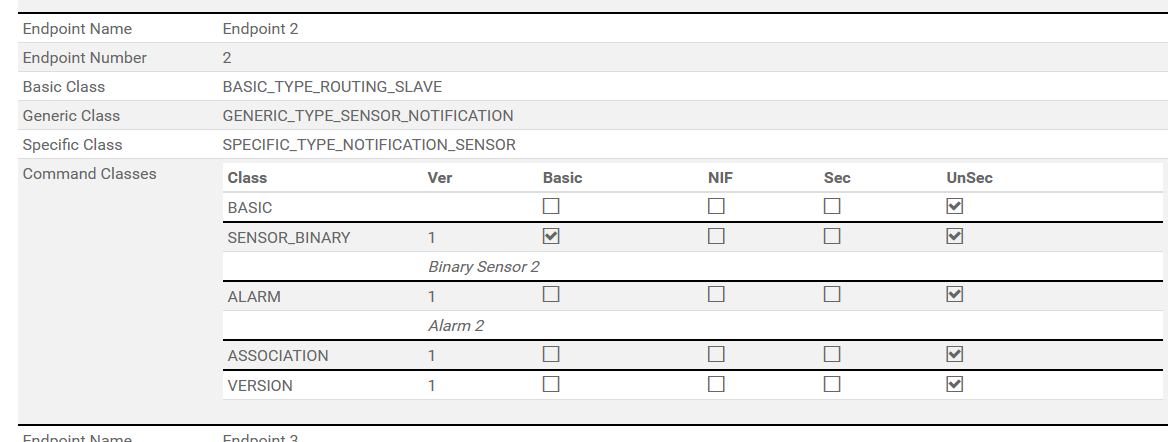

Not quite. It took me a little while to work out what’s up here. I think the sensor_temperature channel in endpoint 0 was always there.
No channels were added - but a new command class has been added to endpoint 1, and in the config for that command class the channel has been added (Which won’t do anything).
I’ll remove this as it’s presumably wrong?

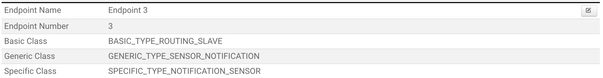

I added it to Endpoint 2 in the editor. Not sure why it appears to be a change on Endpoint 0. That wasn’t my intention. It wasn’t clear what I needed to add to the ‘Configuration’ field though.

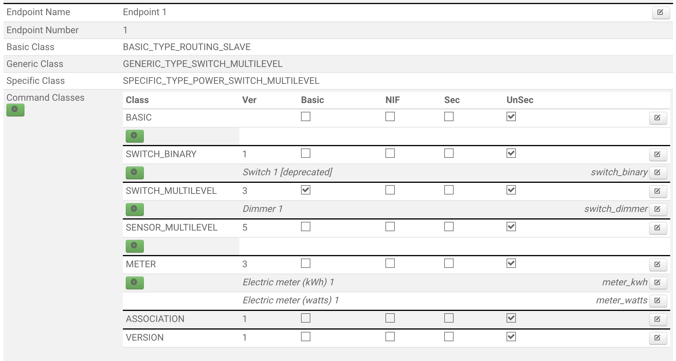

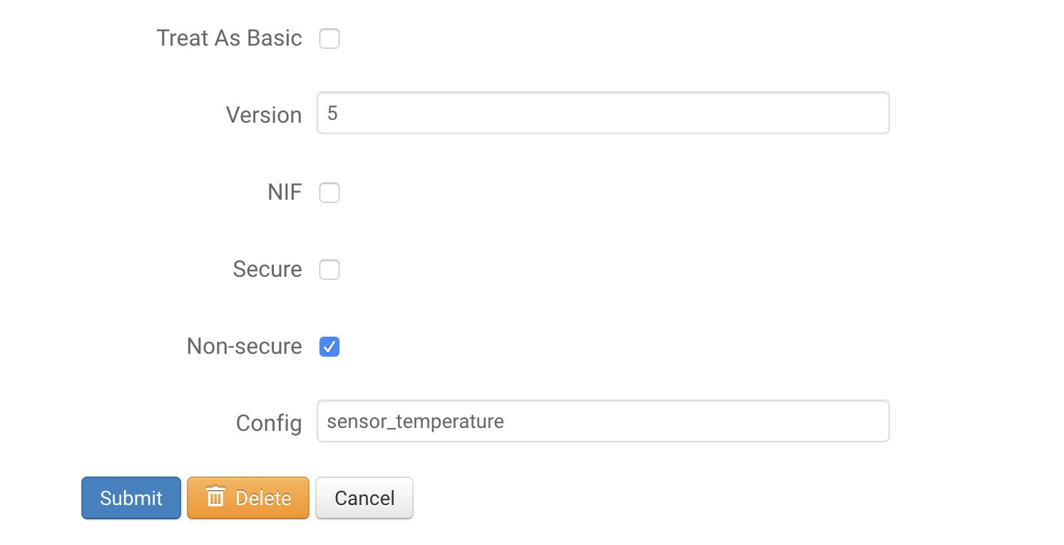

As above - you added a new command class (not channel) to endpoint 1 as seen below -:
This is not the same as adding a channel and will not do anything. I think it’s wrong, and we should delete this and add the command class AND the channel to endpoint 2.

Yes that was what I was trying to do. Did I need to add the Command Class and then add some XML in the ‘Configuration’ field?
chris
(Chris Jackson)
January 25, 2020, 11:49am
30

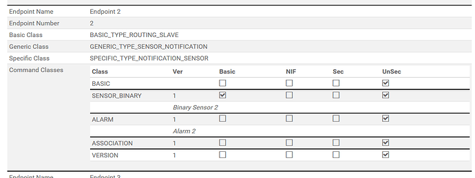

There’s no XML required. You add the command class, then inside that in the main screen is another + button that allows you to add a channel.
Please check that you’re adding to endpoint 2 - not the second endpoint (which is endpoint 1 since endpoints are numbered from 0). My guess is that you went to the second endpoint and added the class there, missing the fact that this is actually number 1.

No - I’m saying that it’s endpoint 2 in the database, but you added the CC to endpoint 1. My point is there is also an endpoint 0, so if you didn’t check the numbering, and just counted to the second endpoint, then this is endpoint 1 - not 2.
