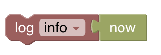

This is from Blockly generated Code.
if (items.getItem(‘motionFloor1_EG_Stairs’).state == ‘ON’) {
items.getItem(‘motionLastFloor1_EG_Stairs’).sendCommand((time.ZonedDateTime.now()));
items.getItem(‘motionLastFloor_Stairs’).sendCommand((time.ZonedDateTime.now()));
items.getItem(‘motionLastBuilding’).sendCommand((time.ZonedDateTime.now()));

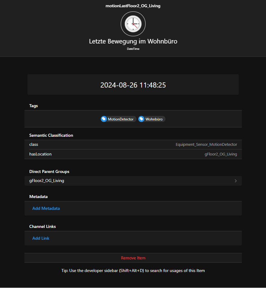

Yes, I would say that I miss timezone-shift of 1 hrs. In Screenshot is this gap of 1 hrs too. Real time is 12:48:25 and NOT 11:48:25 like in screenshot.
