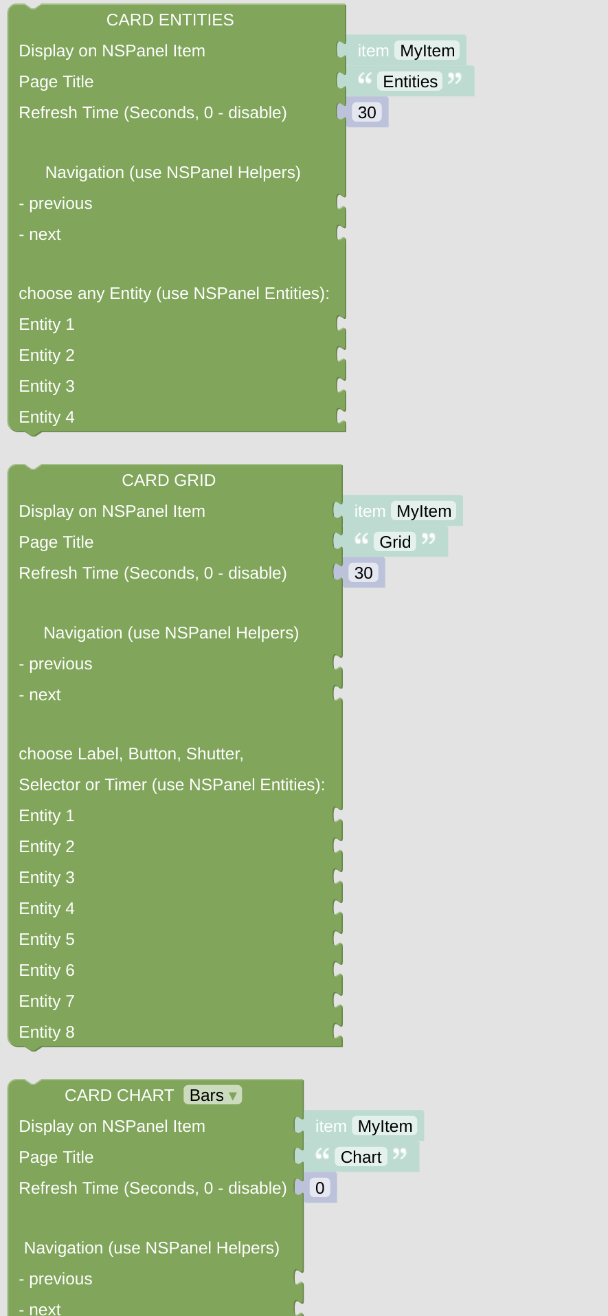

This is part 3 of a 5-part collection of blockLibraries to use the NSPanel with the Lovelace UI. Check out the online documentation about how to use this library.
The required 5 libraries are:
All installed libraries need to have the same version number!
Blocks
For some description of the individual blocks of this library have a look in the online documentation.
