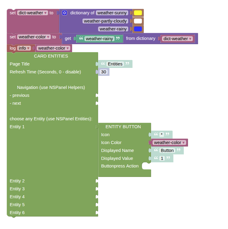

Concerning the 2nd problem, I did a small test (with a card entities and an entity button) with the following blockly:
I did a test with my nspanel and it seems to work fine. You have just to adapt it to your screensaver: replace “weather-rainy” in the second block by a “get state of item” with the relevant item of your openweather thing.
Hope it helps

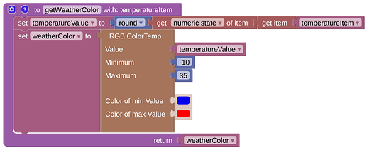

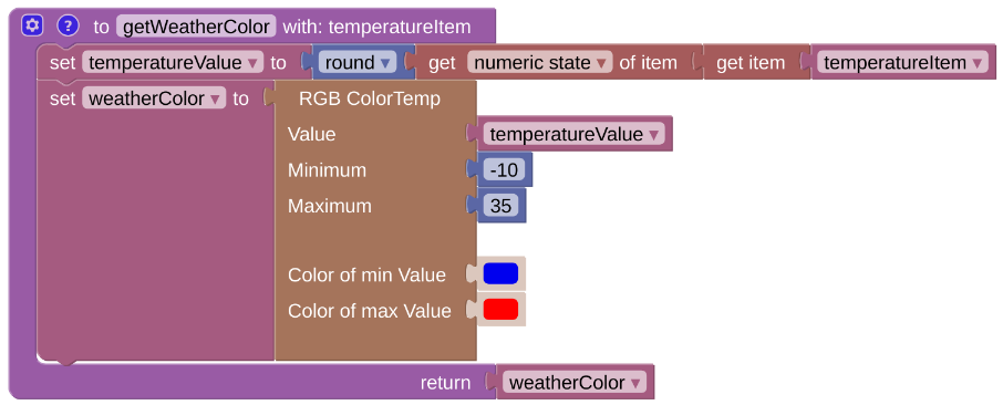

Hi, also regarding the 2nd Issue, not exactly what you wanted: I am colorizing the Icons based on the temperature using the ColorRangeHelper:
grafik
Maybe that’s also some option to get more colors on the panels :slight_smile: I am using this for the weather and some similar approach for room temperatures.
Best regards, Rene

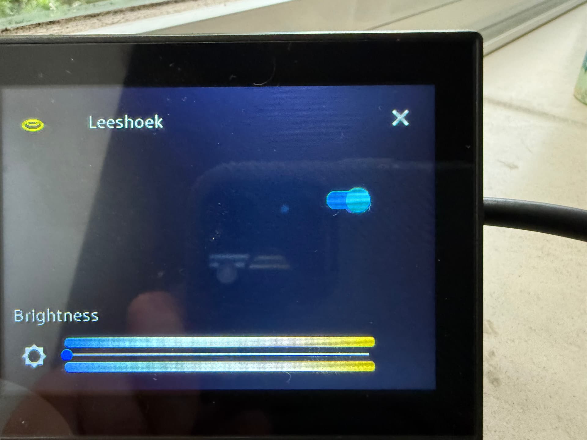

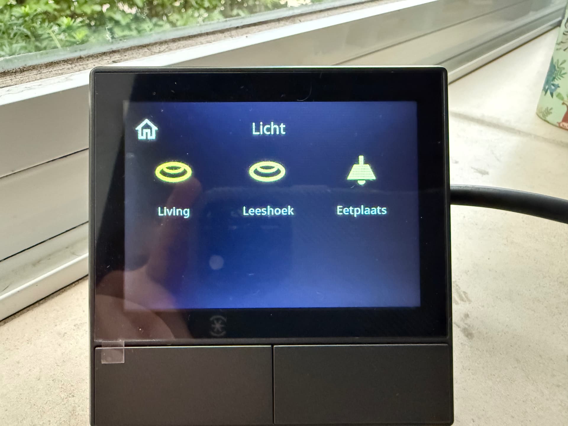

Regarding my first question. maybe some clearer statement. I don’t like the toggle switch on the right and would like to use something more intuitive than the brightness slider to dim/switch ON-OFF our lights. How did you all do this when you used a dimmable light?

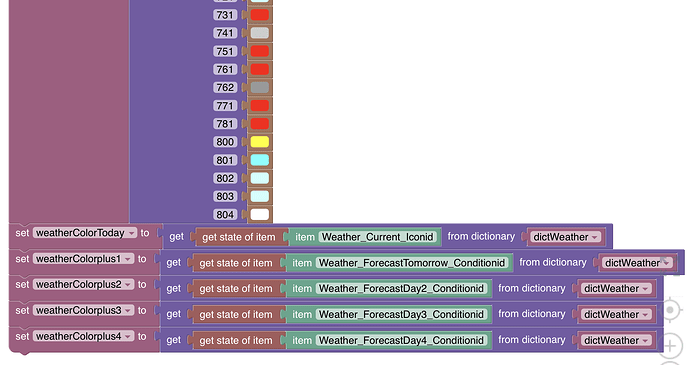

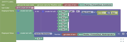

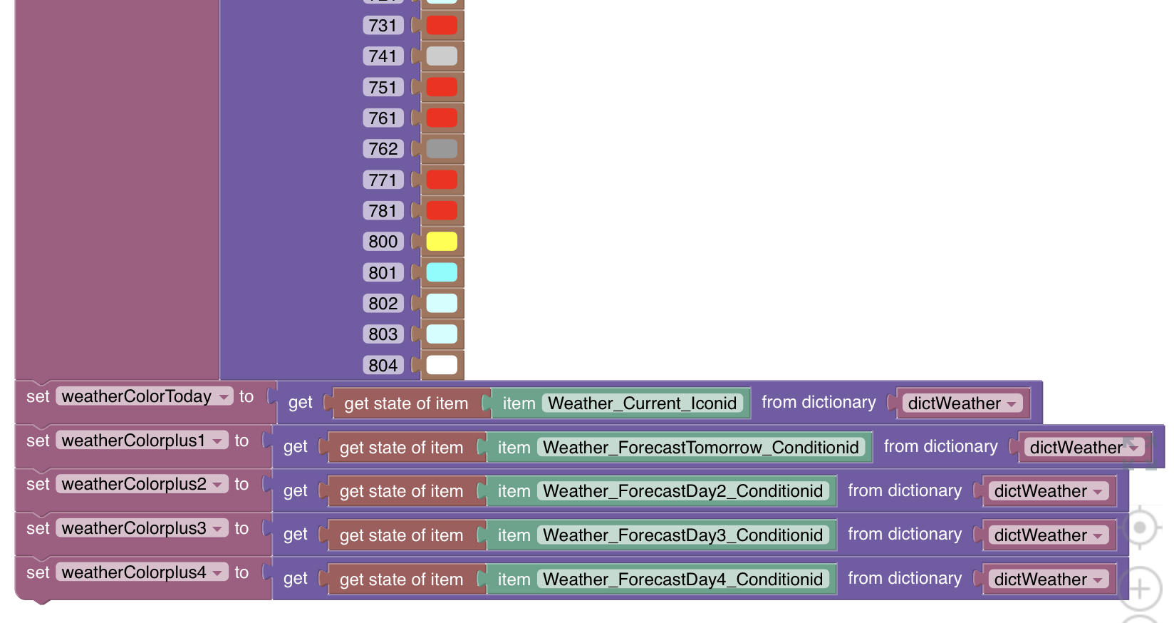

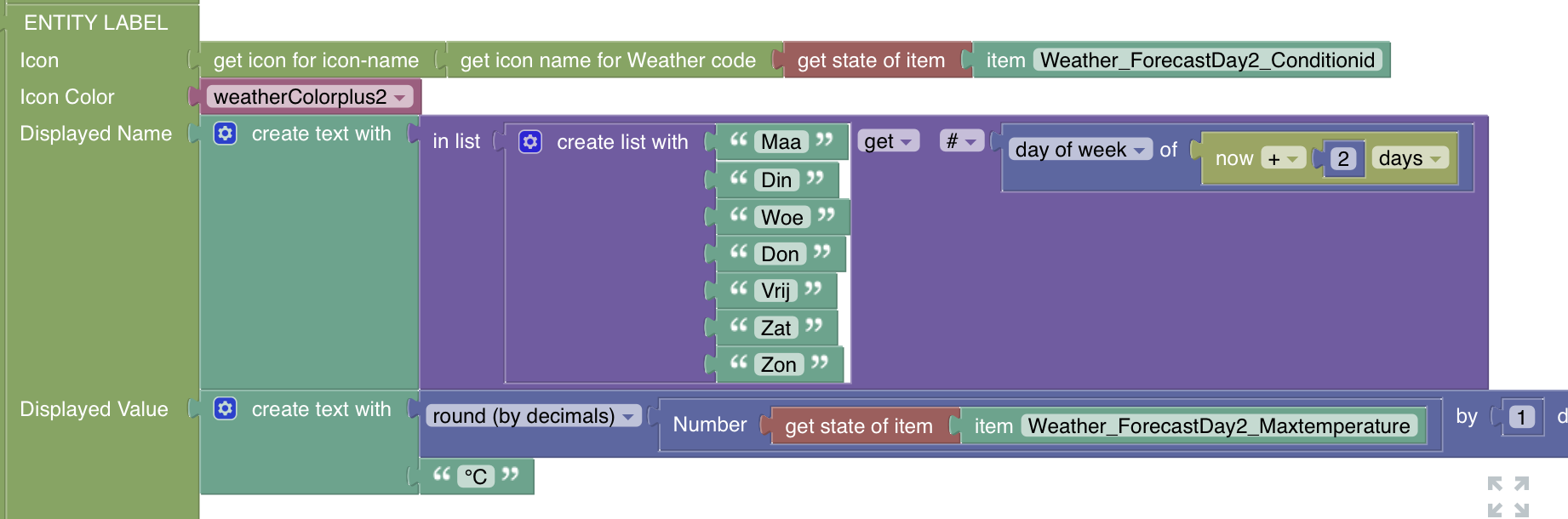

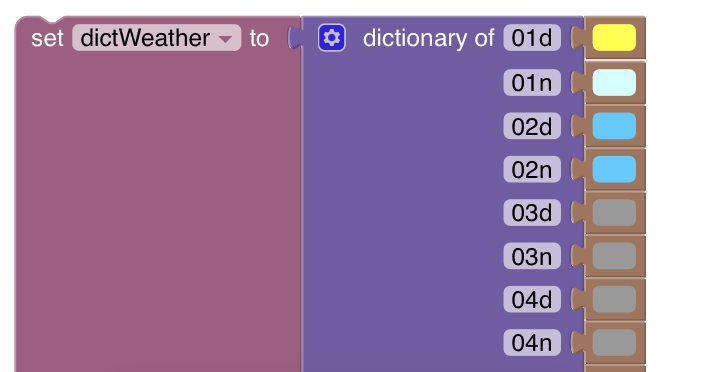

regarding my second question. I’ve now a more colorful screensaver. where I’ve assigned a color to each weather type of open weather.
Herby some snippets for others.
Scherm­afbeelding 2025-07-06 om 16.15.18
Scherm­afbeelding 2025-07-06 om 16.15.35
Scherm­afbeelding 2025-07-06 om 16.15.47

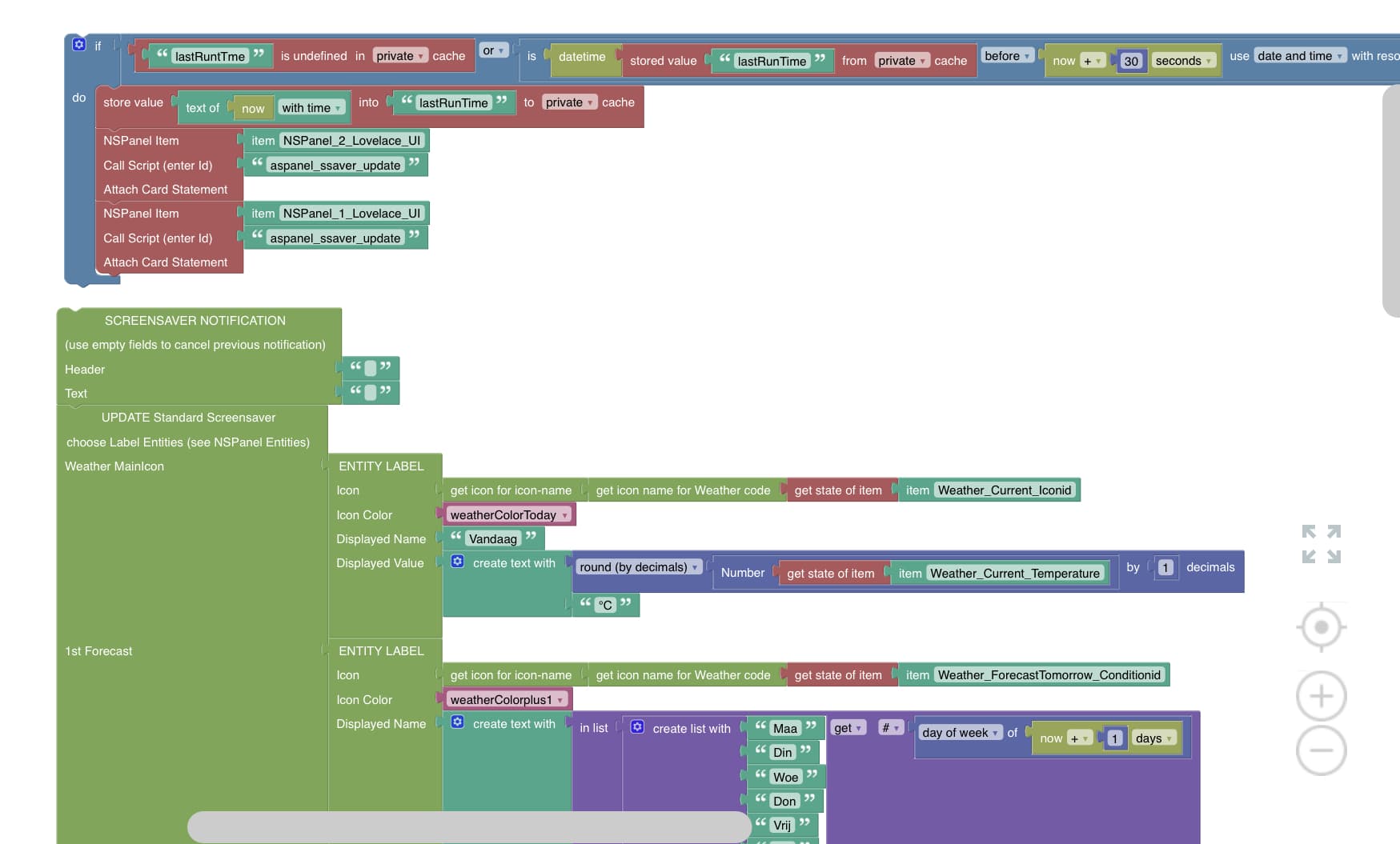

Today I’ve successfully added a second NSpanel to openHAB. Every card is working except the screensaver not as intended.
I noticed that on the second panel the weather isn’t updating on the second screen.
It black below the time and date (simple screensaver).
Did I do something wrong in the screensaver update script?
IMG_3145

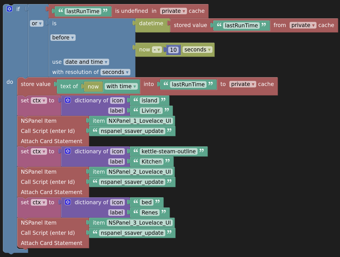

Hi @Vannue ,
seems ok, I’m doing it a similar way (just additionally setting some context variables for per-display values):

Do you please this 'if statement" block above and in the same (attached or not to the screensaver script) “nspanel_ssaver_update”?
Hi @Vannue ,
not sure if I’m getting your question right, but the if-block posted is one complete rule. The “nspanel_ssaver_update” is some othe script called by this if-block.
If I’m looking again it seems like you are having two unconnected big blocks in the same rule, not sure how this runs in the end. Maybe you can split this into two rules or scripts?
Regards, Rene

Hi @Vannue,
so the image above with the if-block and the “Screensaver Notification” is your “spaniel_ssaver_update”? Then probably what happens is that this rule is calling itself and because of the lastRunTime-Limit it will not be called again for the 2nd Panel. Probably. Something like that.
If it is like that, just add everything you are planning to do on the panel in a separate script (in my case “nspanel_ssaver_update”). The rule, which is regularly called should just contain the if-block and should not call itself. If you are familiar with javascript programming, you can always check the source-code in the blockly editor with the icon on the bottom right.
Regards, Rene
@rene_rostock
Indeed by doing the following per your suggestion I get both panels working with all the details.
I’ve created a separate script “nspanel_ssaver” for all the screensaver related card, etc. and I call the rule “nspanel_ssaver_update” of which only exist out of the the if-block.
In this way my experimental sliders also suddenly works for dimming my lights.
This is a useful lesson :slight_smile:
