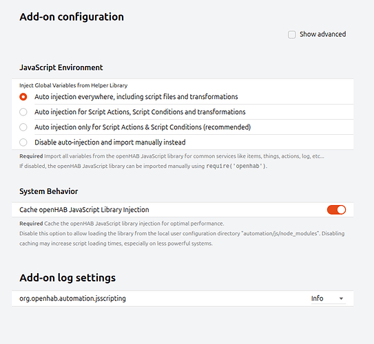

Thanks to @Nadahar for the proposed solution and detailed explanations about the problem and @rene_rostock for having checked it. Just to be on the safe side, one needs to disable the Cache openHAB JavaScript Library Injection here:

To run a different version of opengab-js than comes with the add-on, which is required until OH 5.2.1 is released, one must:
  1. use npm to install the openhab module. detailed instructions are at the bottom of the JS Scripting docs.
  2. In MainUI navigate to Settings → JS Scripting and toggle off " Cache openHAB JavaScript Library Injection"
You can check which version is installed by looking at $OH_CONF/automation/js/ you’ll find two .json files. You can look in either one I think to see which version of openhab node module is installed.

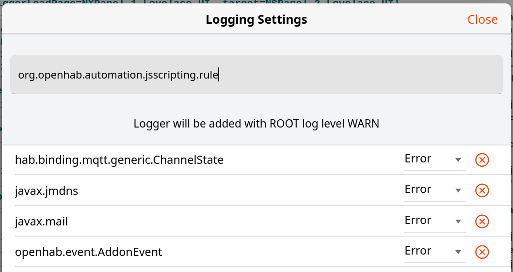

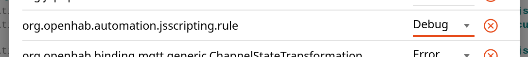

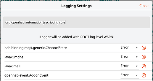

if you turn on debug level logging for any org.openhab.automation.jsscripting.rule you should see the debug-log of your nspanel callback, which will show you some information about the used javascript (like below).
Open the OpenHAB logging panel with the menu “Developer Tools” → “Log Viewer”. Click on the lower right “Configure Logging” and add “org.openhab.automation.jsscripting.rule” in the text field, enter. It will be added without much feedback, search the list and change the level to “Debug”. You should see the relevant debug log and a lot more :slight_smile:
