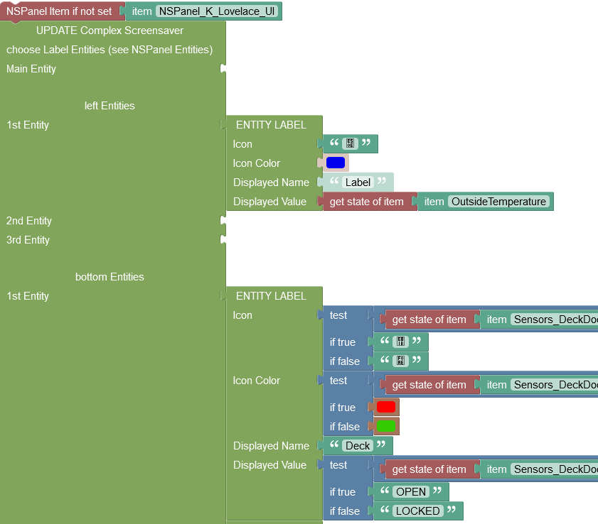

Thanks for the explanation. When I press the buttons I do not want the screen to do anything. I just ended up creating a couple of additional channels and having my own rules deal with the mqtt messages.
Now to another problem.
On the callback script I checked the use complex screensaver, and on the startup section I clicked the run also after leaving screensaver and added the entity script name
I also created a rule that triggers every time that any of the entities (items) in the complex screen saver changes value and runs the complex screensaver script.
Now, from the screensaver I can go to the entities screen by touching the screen until one of the items in the complex screensaver gets updated, after that the screen stops responding to touch and just remains on the screensaver.
This is the log after I run the screensaver update
2024-01-07 19:19:28.969 [INFO ] [omation.script.ui.nspanel_k_callback] - waiting 1 sec. for running rule update_complex_ss
2024-01-07 19:19:28.969 [INFO ] [tomation.script.ui.update_complex_ss] - starting script 'absorb_it_nspanel_weatherupdate' {event=Execution triggered by manual, triggeredLoadPage=1, ruleUID=update_complex_ss}
2024-01-07 19:19:29.970 [INFO ] [tomation.script.ui.update_complex_ss] - starting script 'absorb_it_nspanel_notify' {timerName=absorb_it_nspanel_refreshTimer_nspanel_k_callback, ruleUID=update_complex_ss, target=NSPanel_K_Lovelace_UI}
2024-01-07 19:19:29.973 [INFO ] [tomation.script.ui.update_complex_ss] - starting script 'absorb_it_nspanel_weatherupdate' {timerName=absorb_it_nspanel_refreshTimer_nspanel_k_callback, ruleUID=update_complex_ss, target=NSPanel_K_Lovelace_UI}
2024-01-07 19:19:29.981 [INFO ] [tomation.script.ui.update_complex_ss] - starting script 'absorb_it_nspanel_notify' {request=pageUpdate, item=null, previousPage=update_complex_ss, timerName=absorb_it_nspanel_refreshTimer_nspanel_k_callback, ruleUID=update_complex_ss, trigger=null, newState=null, target=NSPanel_K_Lovelace_UI}
2024-01-07 19:19:29.985 [INFO ] [tomation.script.ui.update_complex_ss] - starting script 'absorb_it_nspanel_weatherupdate' {request=pageUpdate, item=null, previousPage=update_complex_ss, timerName=absorb_it_nspanel_refreshTimer_nspanel_k_callback, ruleUID=update_complex_ss, trigger=null, newState=null, target=NSPanel_K_Lovelace_UI}
If I use a change in the items in the complex screensaver as triggers for the callback rule the items don’t get updated until I touch the screen and after the timeout the screen returns to the screensaver.
Not sure what I am missing.
Hi, I assume that the problem lies in the way you are starting the updates of the screensaver items.
You can move the configuration script for your screensaver into the script section and start this script with a rule and the Start Script With Context helper, this should work as of now.
The setNSPanelItemIfNotSet helper seems to be broken for your use-case. The callback will store the last triggered page to be opened if you leave the screensaver - and with the setNSPanelItemIfNotSet you will change this ‘last page’ to some screensaver configuration, not a page. Probably the “NSPanel Item if not set” implementation needs to be changed, I will check this asap.
Thanks for your feedback - best regards,
Rene
That fixed the problem.
Now it is working great
thank you

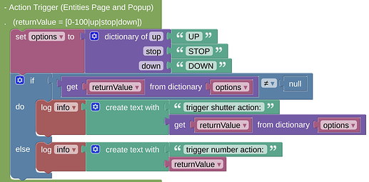

Hi I have a question on the value returned on the shutter entity.
On the blind THING I have two channels with the associated items, a rollershutter and a dimmer
In the shutter entity I read the dimmer value to set the slider and I use the rollershutter item for the return value
This does not work for either up, down, stop or the slider. By not work I mean that the blind does not move

Hi clark,
you are right, the blockly part will not work directly. The resulting values (returnValue) are just as they come from the NSPanel Lovelace UI implementation, I was not aware that they are so close to the required values to control a rollershutter item.
You can get the required values in blockly as this:
(btw, the description of the tilt area is wrong, it will give you ‘open’, ‘stop’ and ‘close’ as returnValue)

Hi again
Neither of those approaches works for me, probably because I really don’t understand Java so I just try to adjust the examples I see.
For the blockly side this is the code, which I think matches what is in your reply
This is the log when I run it
8:52:34.340 [INFO ] [nhab.automation.script.ui.Entities_MB] - trigger shutter actionSTOP
08:52:34.345 [WARN ] [ernal.defaultscope.ScriptBusEventImpl] - Command 'stop' cannot be parsed for item 'Studio_Blind_2_Rollershutter (Type=RollershutterItem, State=55.0, Label=Studio Blind 2 Rollershutter, Category=blinds, Tags=[Point])'.
It looks like the string “stop” is still being sent to the command
On the javascript side I get this error
MBBlindControl not defined
I am somewhat used to DSL, I really don’t know javascript so I don’t know what has to be defined before the code accepts it.

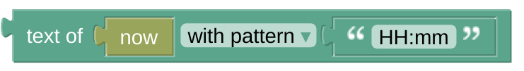

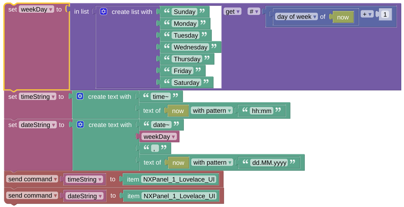

Hi
For the time updater what time and date formats are accepted? I looked at this document
Date/Time Conversions
The following date and time conversion suffix characters are defined for the 't' and 'T' conversions. The types are similar to but not completely identical to those defined by GNU date and POSIX strftime(3c). Additional conversion types are provided to access Java-specific functionality (e.g. 'L' for milliseconds within the second).
The following conversion characters are used for formatting times:
'H' Hour of the day for the 24-hour clock, formatted as two digits with a leading zero as necessary i.e. 00 - 23.
'I' Hour for the 12-hour clock, formatted as two digits with a leading zero as necessary, i.e. 01 - 12.
'k' Hour of the day for the 24-hour clock, i.e. 0 - 23.
'l' Hour for the 12-hour clock, i.e. 1 - 12.
'M' Minute within the hour formatted as two digits with a leading zero as necessary, i.e. 00 - 59.
'S' Seconds within the minute, formatted as two digits with a leading zero as necessary, i.e. 00 - 60 (“60” is a special value required to support leap seconds).
'L' Millisecond within the second formatted as three digits with leading zeros as necessary, i.e. 000 - 999.
'N' Nanosecond within the second, formatted as nine digits with leading zeros as necessary, i.e. 000000000 - 999999999.
'p' Locale-specific morning or afternoon marker in lower case, e.g.“am” or “pm”. Use of the conversion prefix 'T' forces this output to upper case.
'z' RFC 822 style numeric time zone offset from GMT, e.g. -0800. This value will be adjusted as necessary for Daylight Saving Time. For long, Long, and Date the time zone used is the default time zone for this instance of the Java virtual machine.
'Z' A string representing the abbreviation for the time zone. This value will be adjusted as necessary for Daylight Saving Time. For long, Long, and Date the time zone used is the default time zone for this instance of the Java virtual machine. The Formatter’s locale will supersede the locale of the argument (if any).
's' Seconds since the beginning of the epoch starting at 1 January 1970 00:00:00 UTC, i.e. Long.MIN_VALUE/1000 to Long.MAX_VALUE/1000.
'Q' Milliseconds since the beginning of the epoch starting at 1 January 1970 00:00:00 UTC, i.e. Long.MIN_VALUE to Long.MAX_VALUE.
The following conversion characters are used for formatting dates:
'B' Locale-specific full month name, e.g. "January", "February".
'b' Locale-specific abbreviated month name, e.g. "Jan", "Feb".
'h' Same as 'b'.
'A' Locale-specific full name of the day of the week, e.g. "Sunday", "Monday"
'a' Locale-specific short name of the day of the week, e.g. "Sun", "Mon"
'C' Four-digit year divided by 100, formatted as two digits with leading zero as necessary, i.e. 00 - 99
'Y' Year, formatted as at least four digits with leading zeros as necessary, e.g. 0092 equals 92 CE for the Gregorian calendar.
'y' Last two digits of the year, formatted with leading zeros as necessary, i.e. 00 - 99.
'j' Day of year, formatted as three digits with leading zeros as necessary, e.g. 001 - 366 for the Gregorian calendar.
'm' Month, formatted as two digits with leading zeros as necessary, i.e. 01 - 13.
'd' Day of month, formatted as two digits with leading zeros as necessary, i.e. 01 - 31
'e' Day of month, formatted as two digits, i.e. 1 - 31.
I tried something like ll:mm to show the time as a 12 hour clock and it gives an error
2024-01-16 21:59:00.203 [ERROR] [b.automation.script.javascript.stack] - Failed to execute script:
org.graalvm.polyglot.PolyglotException: p: Unknown pattern letter: l
Are the default formats the only options?
Thank you
Hi clark,
Surely not, but honestly I don’t know a list of possible options. I’m just re-using the formatter which is used in blockly anyway…
which gets converted to
(time.ZonedDateTime.now()).format(time.DateTimeFormatter.ofPattern('HH:mm'));
most likely using all the options from DateTimeFormatter (Java Platform SE 8 )
Regarding your special case, the required format string will be “hh:mm a”, but the ‘a’ (for AM/PM) will give an error (no idea how to fix that):
Pattern using (localized) text not implemented, use @js-joda/locale plugin!
Personally I did not found any way to get the Day of the Week as a name included, therefore I created the required strings manually like this:
Maybe you can do the same for yourself to add AM/PM?
Hope this helps somehow, best regards,
Rene
