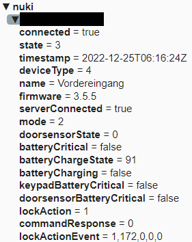

I’ve got the update 3.5.11 and connected the lock to my Mosquitto server. I’m getting updates from the lock, such as Lock state, name, battery.
But I can’t send commands. I tried it via a MQTT client and i’m succesfully locking and unlocking the door. But Openhab doesn’t lock or unlock the door.
Thing mqtt:topic:nuki:voordeur  "Voordeur"
     (mqtt:broker:nuki) @ "Huis"
    Channels:
        Type string     : state         "Slot Status"               [ stateTopic = "nuki/********/state"]
        Type number     : lockAction    "Slot commando"             [ stateTopic = "nuki/******/lockAction"]
        Type string     : name          "Slot naam"                 [ stateTopic = "nuki/******/name"]
Number      VoordeurCommand                     "Commando"                                              { channel="mqtt:topic:nuki:voordeur:lockAction" }
Does anyone know what i’m doing wrong? I tried also string but the lock just doesn’t react.
You need a command topic, not a state topic to send commands.
The item type needs to be a String itemtype.
On your sitemap you may use something like this for your String item:
Selection item=Nuki_LockAction  mappings=["1"="unlock","2"="lock","3"="open"]
Thanks a lot! I did not know that. I didn’t use mqtt before for sending commands.
