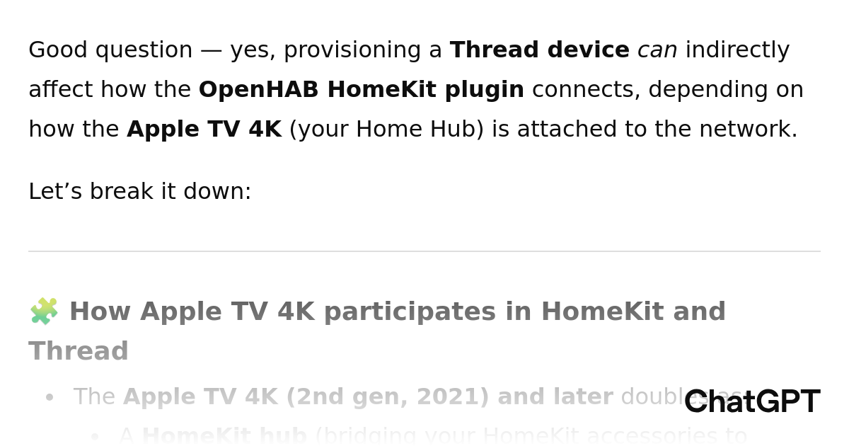

Provisioning a Thread device on the Apple TV breaking your OH HomeKit config seems odd to me. Provisioning a Thread device on the Apple TV technically has nothing to do with either HomeKit or Thread. Thread is a transport that Matter runs on top of. How the provisioning of a Thread device on the Apple TV, which you are required to do here, would effect your existing OH HomeKit config would require some inspection of the HomeKit binding debug logs
TL:DR
Use Ethernet from your home router to your Apple TV for fewer POTENTIAL HomeKit issues with Thread.
If you notice intermittent HomeKit “bridge not responding” issues after adding Thread devices, restart both the Apple TV and OpenHAB — it re-announces mDNS and re-establishes the HomeKit session.

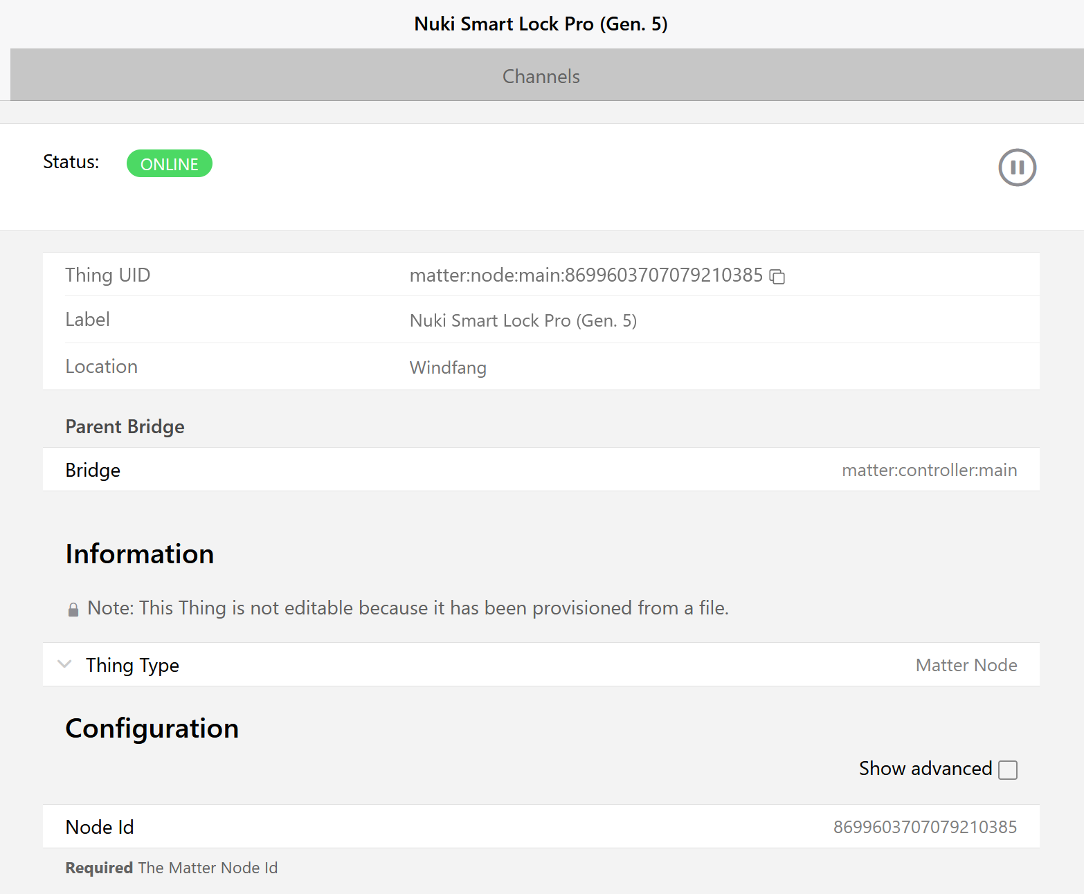

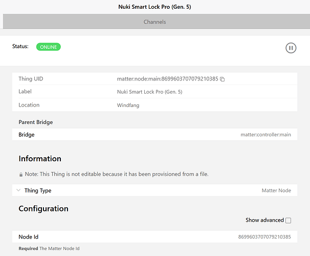

After that there’s a device in inbox, select and “Copy Thing File Definition”. Create a file /etc/openhab/things/matter.thingsto paste into:
Thing matter:node:main:8699603707079210385 "Nuki Smart Lock Pro (Gen. 5)" (matter:controller:main) @ "Windfang" [nodeId="8699603707079210385"]
The thing gets online:
But doesn’t show any channels … :thinking: … so, no items to create from here …

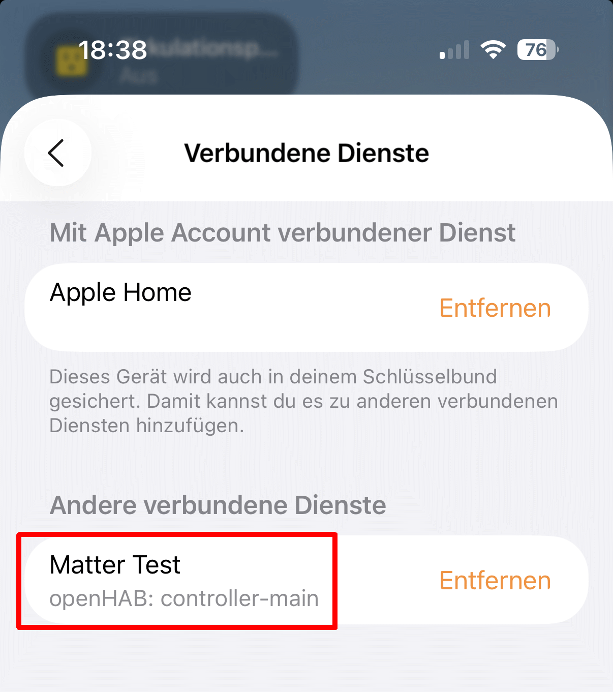

Another finding is how openHAB shows up in Apple Home:
“Matter Test” … ?

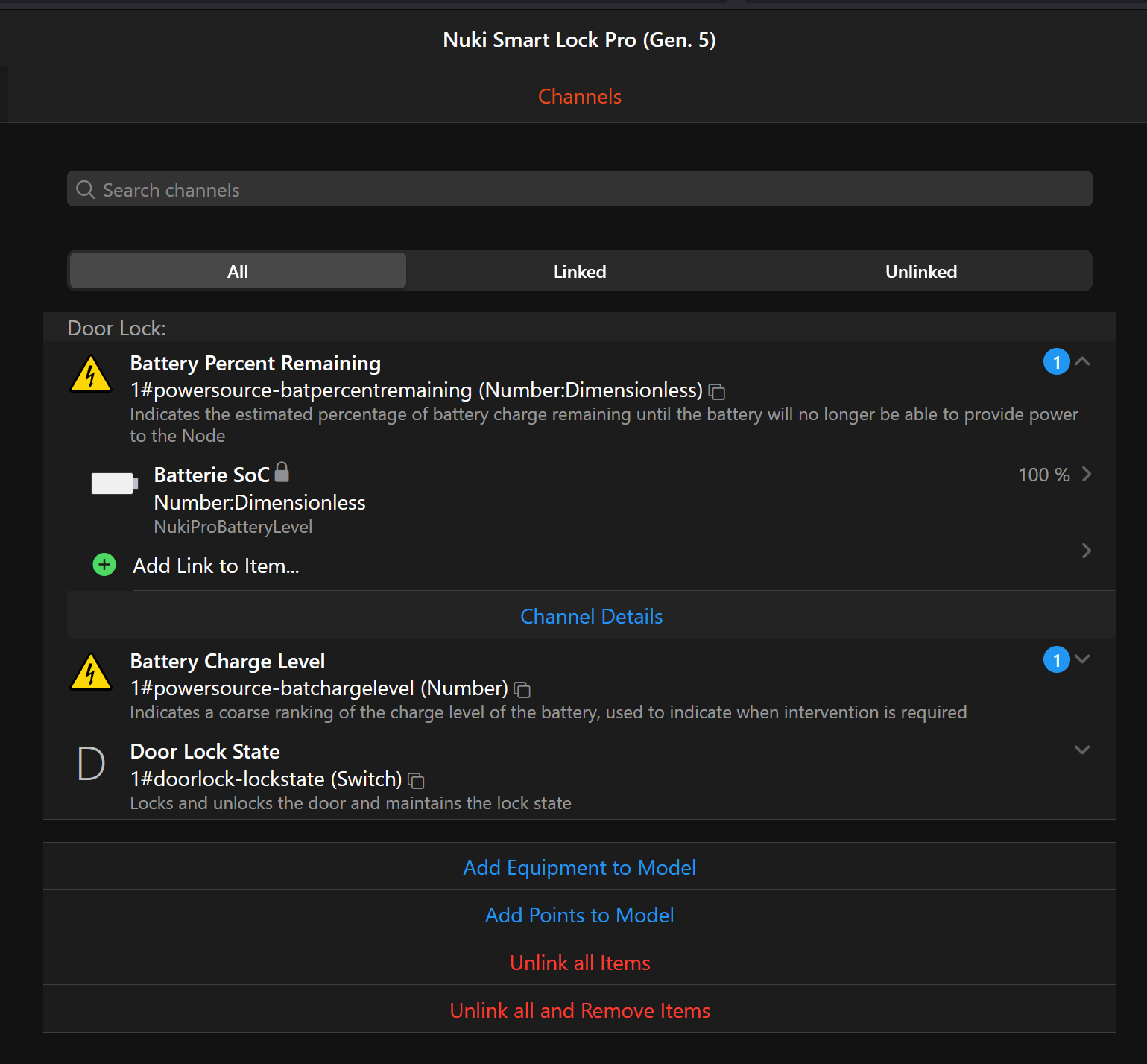

Ok, played a little forth and back, disabled things files and “matter” from addon.cfg … added stuff thru gui, eradicated that and enabled everything from files again. Then I could see channels all over sudden … maybe I have been too impatient …
So, I know now how to get native Thread devices from Apple Home into openHAB.

in order to get a cert, the developer or company needs to submit to the Matter standards body for certification ($$$)
So OH is using a Test certificate

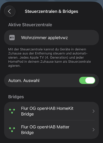

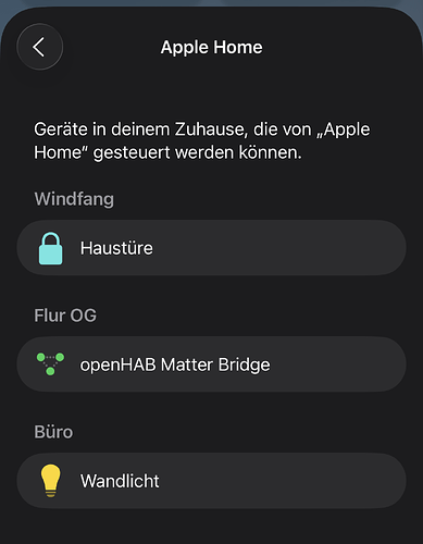

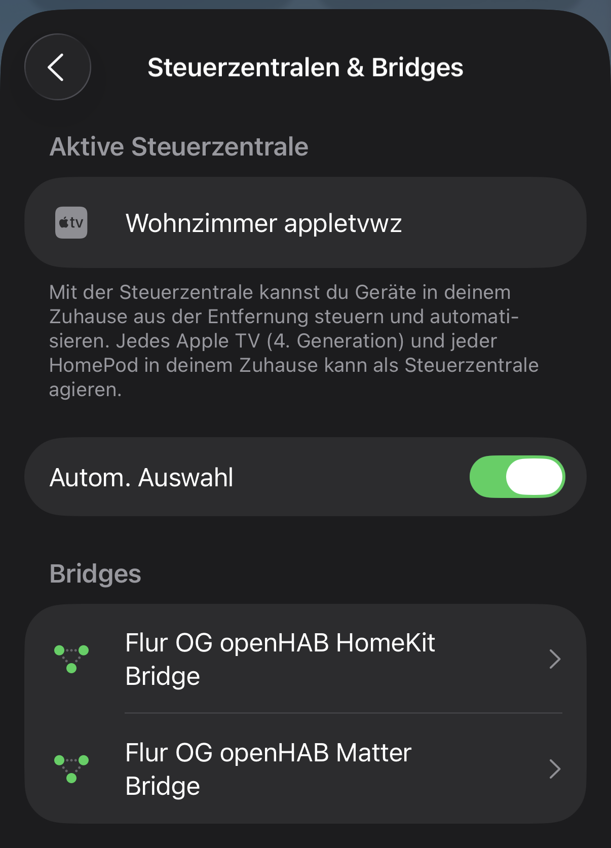

Used one item of a dual channel EnOcean actuator to modify integration meta data from homekit=“Lighting” to matter=“OnOffLight”. Matter Bridge came up properly directly, showing QR code, manual key etc.
So, one channel is mapped with Homekit, the other channel of same actuator mapped thru Matter :face_savoring_food:
Just binding with Apple Home worked after another OH restart:
