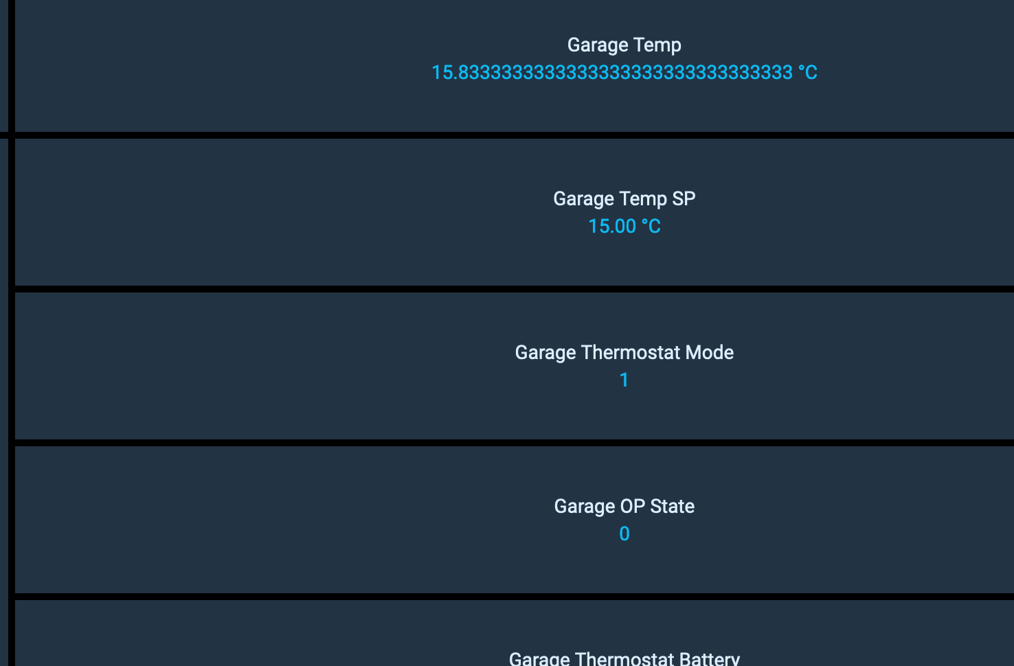

I am using this to format an item from a thermostat:
Number:Temperature Garage_Temperature “Garage Temperature [%.1f °C]”
It displays a °C number with many decimal places, not the one decimal place I asked for.
I have tried this:
Number Garage_Temperature “Garage Temperature [%.1f °C]”
This will display one decimal place however it doesn’t covert the value from °F to °C.
Any ideas on how to fix this?

In HABPanel:

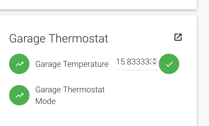

Also in Control in Paper UI

kjwiebe
(Kevin Wiebe)
5
Perfect thanks!
One question though. So does the formatting in the items file not do anything? What would it be for, i.e. why format in the item definition at all?
