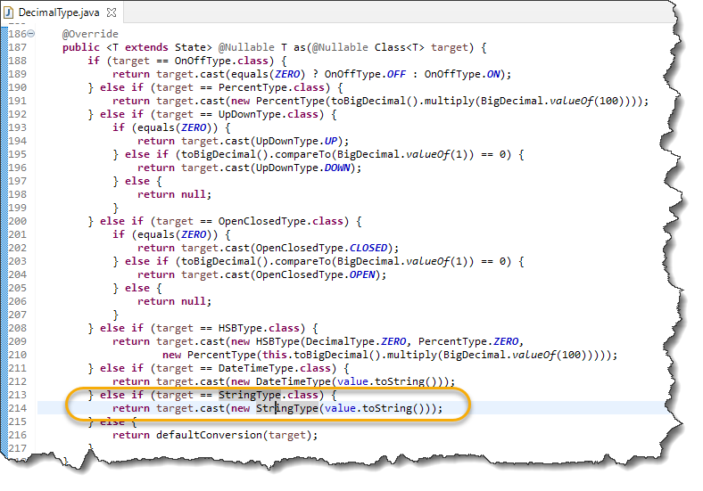

Indeed. Looking at the binding code reveals that it returns a DecimalType instance. So the cast to a DateTime is indeed in the framework rather than the binding…
… so, looking at the StringItem code reveals that StringItem can accept UnDefType, StringType, or DateTimeType values..
    private static final List<Class<? extends State>> ACCEPTED_DATA_TYPES = List.of(UnDefType.class, StringType.class,
            DateTimeType.class);
… so, looking at DecimalType.as() reveals that there is a specific if () case to convert Value → DateTime, but there is no specific if () case to convert Value → String (the StringType case falls through to defaultConversion())..

So to summarise, there are two possible reasons why the DecimalType → StringType conversion produces a DateTime string..
  1. Either the accepted types iterator hits DateTimeType before it hits StringType, or
  2. On StringType, the defaultConversion() method returns null; which means the accepted types iterator passes over StringType and then hits DateTimeType.
I am not entirely sure if 1. or 2. applies, as it may depend on code optimisation (sometimes iterators are optimised to count down rather than up the list).
But in any case it seems to me that the framework should probably add some specific code to handle DecimalType → StringType conversions…
EDIT: I traced back into the defaultConversion() and can confirm that it only handles DecimalType → DecimalType, and otherwise returns null. QED: it’s a bug!
