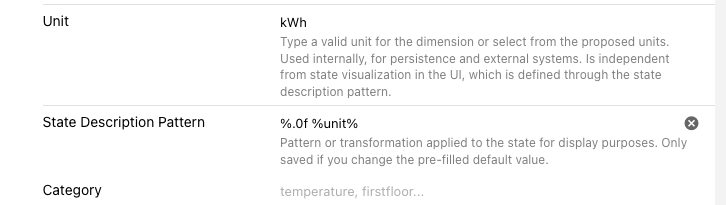

In both cases I see a value with ONE digit after dot (in MQTT Explorer) like 300.6
But in MainUI I “just” see 300 W
Adding a formatBeforePublish to the Thing does not change anything
Adding a State Description to the Item (Model) with “%.1f” will show me 300.6 but will hide the Unit at the same time.
What do I have to manipulate? Item or the Thing?
How do the two Metadata “unit” and “state description” work together?
What about
%.1f %unit%
Found the solution during creationg a new Item :wink:
So default is the given
%.0f %unit%
